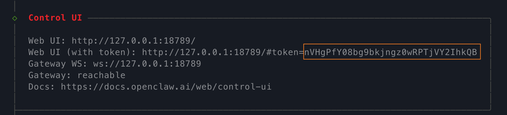

(You can install skills later)Enable hooks Select all How do you want to hatch your bot Do this later After you complete the onboarding wizard, scroll up to the Control UI section.
Find the Web UI (with token), and then copy the token at the end of the URL (the text immediately following
#token=). This is your Gateway Token.

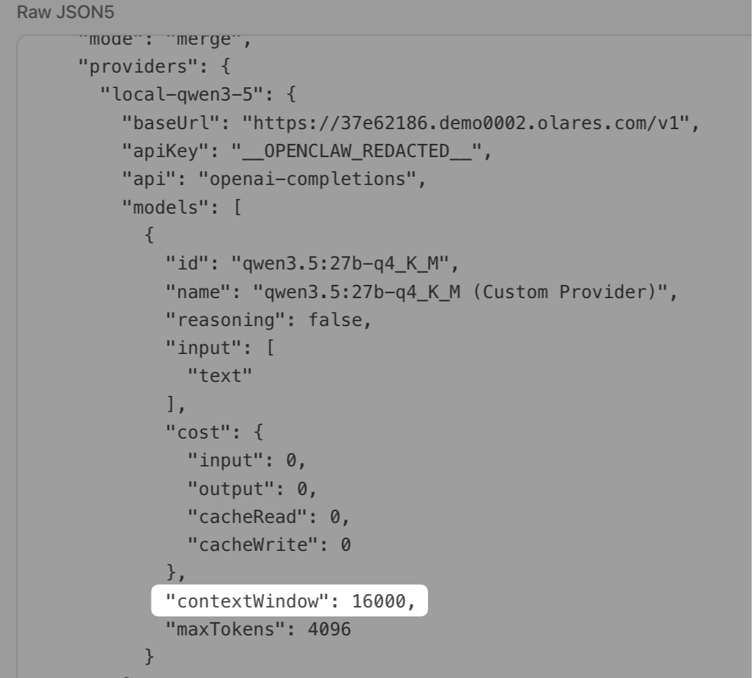

Step 4: Configure context window
OpenClaw requires a large "context window" (that is the AI's short-term memory) to handle complex tasks without forgetting your previous instructions.
In the Control UI, select Config from the left sidebar, and then switch to the Raw tab.
Find the
modelssection and locate the configuration block for your model.Add or update the
contextWindowvalue. Set it to at least 64000 (64K). If your hardware VRAM permits, it is highly recommended to increase it to 200000 (200K).
Click Save in the upper-right corner. The system validates the configuration and restarts automatically.

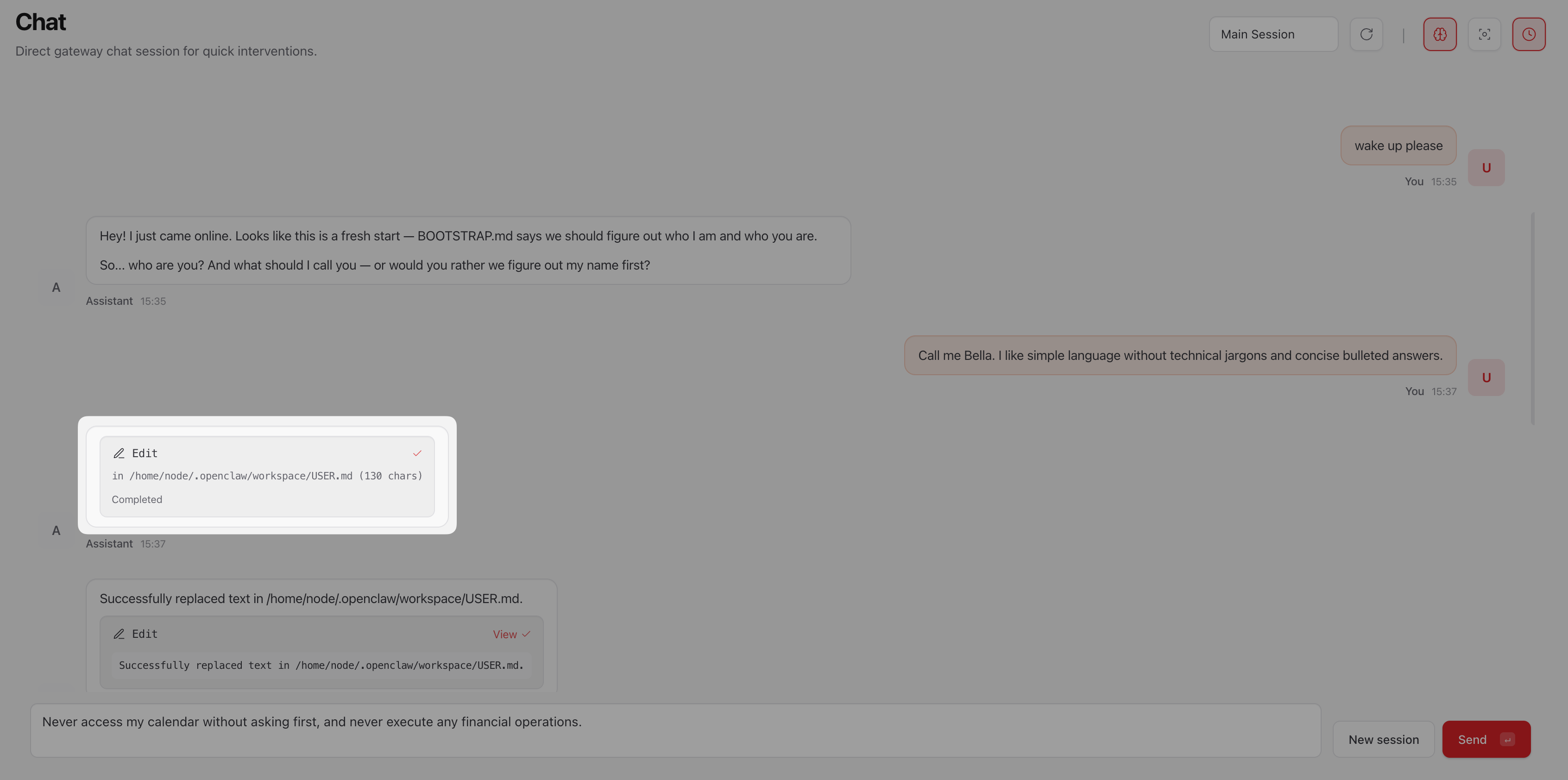

In the Control UI, select Chat from the left sidebar.
Ensure neurology at the upper-right corner is enabled. This allows you to watch the agent think and edit persona files in real time.
Enter and send the following message to start:
textWake up please!The agent responds and starts interviewing you. You can establish rules, personality traits, and preferences. For example,
text- Call me Bella. I like simple language without technical jargon and concise bulleted answers. - You are John, a witty assistant who uses emojis. - Never access my calendar without asking first, and never execute any financial operations.As you chat with the agent, look for the Edit messages. These indicate the agent is successfully writing your preferences to its core persona files, such as
IDENTITY.md,USER.md, andSOUL.md.
If you do not see the intermediate persona file operations, refresh the page by clicking refresh at the upper-right corner or by pressing F5.

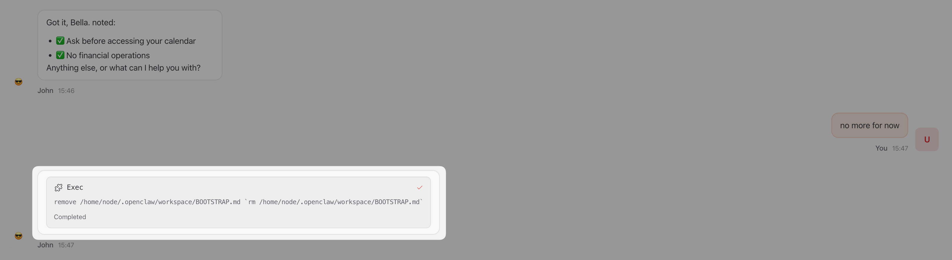

Continue the conversation until the agent gathers enough information. Then, it automatically deletes the temporary
BOOTSTRAP.mdfile to finish the personalization process.
(Optional) If the agent fails to update the persona files or delete
BOOTSTRAP.md, explicitly instruct it to do so in the chat.If the issue persists, resolve it using one of the following methods:
Increase the context window: Select Config from the left sidebar, switch to the Raw tab, find the
modelssection, and then increase thecontextWindowvalue to at least 64K (200K is recommended).TIP
Note that a larger context window consumes more VRAM, so choose a value that your hardware can support.

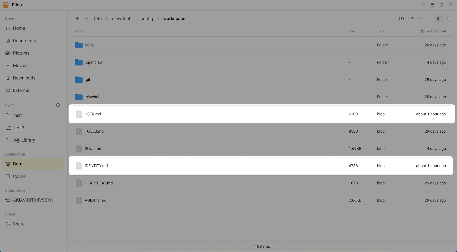

Verify your agent's persona files are updated:
a. Open Files from the Launchpad.
b. Go to Application > Data > clawdbot > config > workspace.
c. Check the modified time of the
.mdfiles to identify which ones were recently updated, such asUSER.mdandIDENTITY.md.
d. (Optional) Double-click a file to verify that it contains your newly established rules such as name, language style, and restrictions.
