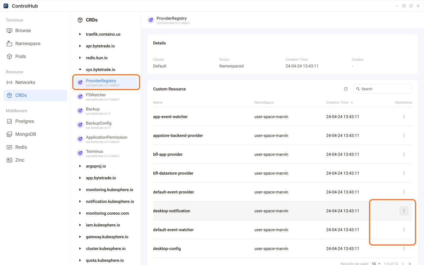

If you need to connect the provider of the original system application to your development environment, you can manually change the address of the ProviderRegistry. In the 'CRDs' page of the control hub, locate sys.bytetrade.io and then find the ProviderRegistry.

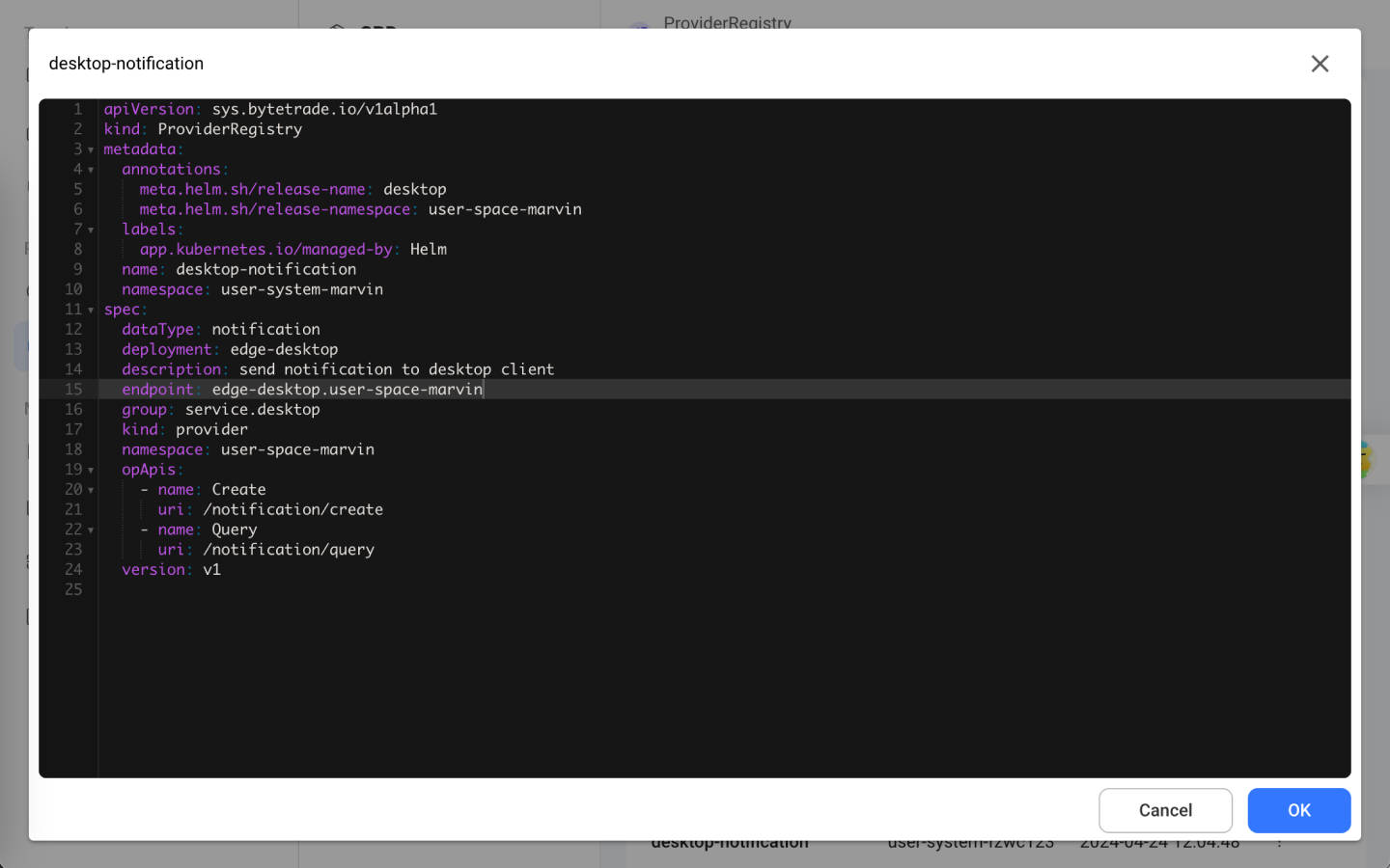

In the list, navigate to the app you wish to replace (in this case, desktop-notification). Click on the '...' button on the right and select 'Edit YAML'. Modify the endpoint in the YAML file and direct it towards the service address of your developing app. Click 'OK' to save and apply the changes.
