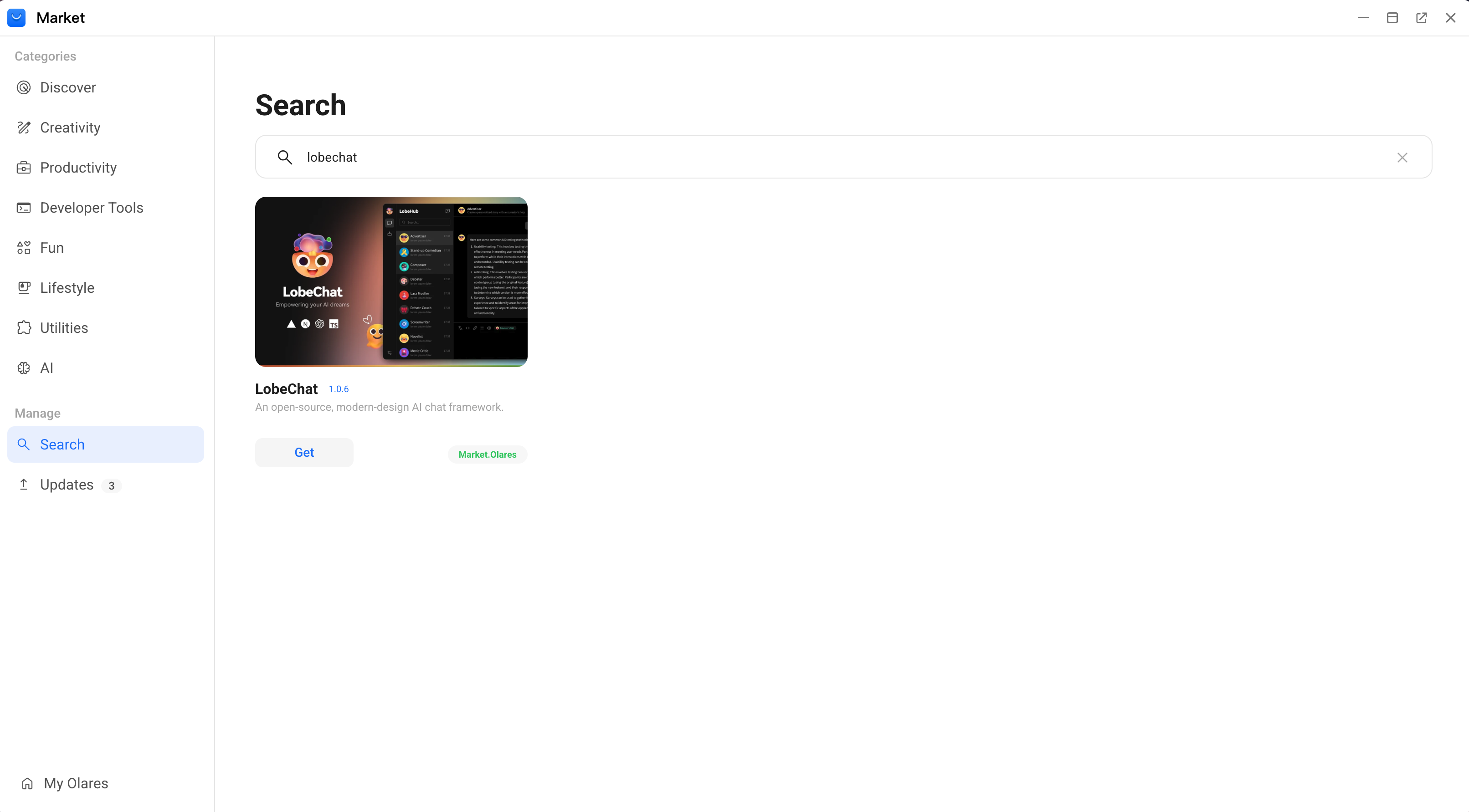

Install LobeChat
  1. From the Olares Market, search for "LobeChat".
    Search for LobeChat from Market

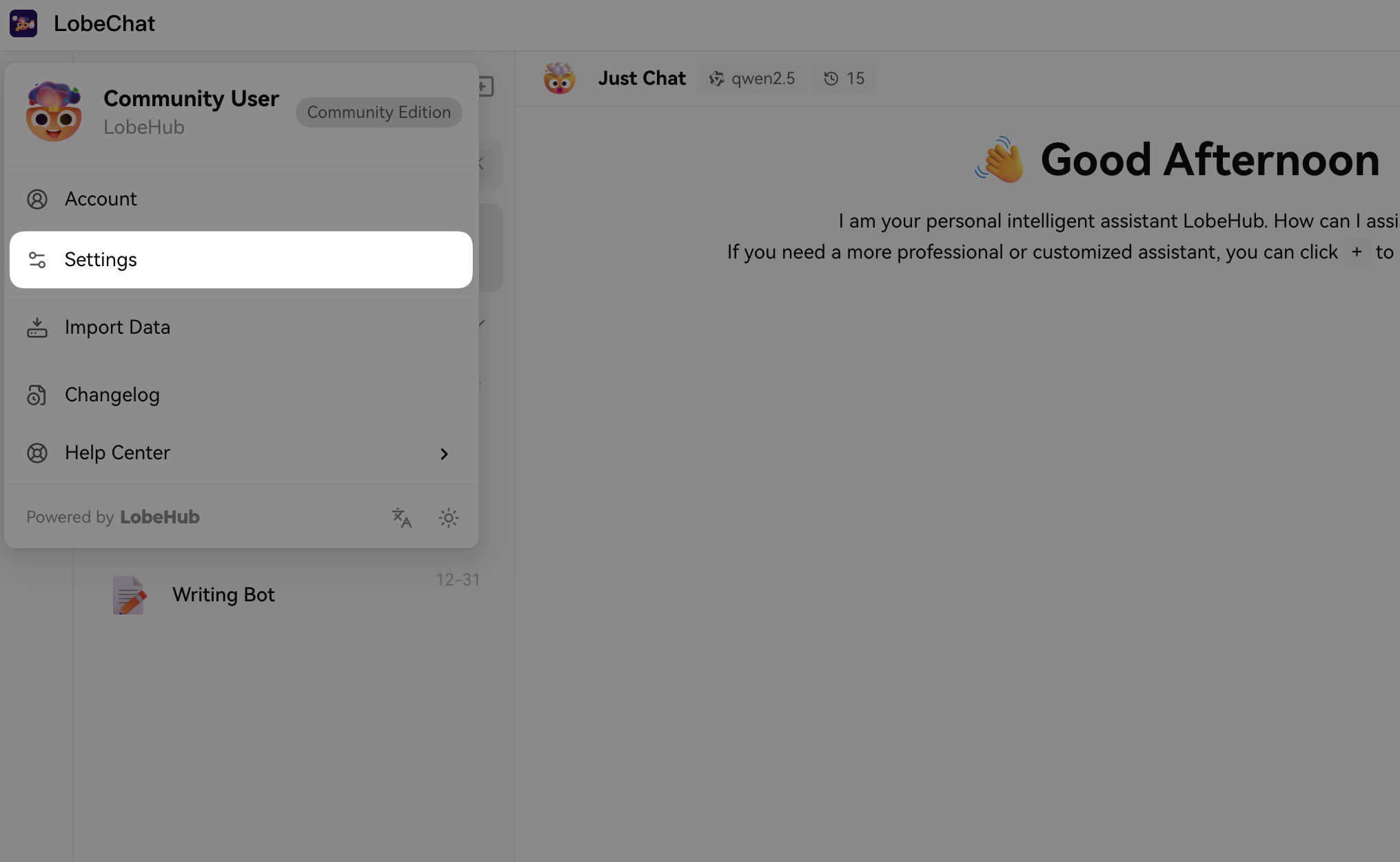

  1. Open LobeChat from Launchpad.
  2. Click the LobeChat icon in the upper-left corner, and then go to Settings > Language Model.

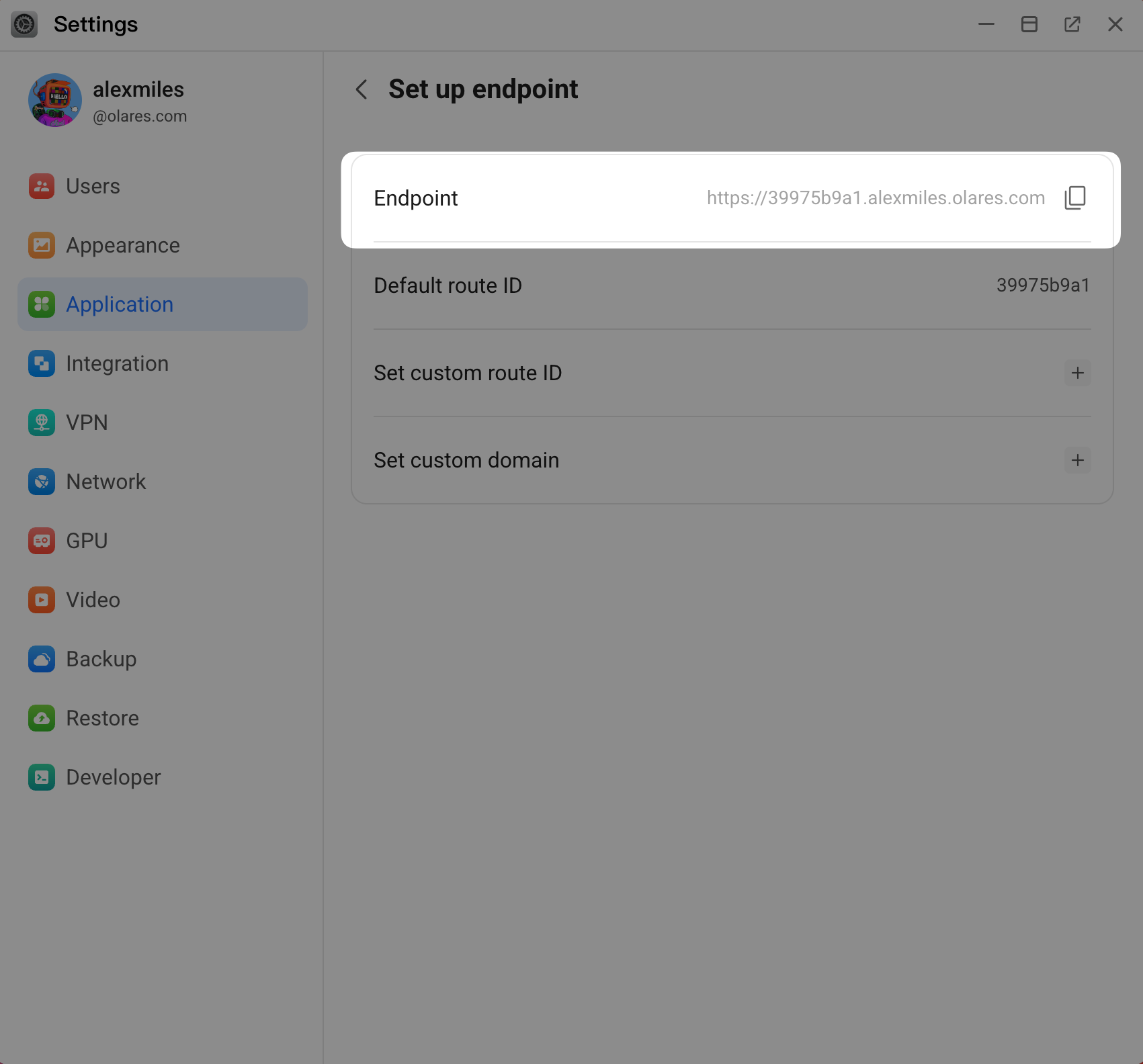

  3. (Optional) To obtain your local Ollama host address, go to Olares Settings > Application > Ollama > Ollama API > Set up endpoint, and then copy the endpoint address.
    Obtain Ollama host address from Olares Settings

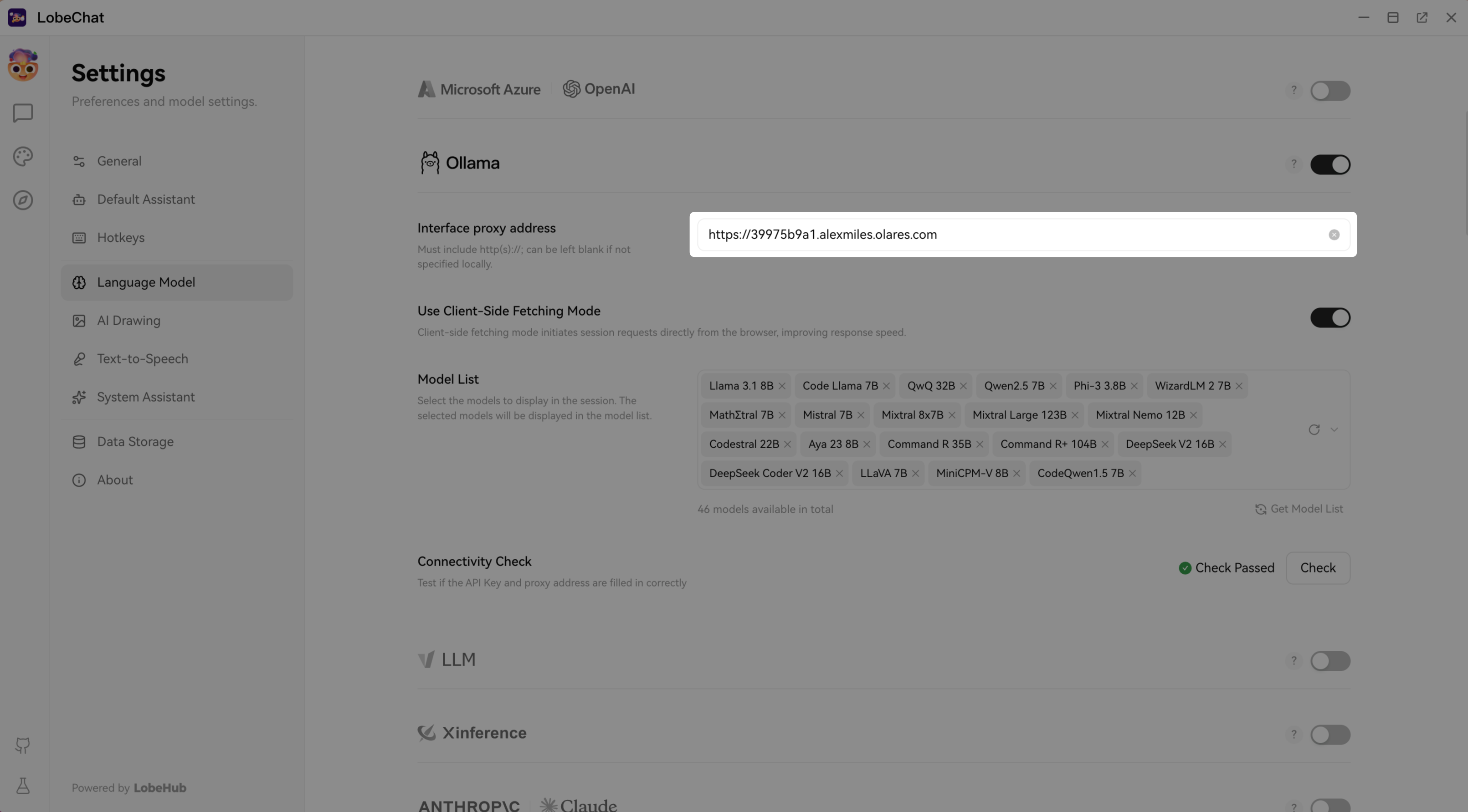

  4. In the Ollama section, find the Interface proxy address field, and then enter your local Ollama address.
    Interface proxy address connection

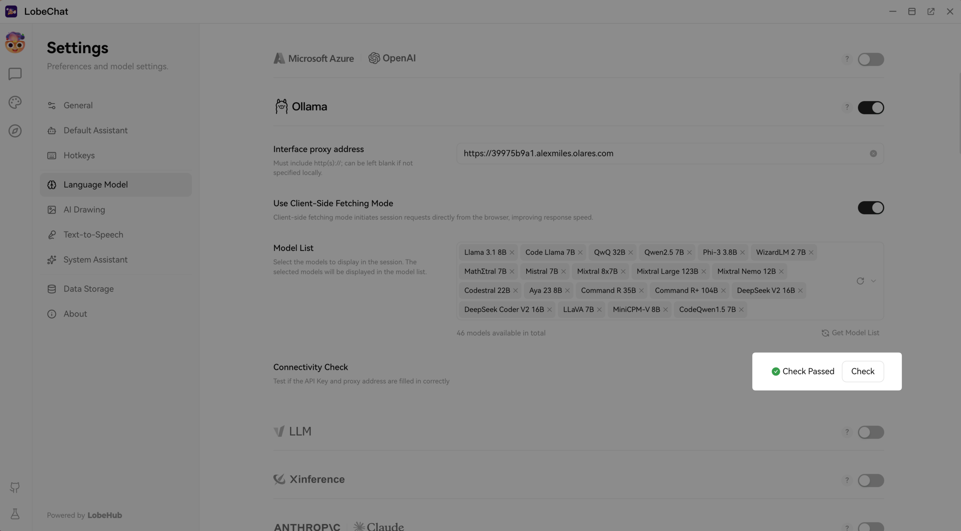

  5. Click Check under the Ollama model list to verify the connection. A Check Passed message indicates that the proxy address is correct.
    Ollama connection successful

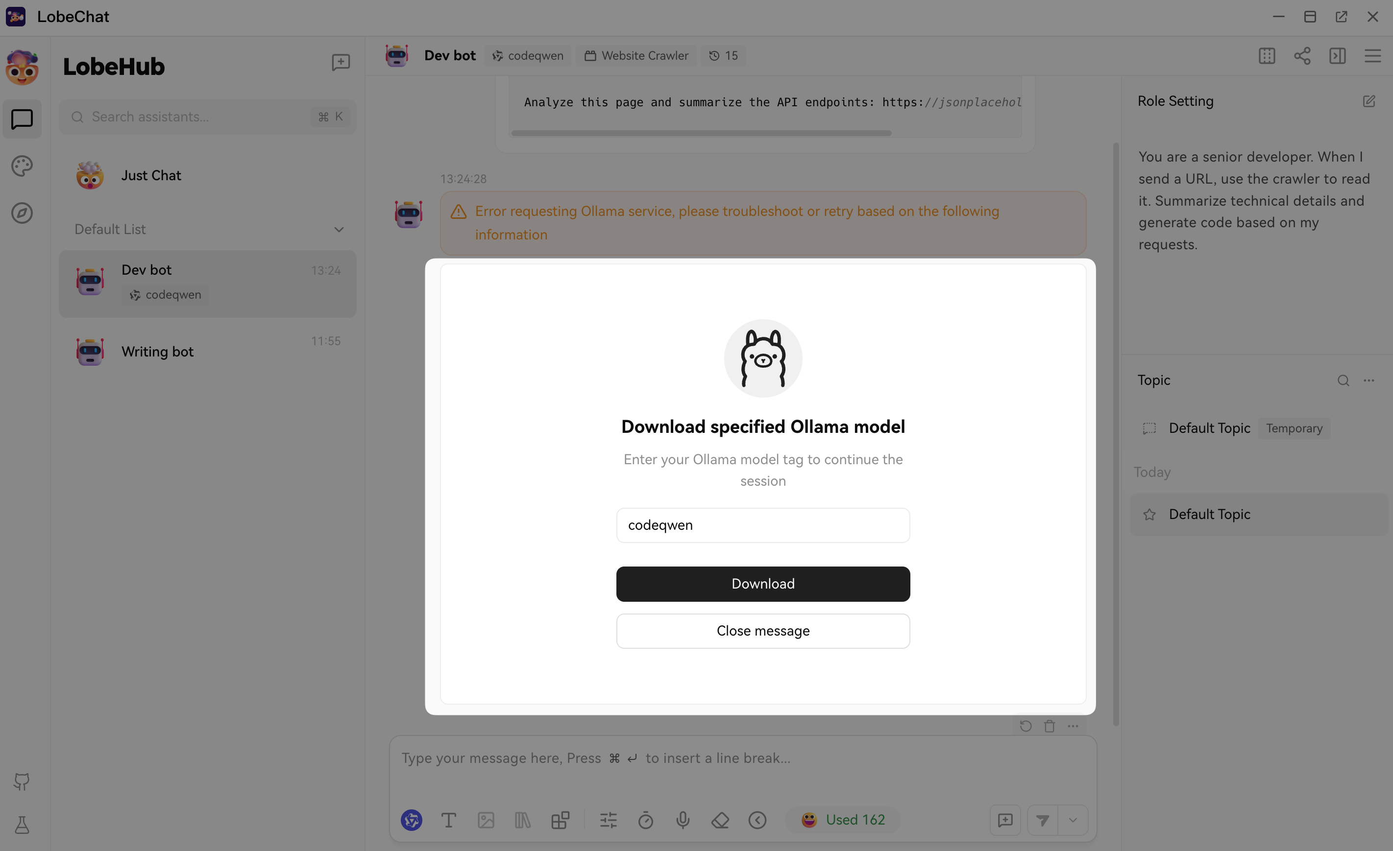

  • Download via LobeChat UI
    When you are chatting with a selected language model, if the language model is not installed, you are prompted right in the chat to download and install it.
    Install language model via LobeChat UI

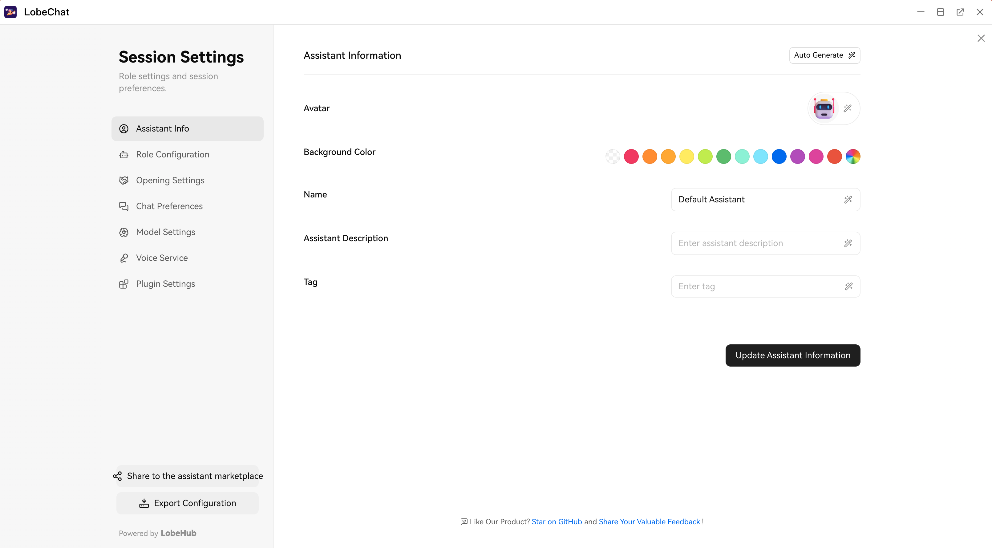

  2. Configure the assistant such as identity and role:
    a. Click Open Chat Settings.
    Open Chat Settings
    b. On the Assistant Info tab, set the avatar, name, and description, and then click Update Assistant Information.
    LobeChat session settings
    c. On the Role Configuration tab, enter your prompt for this specific role to define its behavior, and then click OK.
    d. Close the Session Settings page to return to the chat window.

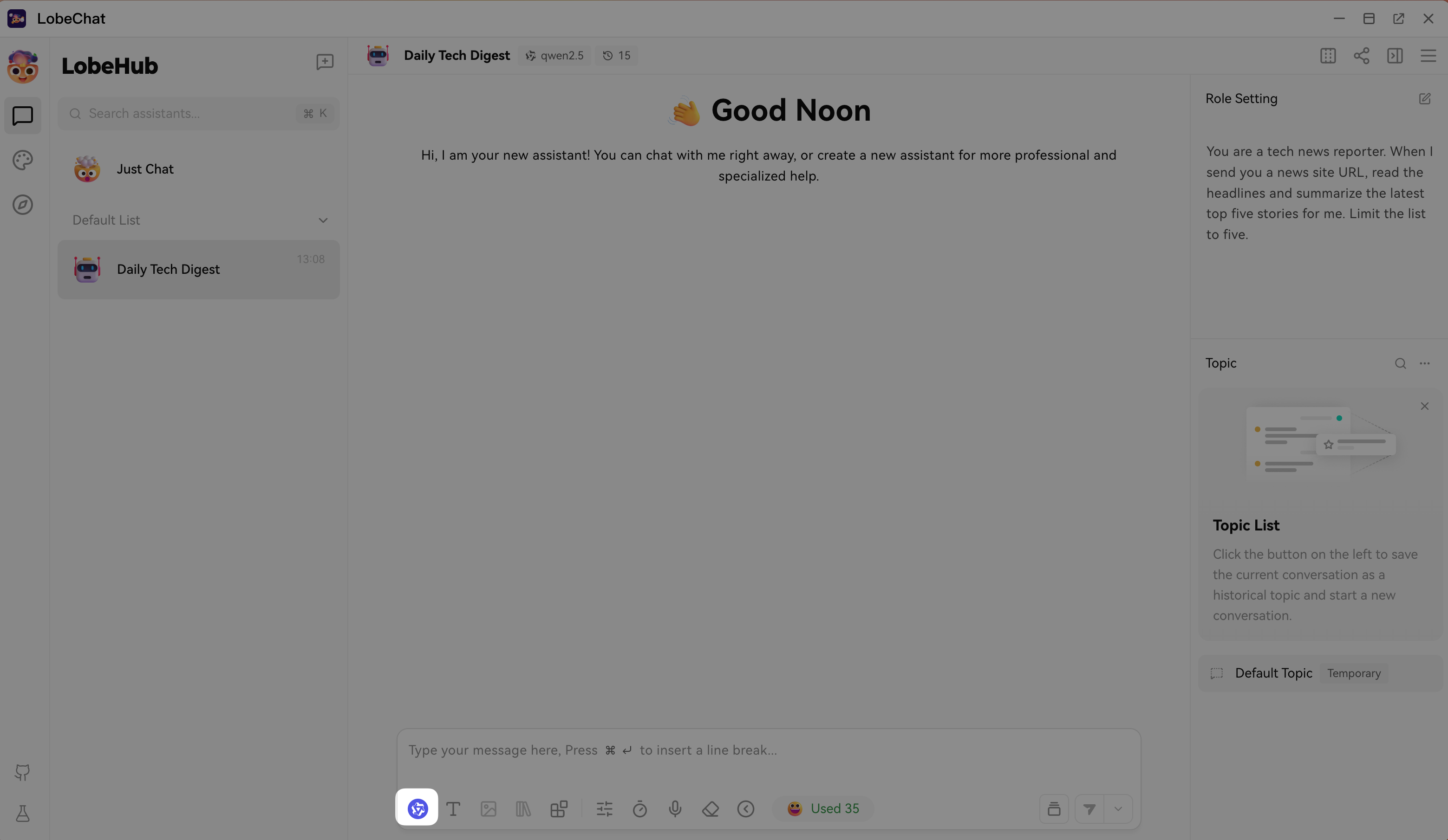

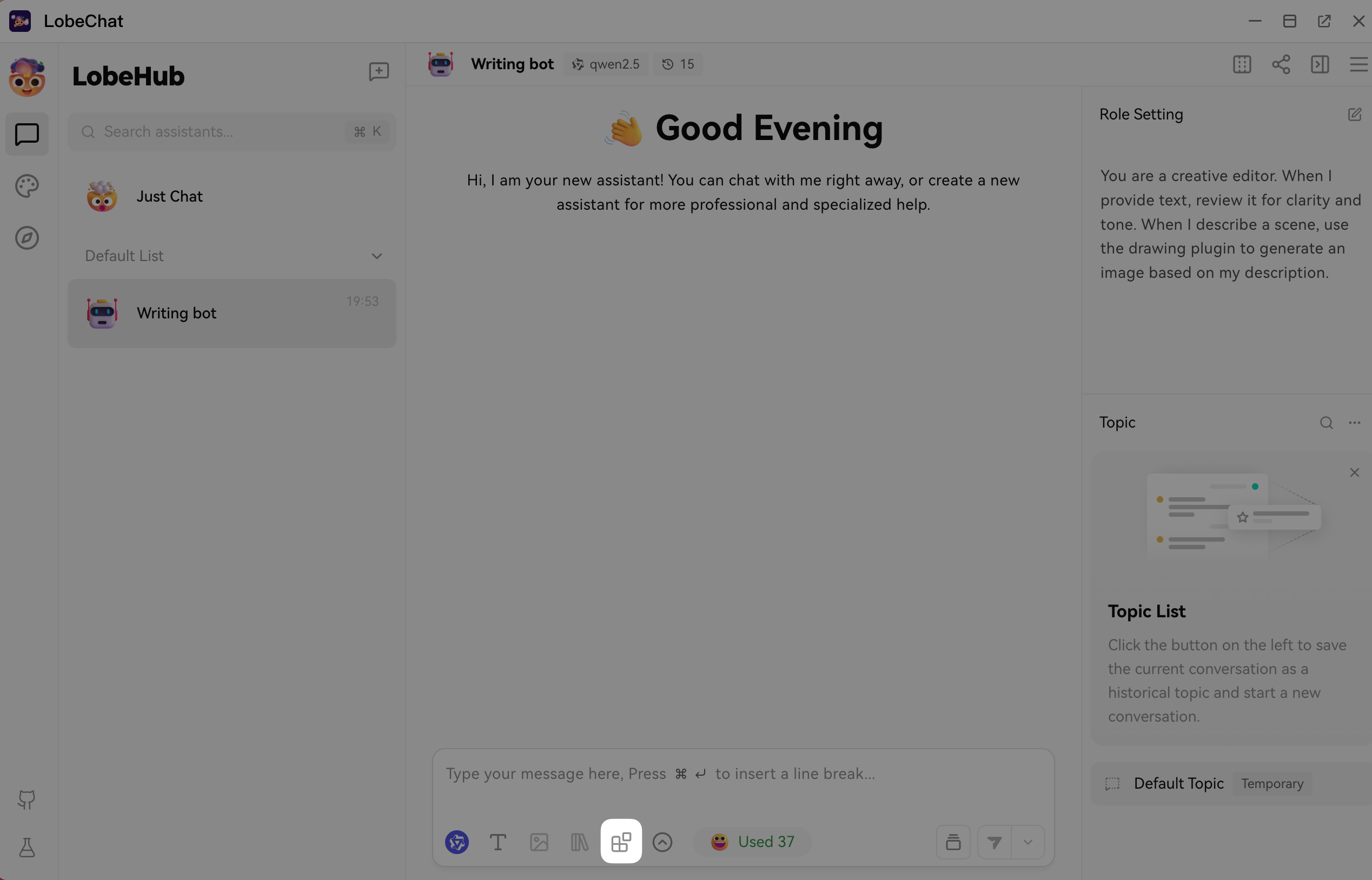

  3. Select the language model from the basic interaction area.
    Select language model

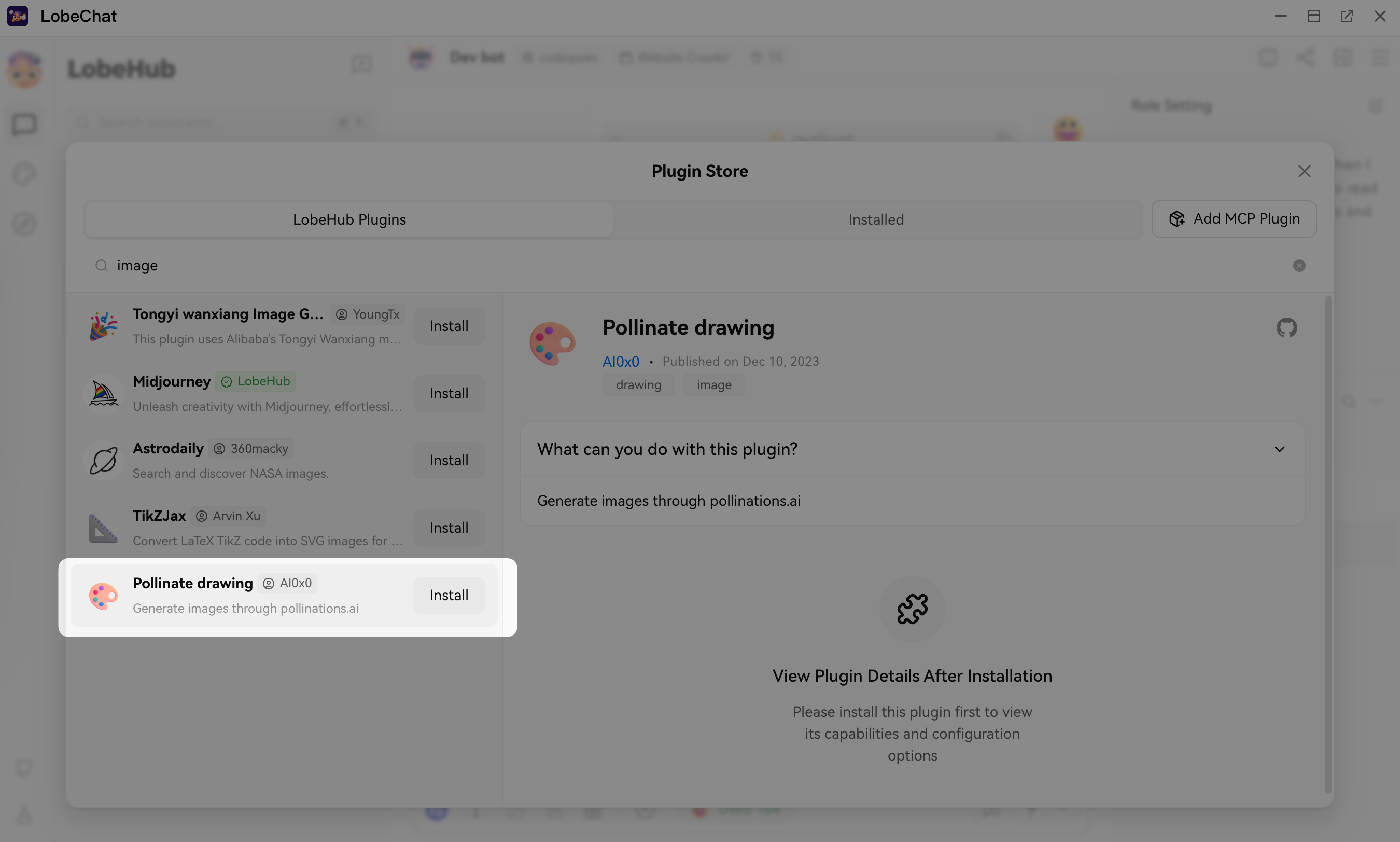

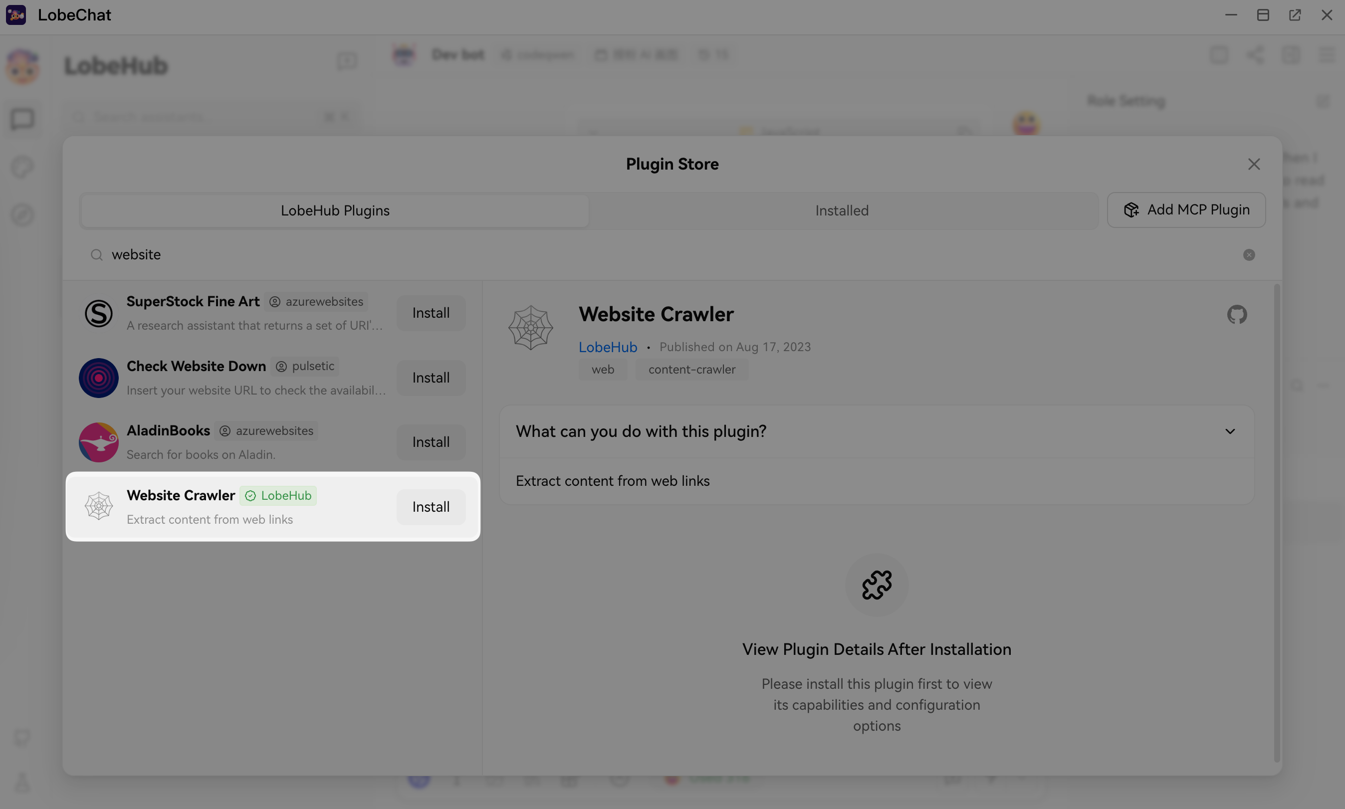

  4. (Optional) Install LobeChat plug-ins to enhance the assistant's capabilities:
    a. In the basic interaction area, hover over the plug-in icon and click Plugin Store.
    b. On the LobeHub Plugins tab, search for the target plug-in, and then click Install.
  5. Interact with the assistant.

  • LobeChat plug-in: "Pollinate drawing", which is used to create images based on description
    Install LobeChat plug-in Pollinate Drawing

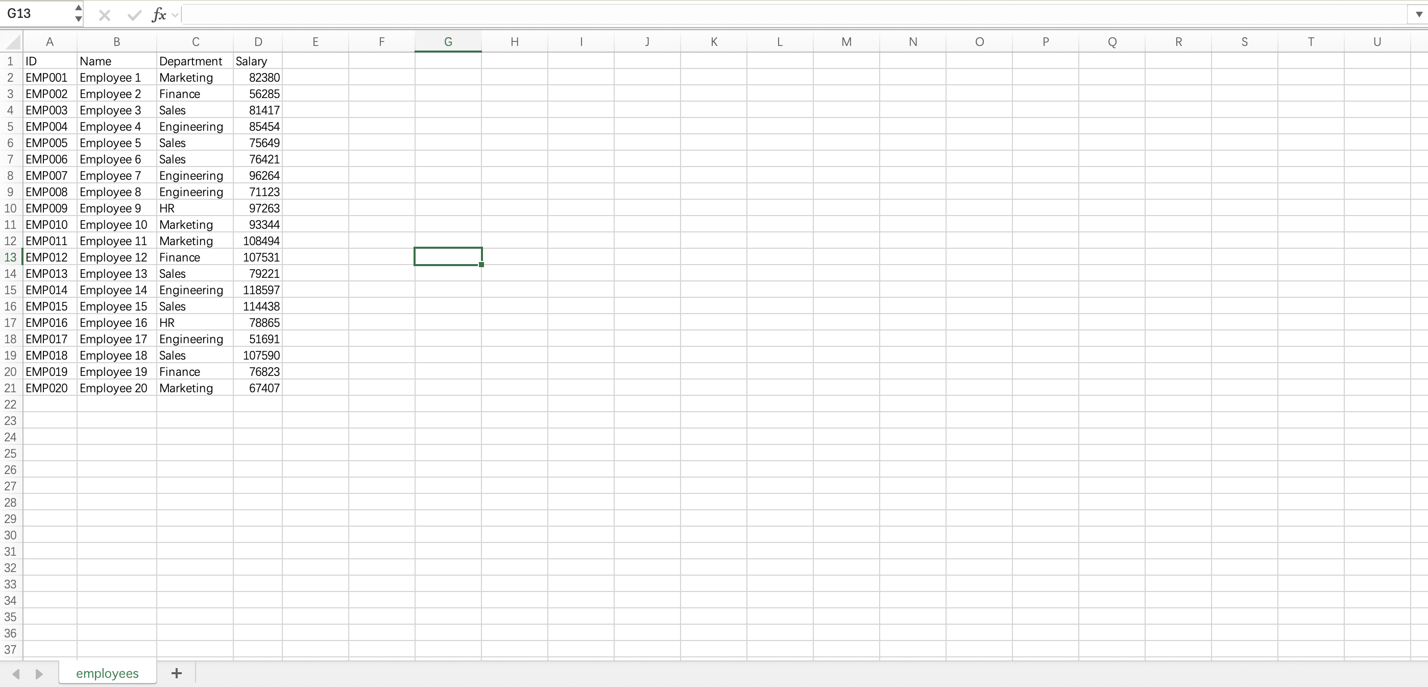

  3. Run the generated code to verify.
    a. Copy the generated Python code block and save it as generate_data.py.
    b. Open the Terminal, navigate to the folder, and run the following command:
    python
    python3 generate_data.py
    c. Check your current folder. You should see a new file named employees.csv. Open it to verify the generated mock data.
    Dev bot result verification

  • LobeChat plug-in: "Website Crawler", which is used to access live web pages and analyze real-time content from provided URLs
    How Website Crawler works (Real-time vs. Offline)
    Standard local AI models are offline and rely on pre-trained data from the past. The Website Crawler plug-in, specifically the getWebsiteContent function, acts as a bridge to the live internet.
    When you provide a URL, the plug-in instantly accesses the web page in real time via an API, fetches the current content, and feeds it to the AI. This ensures that the AI model is accessing the latest live web content rather than using the old memory.
    Install LobeChat plug-in Website Crawler

  1. In the basic interaction area, hover over the plug-in icon to ensure that the Website Crawler plug-in is enabled.
  2. Send the URL address to the chat. For example, https://github.com/trending.
  3. Paste and send the URL to the chat. The assistant lists specific news stories with summaries.
