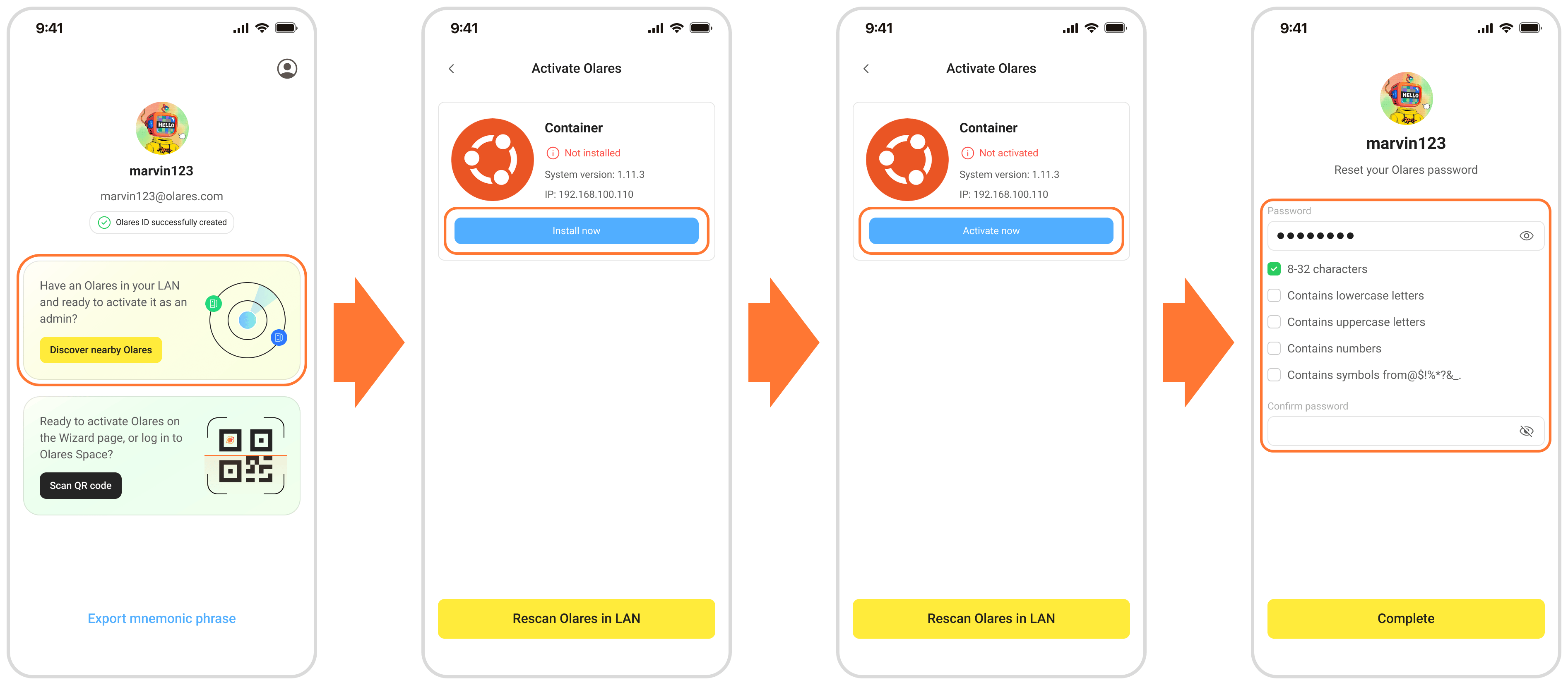

Install and activate Olares
Same network required
  1. Open LarePass, on your account activation page, tap Discover nearby Olares. LarePass will list the detected Olares instances in the same network.
  2. Select the target Olares device from the list and tap Install now.
  3. When the installation completes, tap Activate now. Olares will enter the activation process, including initial configuration and network setup.
  4. Follow the on-screen instructions to reset the login password for Olares, then tap Complete.

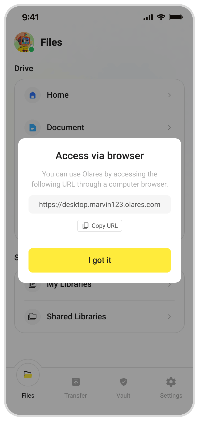

Access Olares via browser
Log in to Olares
  1. Enter the Olares desktop address in your browser, and press any key to continue.
    Log in
  3. You will be prompted to complete the two-factor verification. You can confirm login on LarePass, or manually enter the 6-digit verification code.
