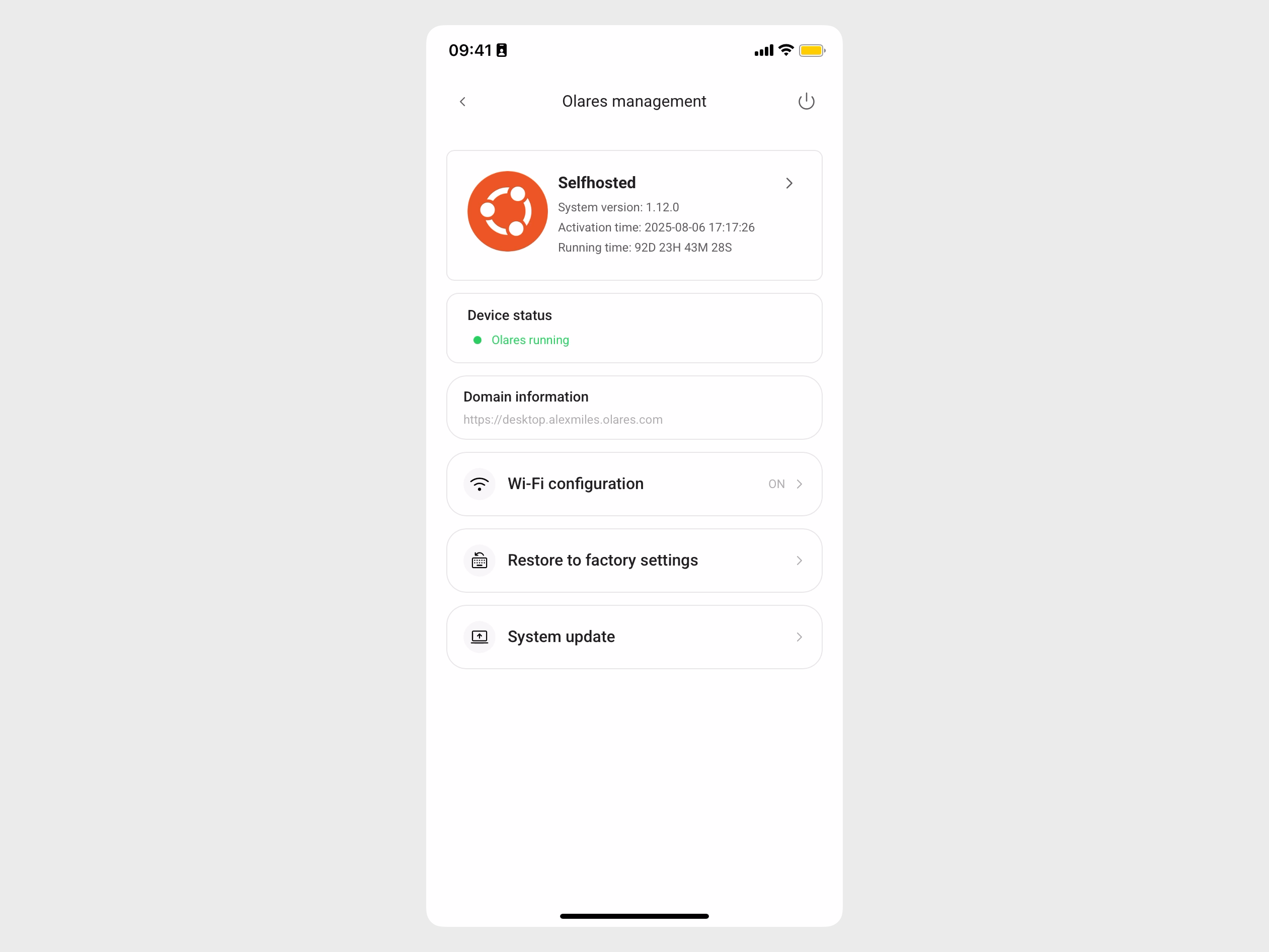

Access Olares management

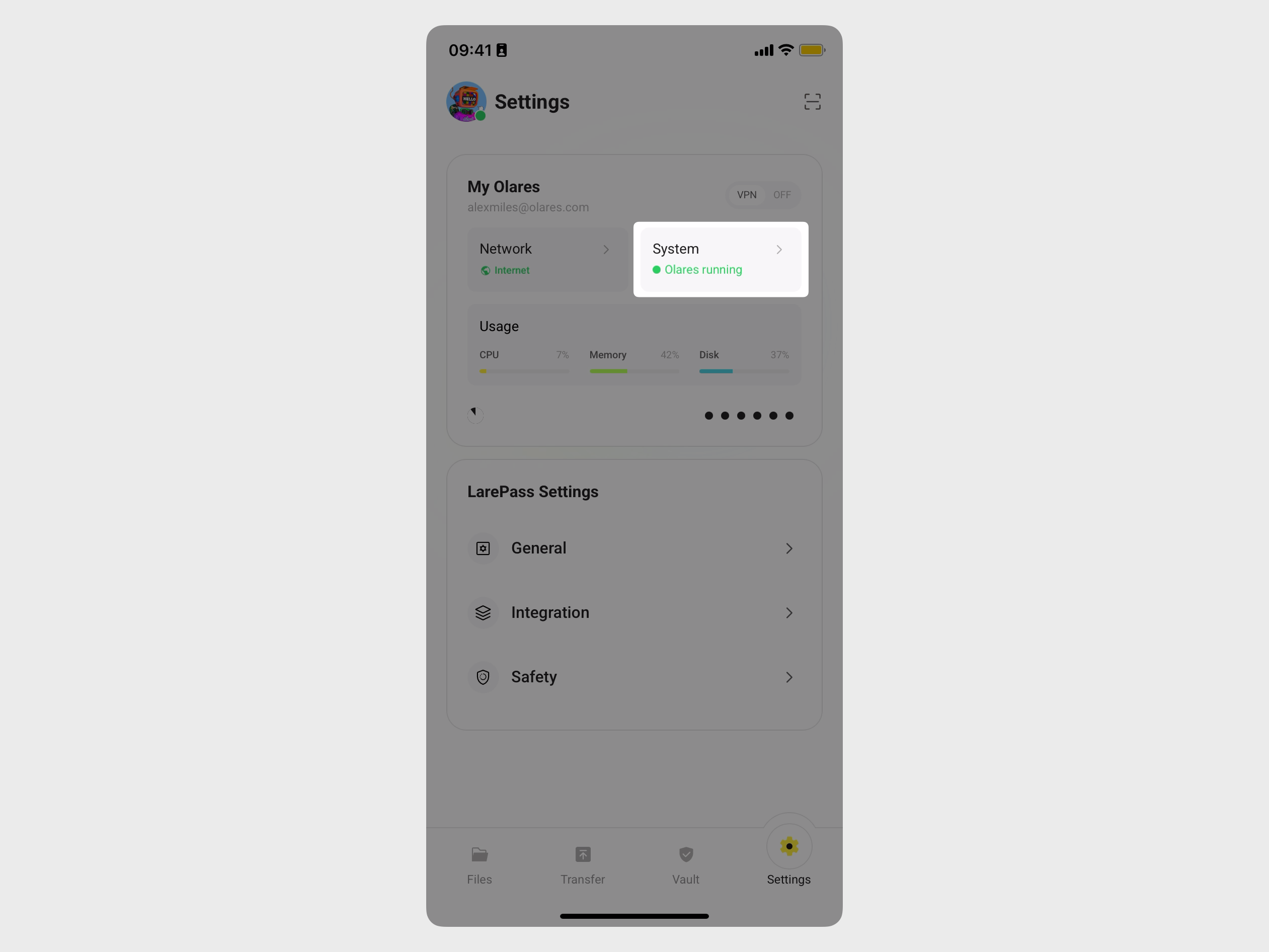

The Olares management page is the central hub for using LarePass to manage your Olares device. To access Olares management:
  1. Open LarePass app and go to Settings.
  2. In the My Olares card, tap System to enter the Olares management page.
On this page, you can:
  • View device information
  • Upgrade Olares
  • Restart or shut down Olares remotely
  • Modify network settings
  • Restore Olares to factory settings
  • Reset the SSH password Olares One Only

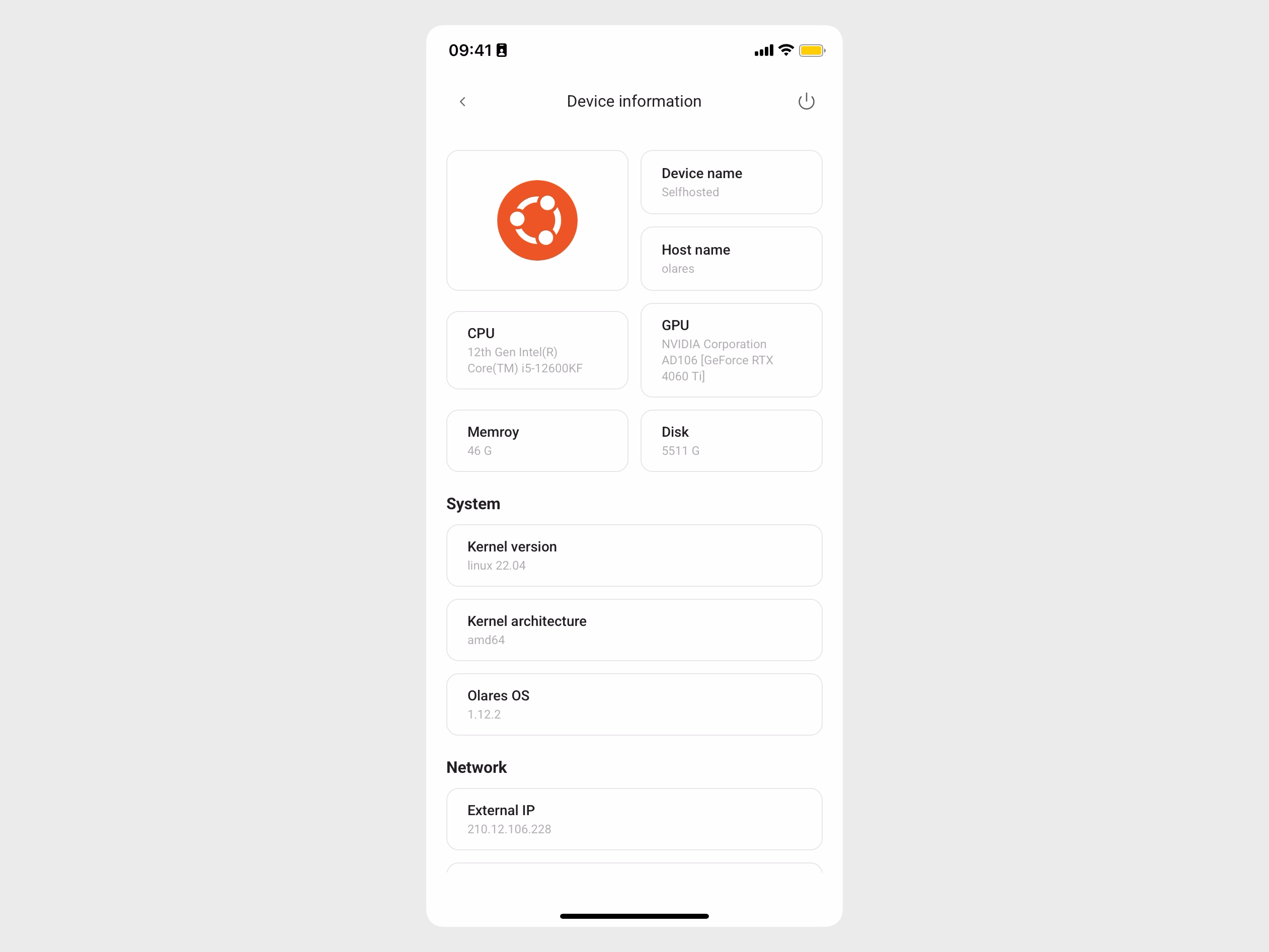

Tap the Device information area at the top to view detailed information, including:
  • Hardware details
  • System version
  • Current network connection status, including internal and external IP addresses

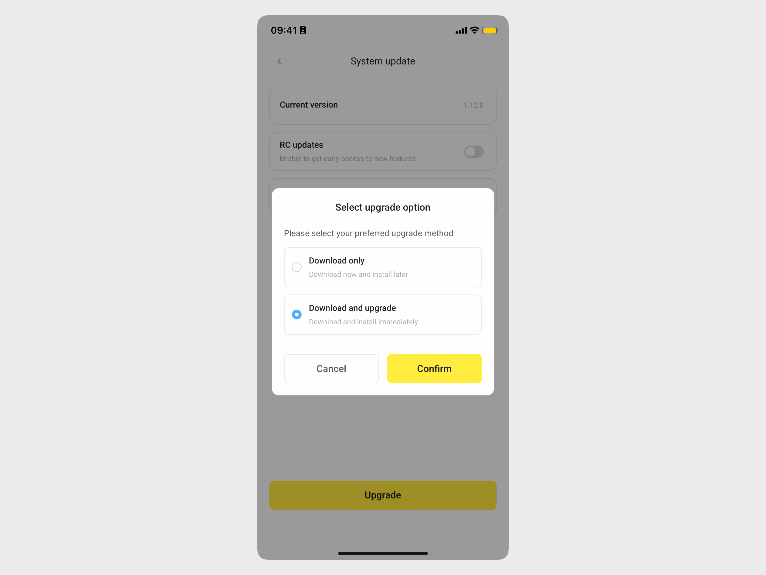

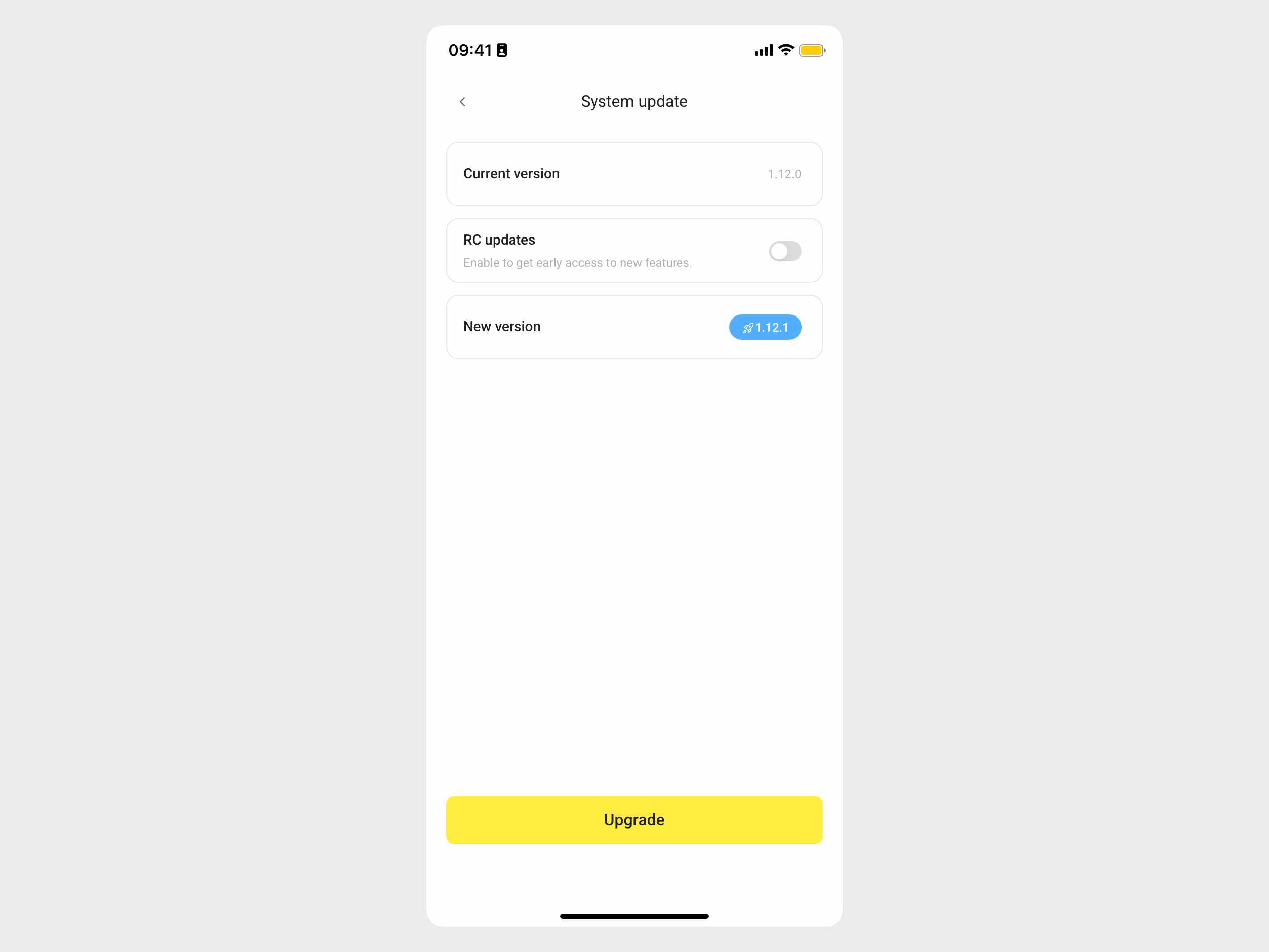

To install a system update:
  1. On the Olares management page, tap System update.
  2. On the System update page, confirm the available version in the New version field, then click Upgrade. Check for available version
  3. In the pop-up dialog, select how you want to upgrade:
    • Download only
      Olares downloads the update package in the background while you continue using the system.
    • Download and upgrade
      Olares downloads the update package and will install it after you confirm a restart.
    Choose upgrade method
  4. If you selected Download only, click Upgrade now on the System update page to initiate the process.
  5. If you selected Download and upgrade, confirm the restart when prompted to begin installation.
  6. Wait for the upgrade and restart to finish. When Olares starts up again, you'll see a success message and can continue using it.

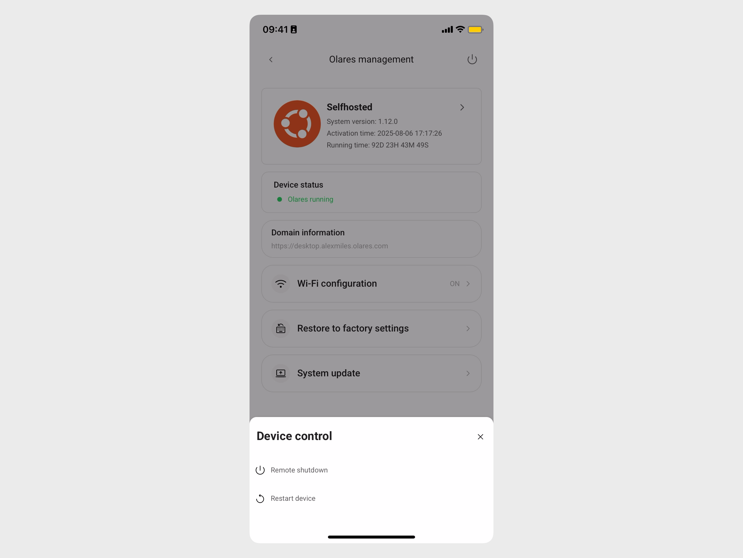

In the upper-right corner of the Olares management page, tap the power_settings_new icon to access remote control options:
  • Remote shutdown: Your Olares will power off. If your phone is on the same network as Olares, its status will show Powered off. Remote operations are unavailable after shutdown, and you must turn the device back on manually.
  • Restart device: Your Olares will restart. If your phone is on the same network as Olares, its status will show Restarting and will return to Olares running in approximately 5–8 minutes.
    If you restart from a network outside Olares, the My Olares card will be inaccessible during the restart and will return to normal after startup is complete.

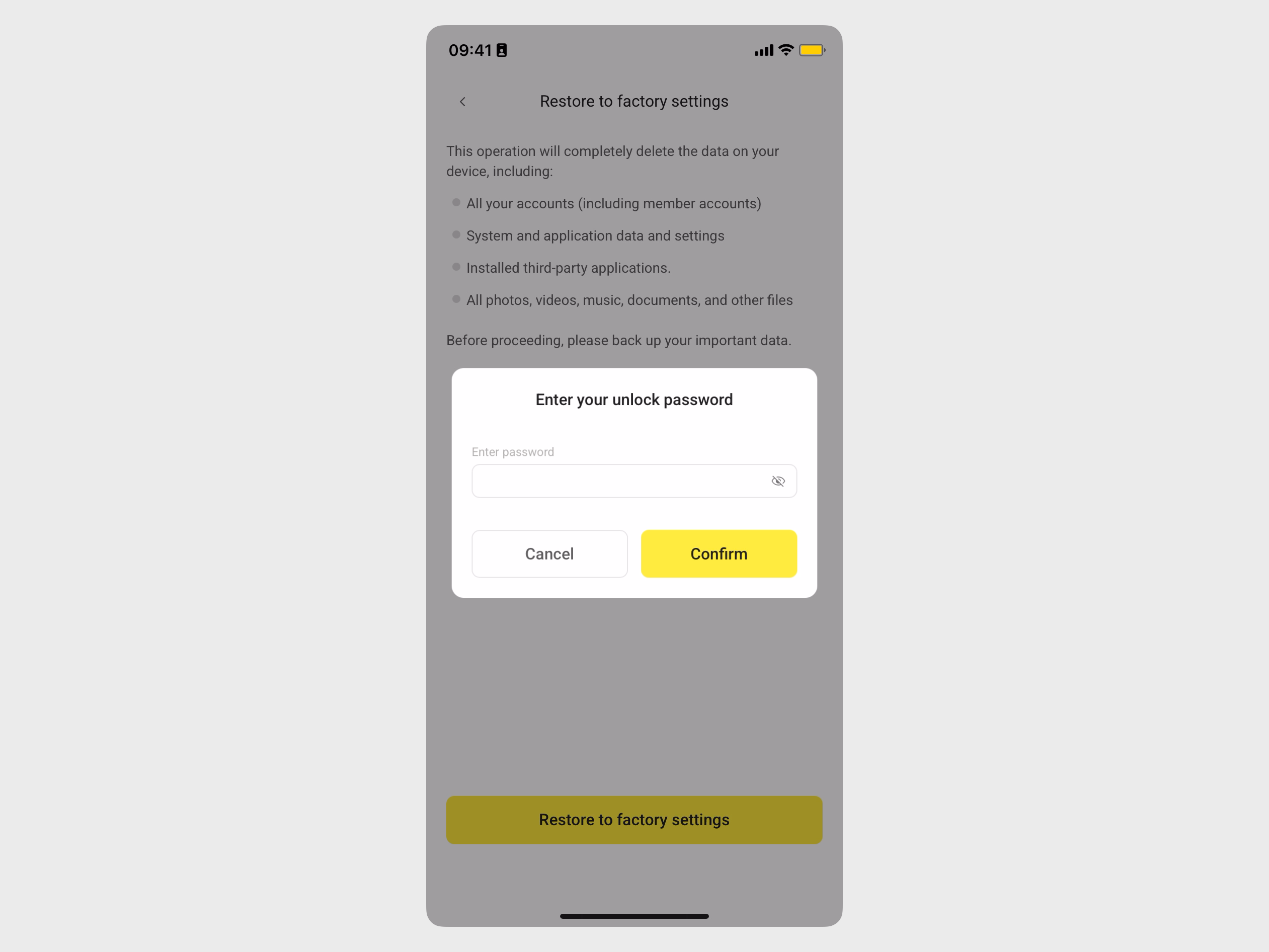

Proceed with caution
This will permanently delete all your accounts info and data. Proceed with caution.
Same network required
Make sure your phone and Olares are connected to the same network.
This action will reset your device to the prepare phase, where you can scan the LAN to re-install and activate Olares.
  1. On the Olares management page, tap Restore to factory settings.
  2. Review the risk prompt, and tap Restore to factory settings. Review risk prompt
  3. Enter your local LarePass lock screen password, and tap Confirm. If you haven't set a local password, you will be prompted to set one first. Enter local unlock password
  4. Wait for the reset to complete. Once finished, you will return to the account activation page.

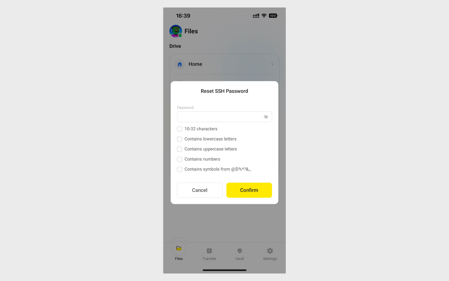

Reset SSH password Olares One Only
Required action
This dialog will continue to appear until you reset the password. While you can reset later from the My hardware settings page, we strongly recommend doing it immediately.
After you activate Olares One with LarePass, a Reset SSH Password dialog will appear automatically. Use it to change the default SSH password and prevent unintended SSH access.
Reset SSH Password
  1. In the Reset SSH Password dialog, enter a new password. Make sure it meets all strength requirements.
  2. Click Confirm.
