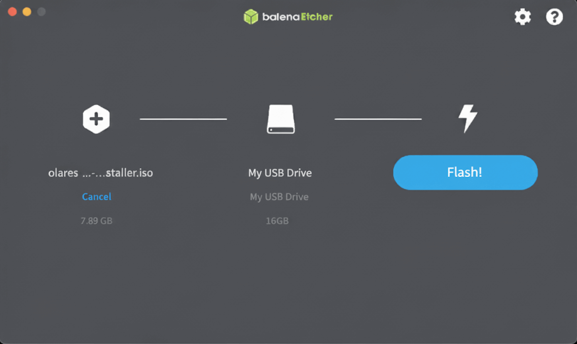

Create a bootable USB drive
- Click here to download the official Olares ISO image.
- Download and install Balena Etcher.
- Insert the USB flash drive into your computer.
- Launch Etcher and follow these steps:
- Image: Select the Olares ISO.
- Target disk: Select your USB drive.
- Click Flash to write the installer to the USB drive.

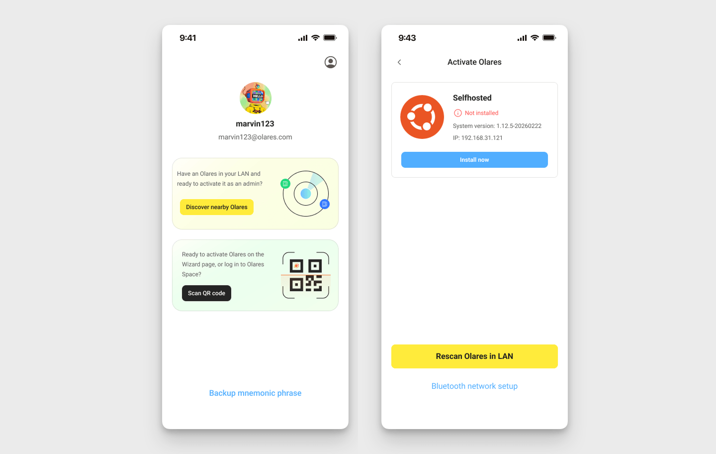

Finish installation and activate Olares
Same network required
Open LarePass app on your phone.
On your account activation page, tap Discover nearby Olares. LarePass will list the detected Olares instances in the same network.
Select the target Olares instance from the list and tap Install now.
When the installation completes, click Activate now.
In the Select a reverse proxy dialog, select a node that is closer to your geographical location. The installer will then configure HTTPs certificate and DNS for Olares.
- You can change this setting later on the Change reverse proxy page in Olares.
- If your Olares device is connected to a public IP network, this step will be skipped automatically.
Follow the on-screen instructions to set the login password for Olares, then tap Complete.
