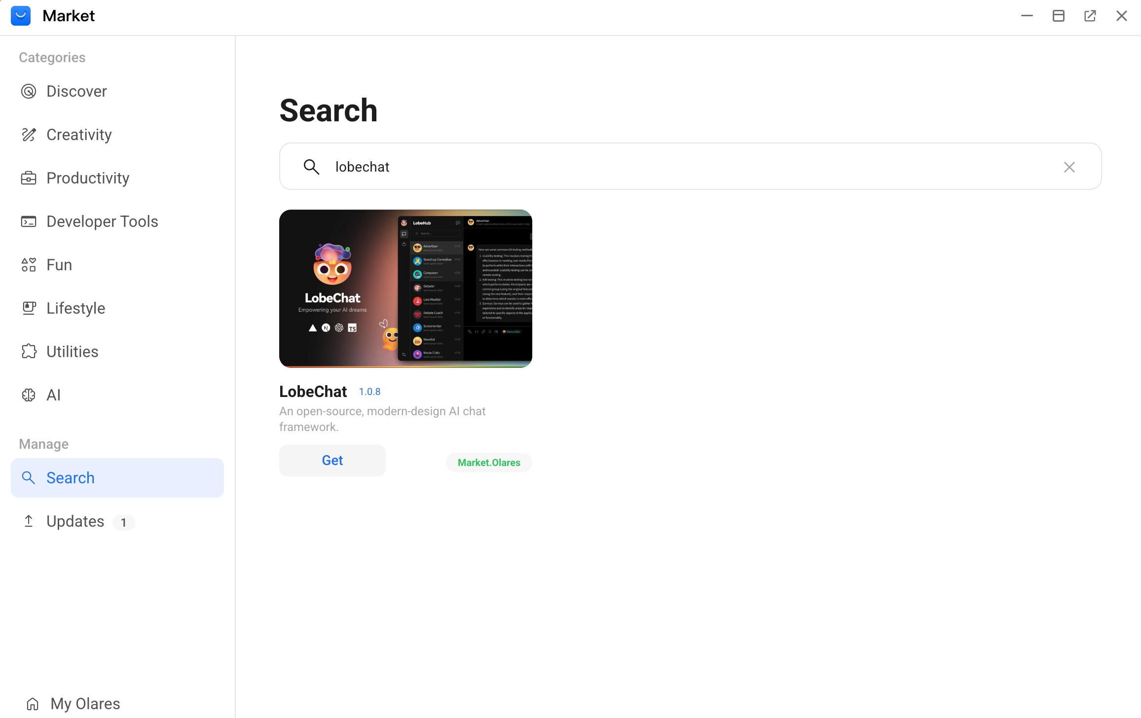

From the Olares Market, search for "LobeChat".
Click Get, and then click Install. Wait for the installation to finish.

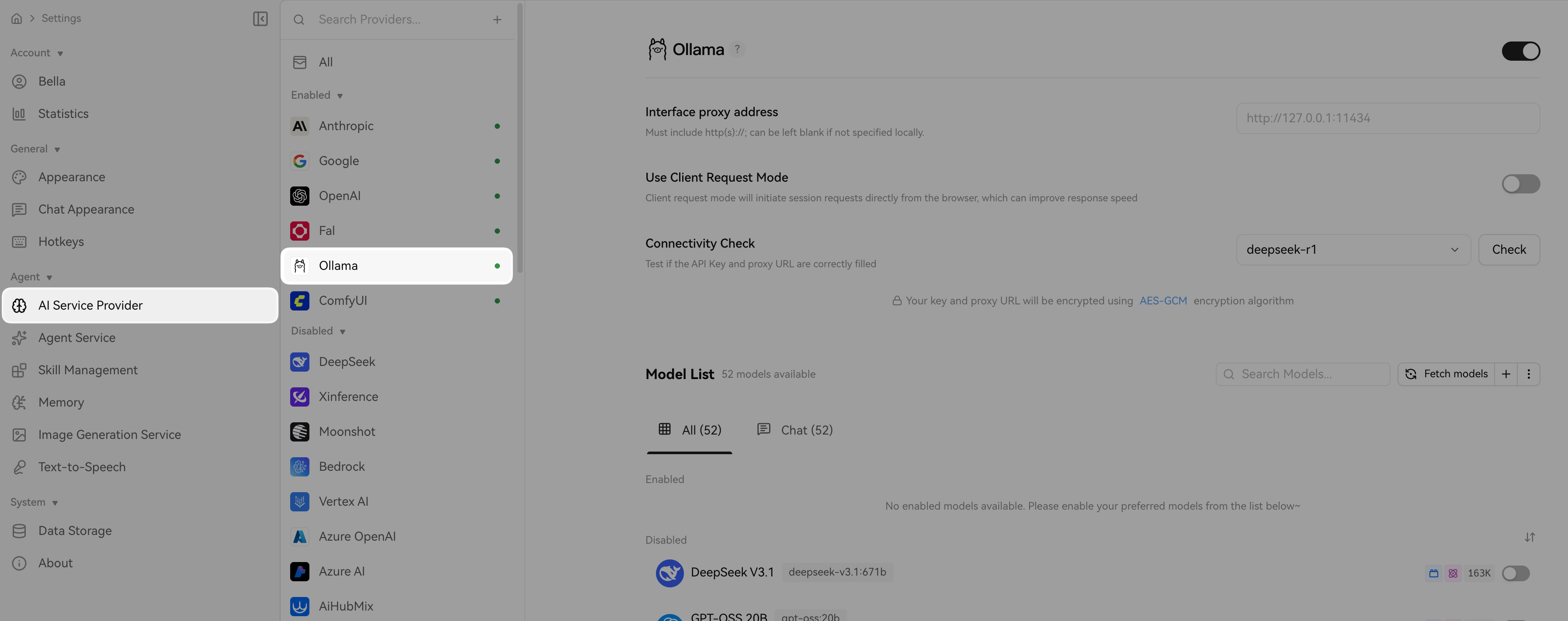

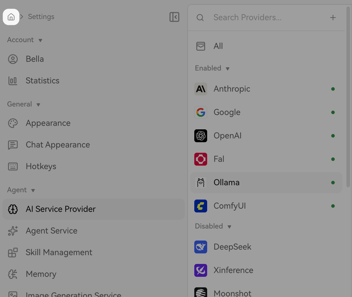

From the left sidebar, go to Settings > AI Service Provider > Ollama.

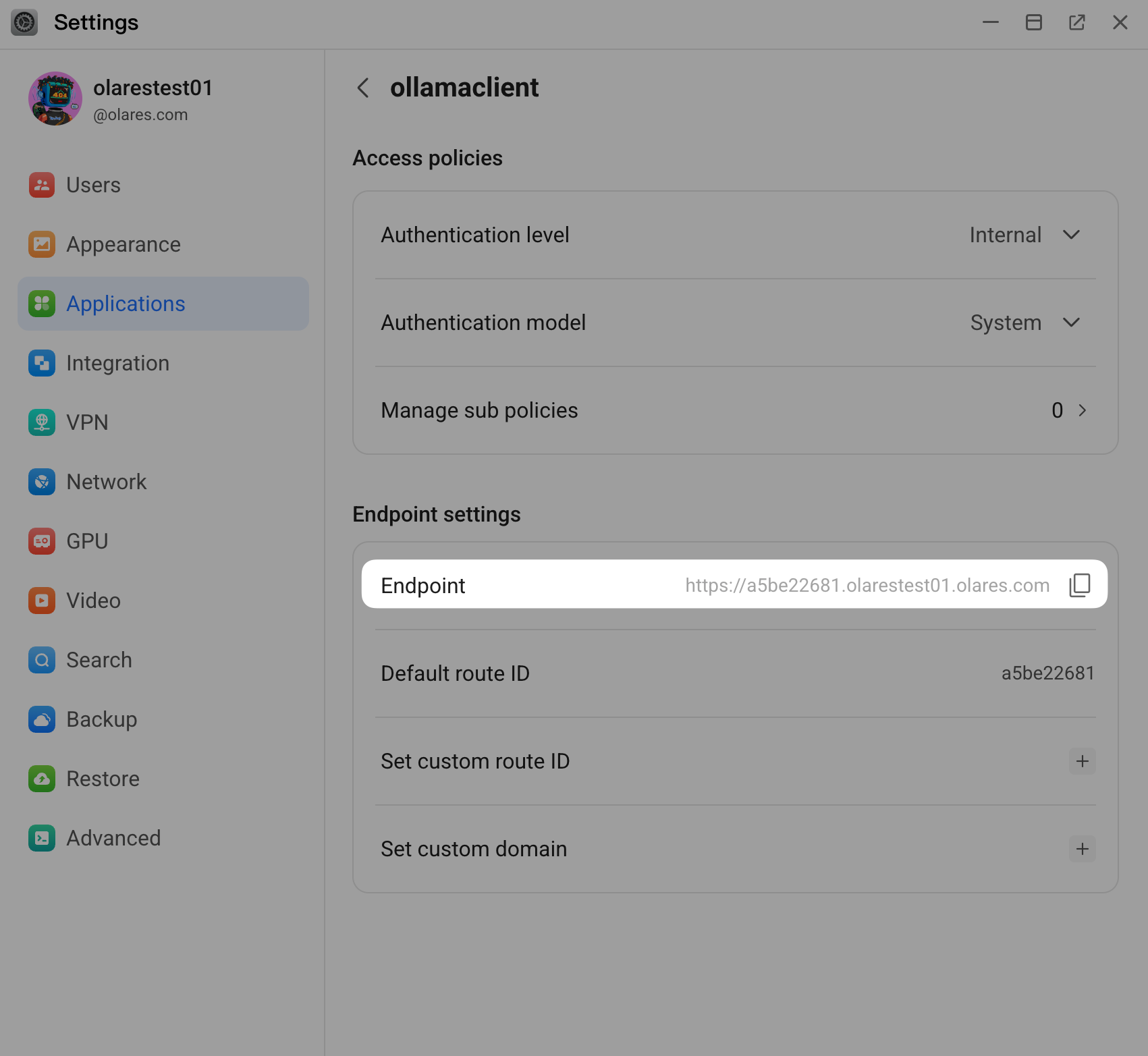

Obtain and enter your local Ollama address:
a. Open Olares Settings, and then go to Applications > Ollama.
b. Click Ollama API under Entrances or Shared entrances, and then copy the endpoint address.

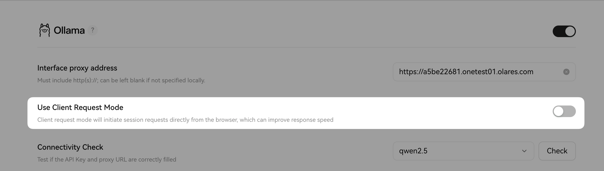

c. Return to LobeHub, and then enter the endpoint address in the Interface proxy address field.
Disable the Use Client Request Mode option.
Do not enable the Use Client Request Mode option when running local models. This mode is designed for remote API calls and might cause connection errors.

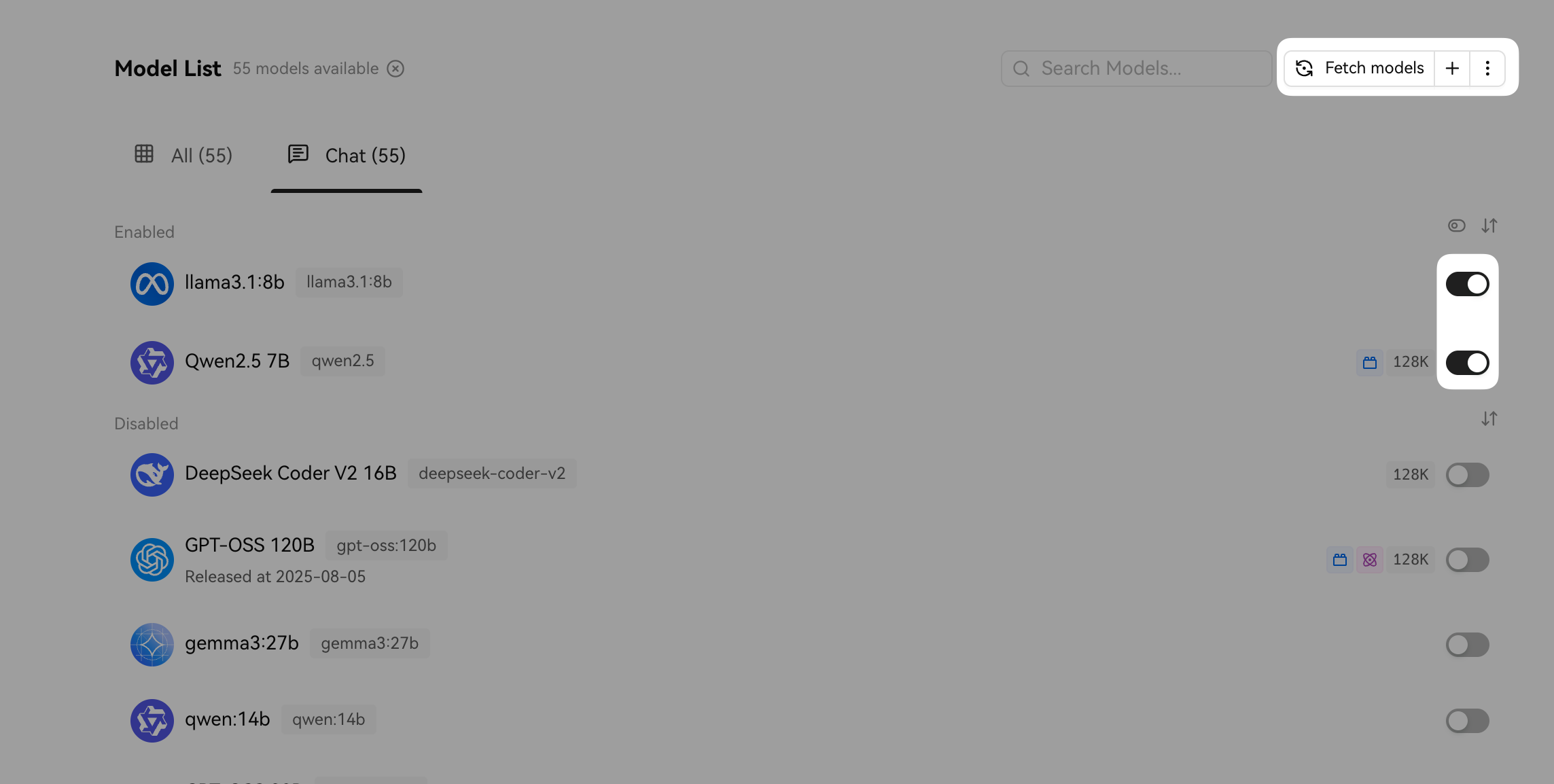

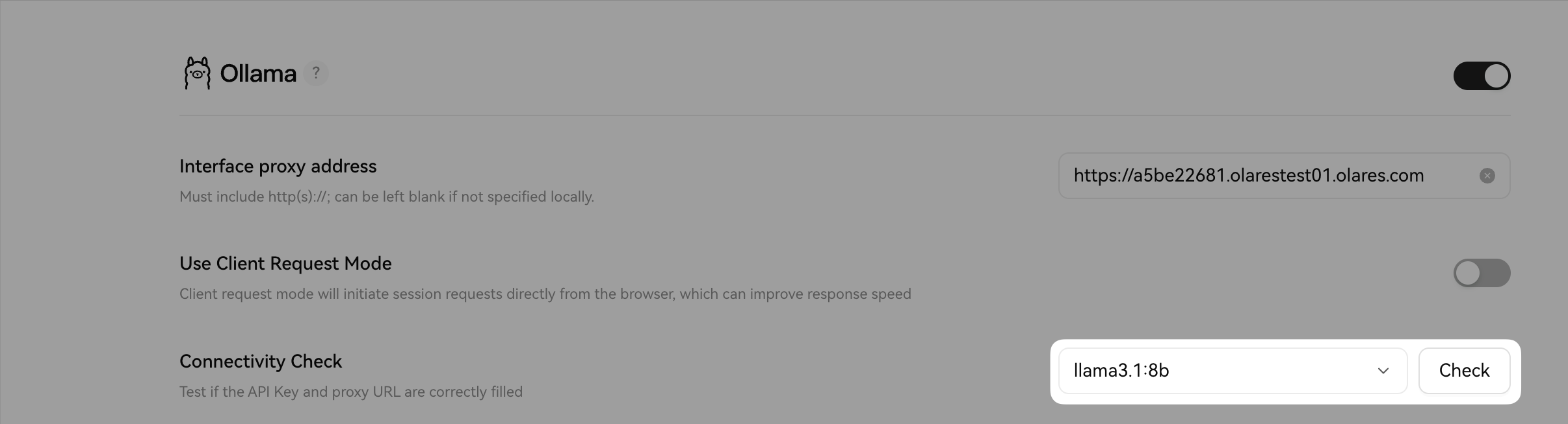

In the Model List section, click Fetch models to pull the list of supported models, and then click toggle_off to enable the models you want to use.

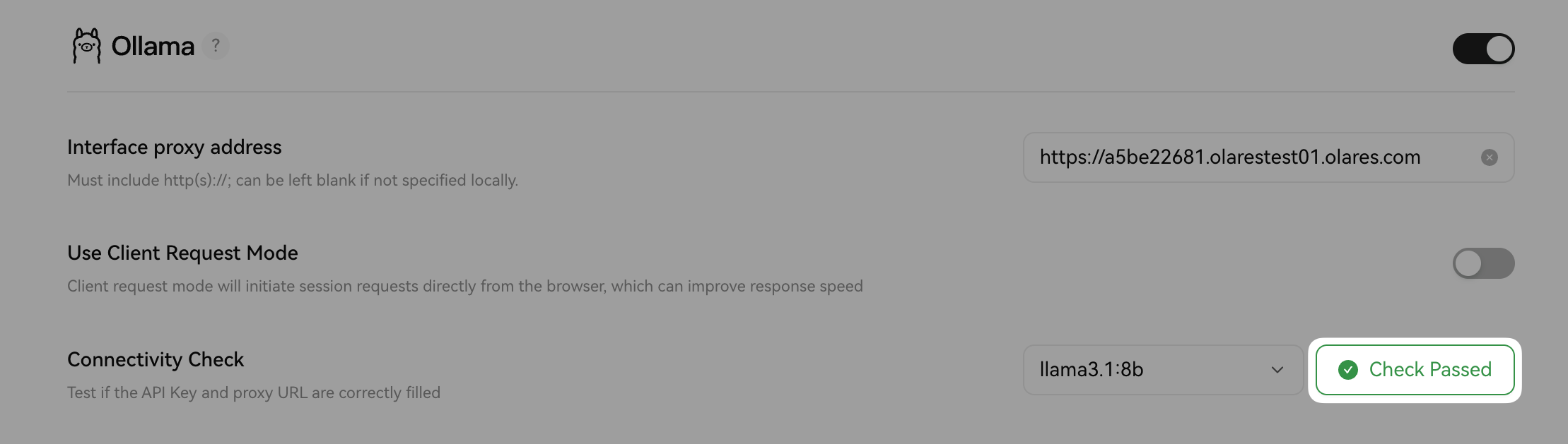

In the Connectivity Check section, select the model you just enabled from the list, and then click Check to verify the connection. If the model is large, it might take a little longer to load.
The button changes to Check Passed, indicating that the proxy address is correct.
Click the home icon at the upper-left corner to return to the LobeHub home page.

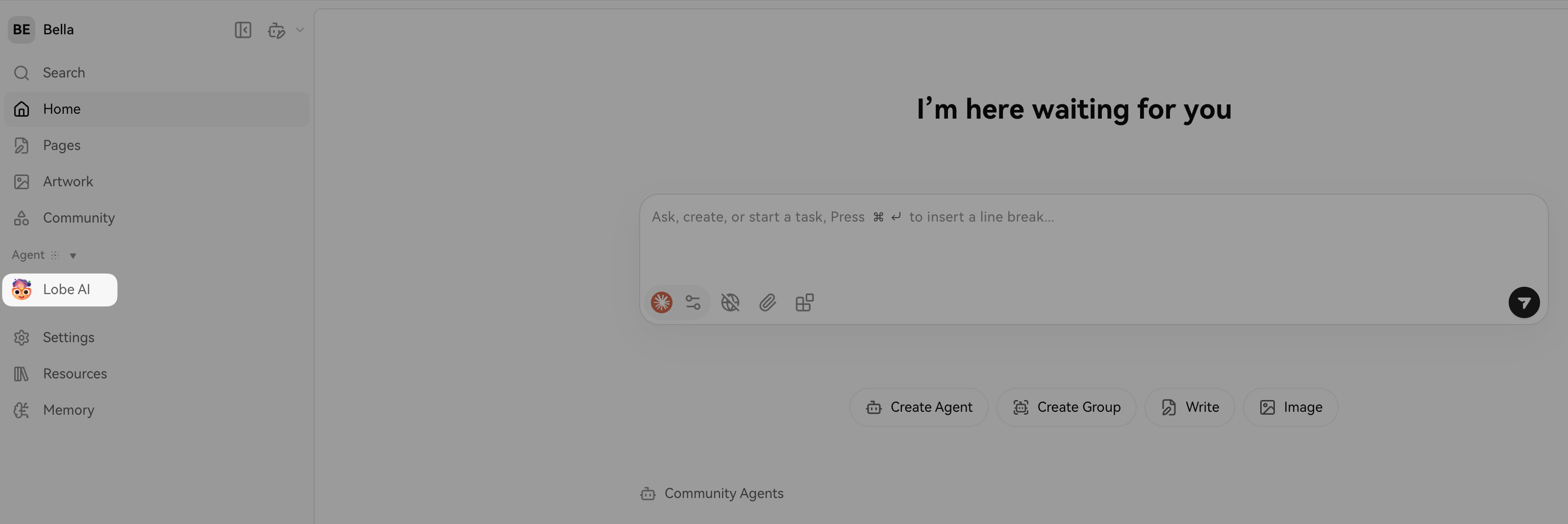

From the left sidebar, click Lobe AI.

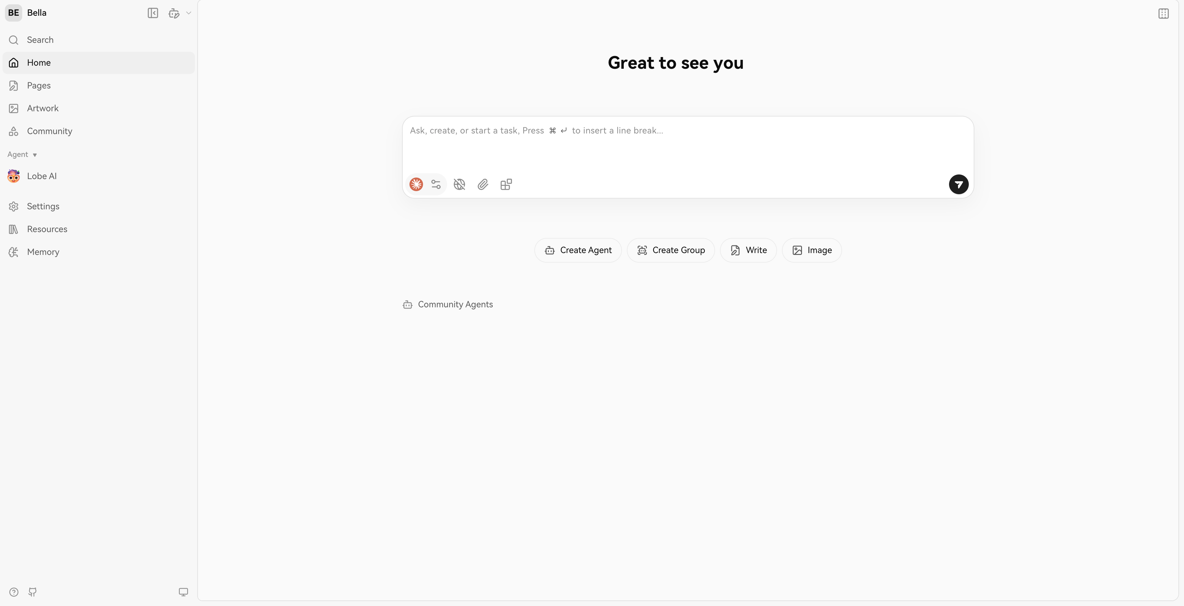

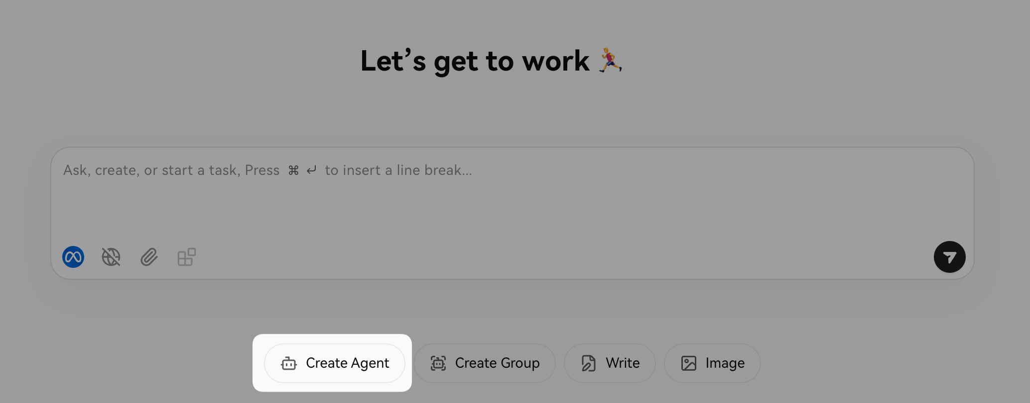

On the home page, click Create Agent under the chat box.

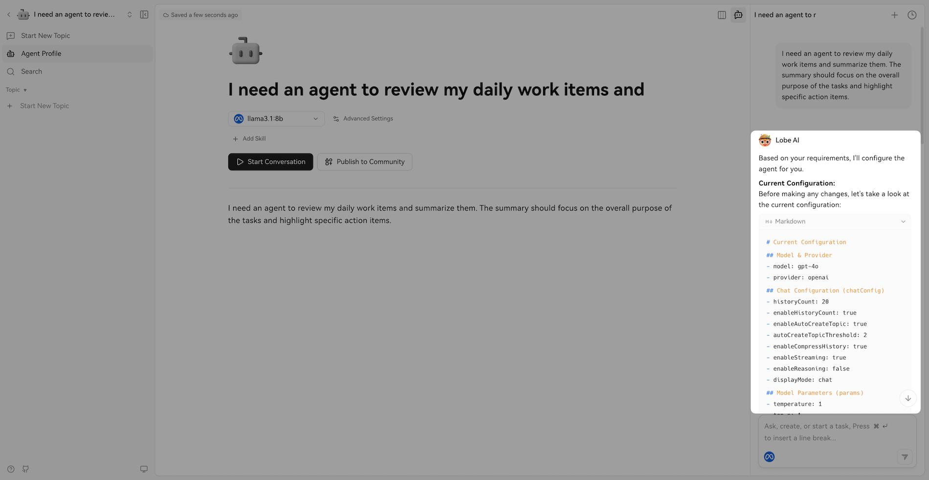

In the chat box, describe the specific task you want the agent to handle. For example,
I need an agent to review my daily work items and summarize them. The summary should focus on the overall purpose of the tasks and highlight specific action items.Select the language model. For example,
llama3.1:8b.Press Enter. The profile page of the new agent opens, and you can see the Agent Builder starts configuring your agent automatically.
Use the chat interface on the lower right to interact with the Agent Builder. As you provide more details or refine your requirements, the Agent Builder automatically drafts and updates accordingly.
After the creation is completed, click Start Conversation to use the agent.

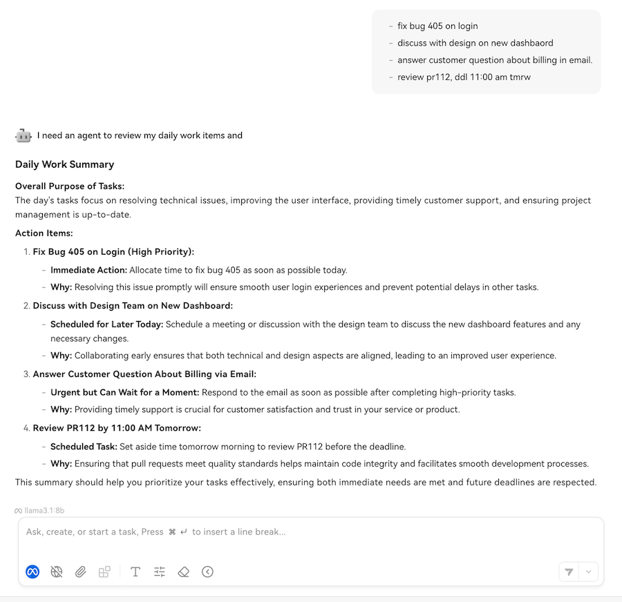

Provide your text in the chat, and then you can get the refined results. For example,
- fix bug 405 on login - discuss with design on new dashboard - answer customer question about billing in email. - review pr112, ddl 11:00 am tmrwYou get the output:

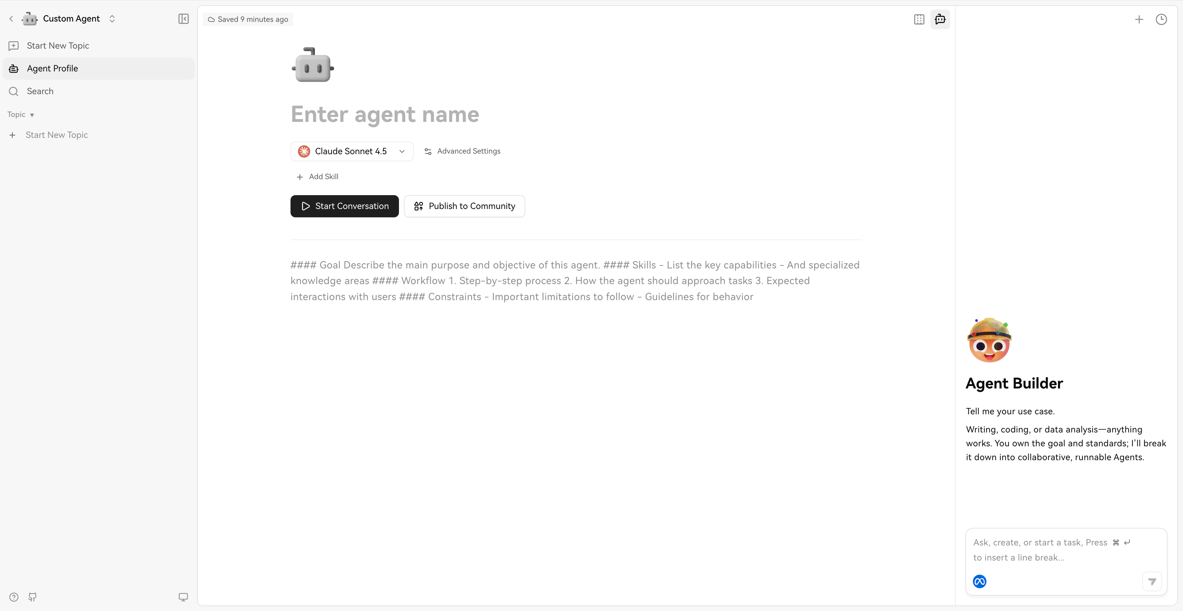

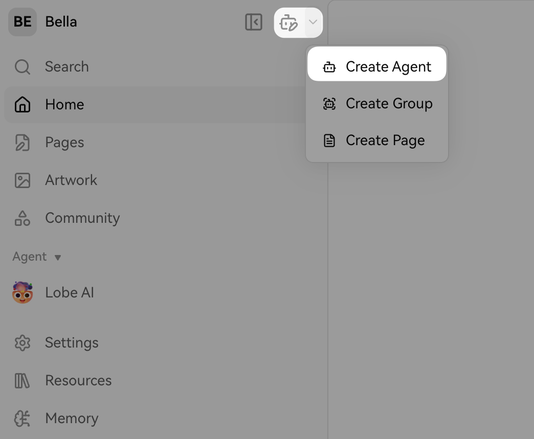

On the home page, click the robot icon in the upper left corner, and then select Create Agent.
The Agent Profile page opens.
Click the default robot avatar to select a new icon for your agent.
Enter the agent name. For example,
SEO Copywriter.Select the language model. For example,
qwen 2.5.Click + Add Skill to equip the agent with additional tools. For example, select Web Browsing for gathering SEO data.
Define role and behavior by filling out the structured markdown template to define exactly how the agent operates. For example,
#### Goal Write SEO-optimized blog posts based on the user-provided topic. #### Skills - Keyword research, deployment, and and density optimization - Engaging headline generation - Markdown formatting #### Workflow 1. Ask the user for a topic. 2. Suggest target keywords, an H1 title, and an optimal meta description. 3. Generate a structured outline designed for google's featured snippets. 4. Generate a structured outline for approval. 5. Write the full blog post once the outline is approved. #### Constraints - Use simple language and avoid technical jargon. - Focus on user values instead of listing product features. - Avoid using passive voice. - Target users with the second person "you"Click Start Conversation to use it. For example, type the following request:

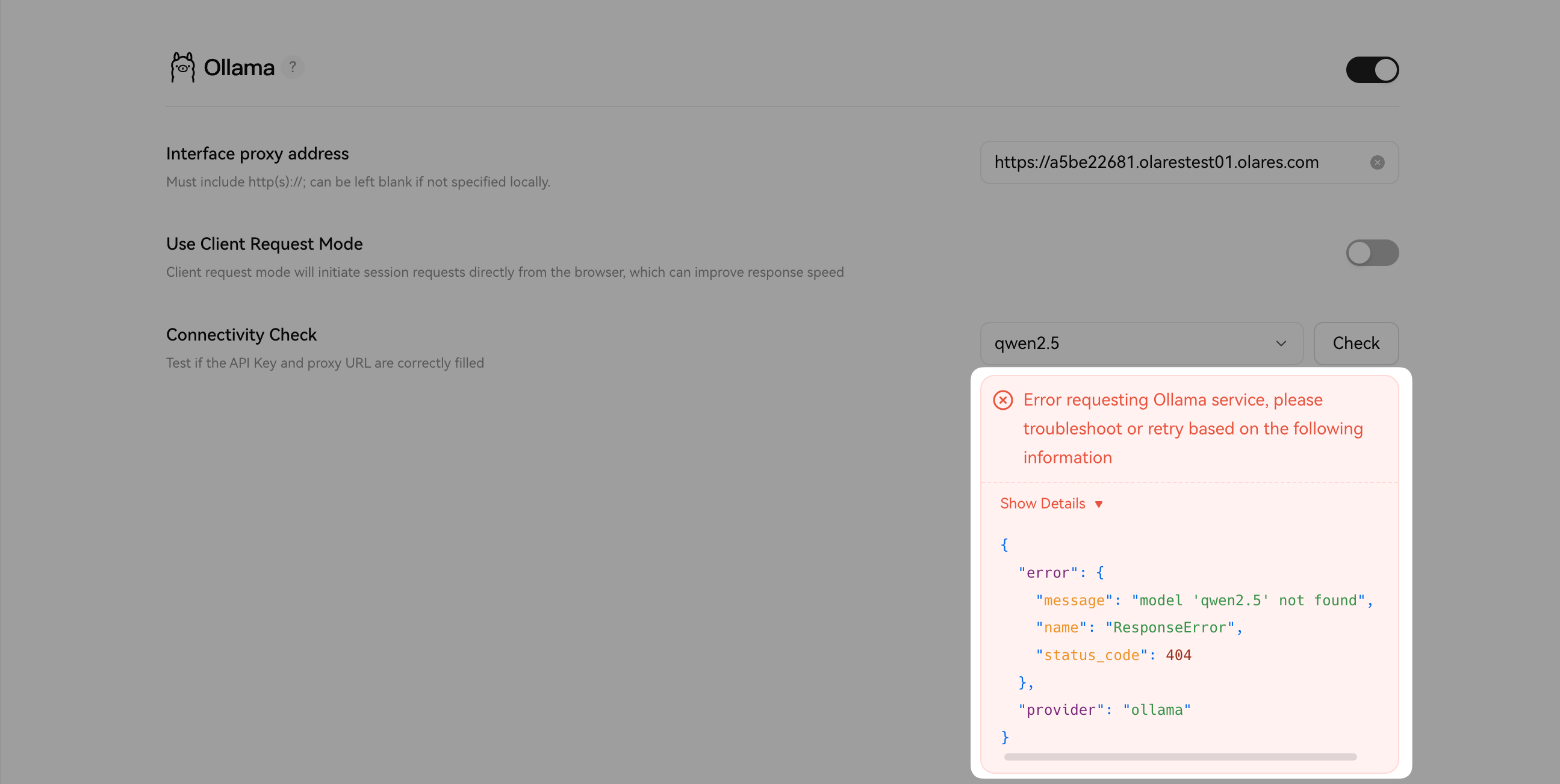

Why did the connection check fail when I connected to Ollama?
If you encounter the Error requesting Ollama service error, troubleshoot as follows and retry:
Ensure the specific model you are using is downloaded using Ollama.
Ensure the Use Client Request Mode option on the Ollama settings page is disabled.
