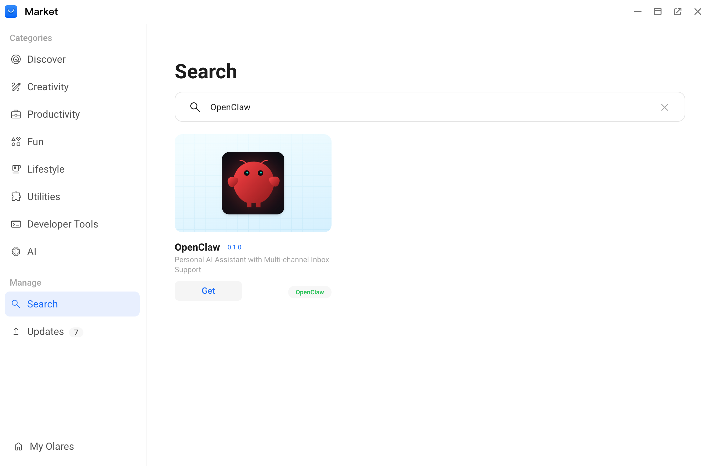

  1. From the Olares Market, search for "OpenClaw".
    Search for OpenClaw from Market
  2. Click Get, and then click Install. When the installation finishes, two shortcuts appear in the Launchpad:

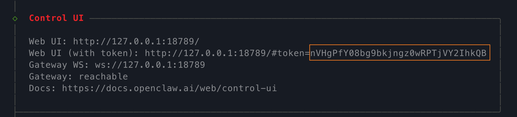

  4. After you complete the onboarding wizard, scroll up to the Control UI section.
  5. Find the Web UI (with token), and then copy the token at the end of the URL (the text immediately following #token=). This is your Gateway Token.
    Obtain gateway token

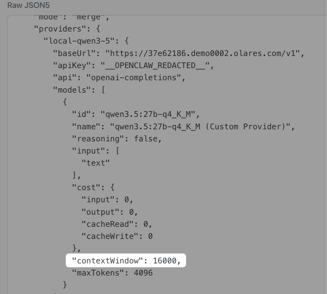

Step 4: Configure context window
OpenClaw requires a large "context window" (that is the AI's short-term memory) to handle complex tasks without forgetting your previous instructions.
  1. In the Control UI, select Config from the left sidebar, and then switch to the Raw tab.
  2. Find the models section and locate the configuration block for your model.
  3. Add or update the contextWindow value. Set it to at least 64000 (64K). If your hardware VRAM permits, it is highly recommended to increase it to 200000 (200K).
  4. Click Save in the upper-right corner. The system validates the configuration and restarts automatically.

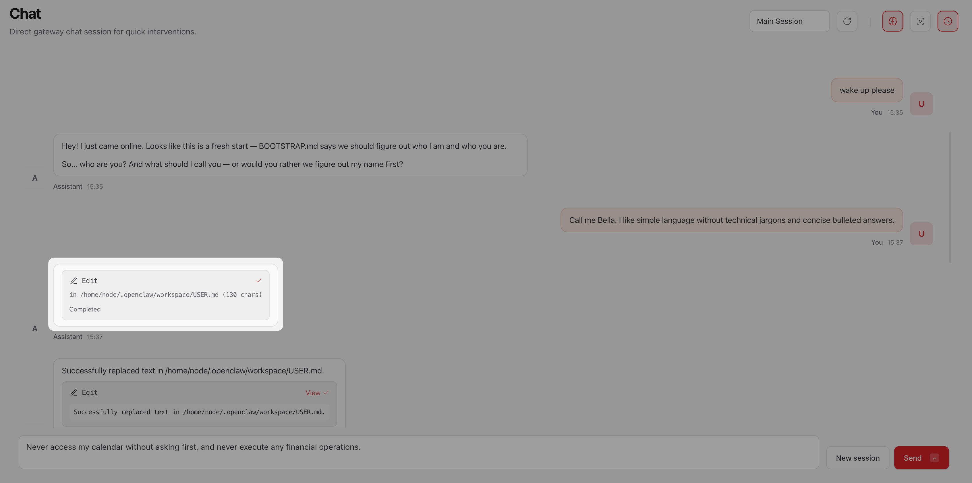

  1. In the Control UI, select Chat from the left sidebar.
  2. Ensure neurology at the upper-right corner is enabled. This allows you to watch the agent think and edit persona files in real time.
  3. Enter and send the following message to start:
    Wake up please!
    The agent responds and starts interviewing you. You can establish rules, personality traits, and preferences. For example,
    - Call me Bella. I like simple language without technical jargon and
    concise bulleted answers.
    - You are John, a witty assistant who uses emojis.
    - Never access my calendar without asking first, and never execute any
    financial operations.
  4. As you chat with the agent, look for the Edit messages. These indicate the agent is successfully writing your preferences to its core persona files, such as IDENTITY.md, USER.md, and SOUL.md.

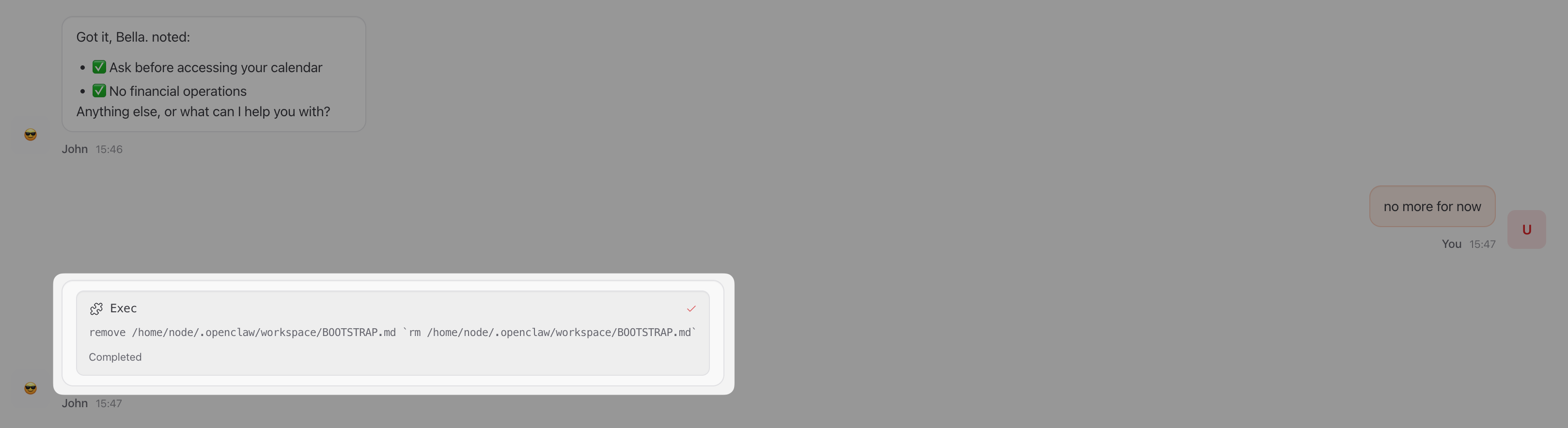

  5. Continue the conversation until the agent gathers enough information. Then, it automatically deletes the temporary BOOTSTRAP.md file to finish the personalization process.
    Finish hatch agent
  6. (Optional) If the agent fails to update the persona files or delete BOOTSTRAP.md, explicitly instruct it to do so in the chat.

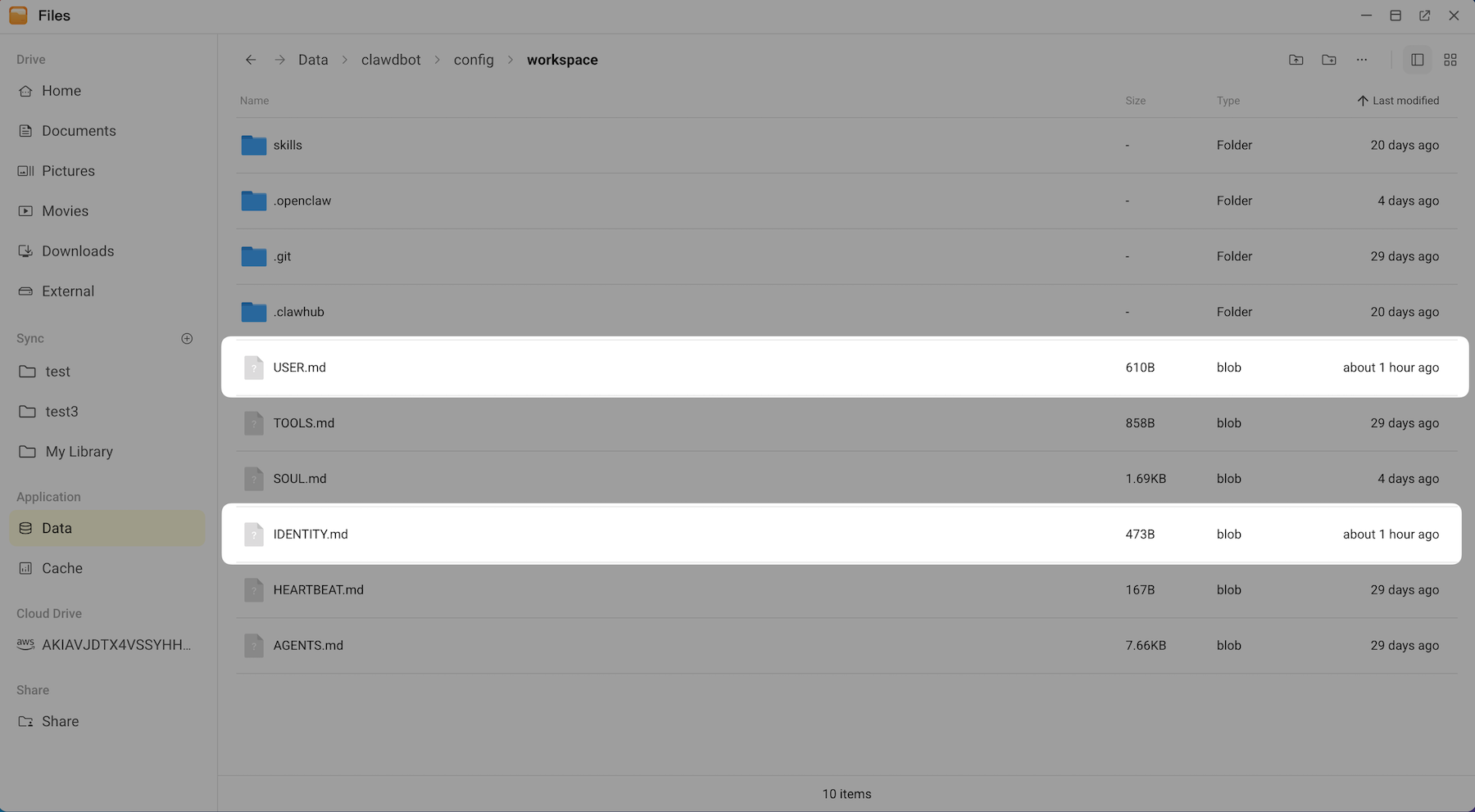

  7. Verify your agent's persona files are updated:
    a. Open Files from the Launchpad.
    b. Go to Application > Data > clawdbot > config > workspace.
    c. Check the modified time of the .md files to identify which ones were recently updated, such as USER.md and IDENTITY.md.
    Persona files generated by OpenClaw
    d. (Optional) Double-click a file to verify that it contains your newly established rules such as name, language style, and restrictions.
