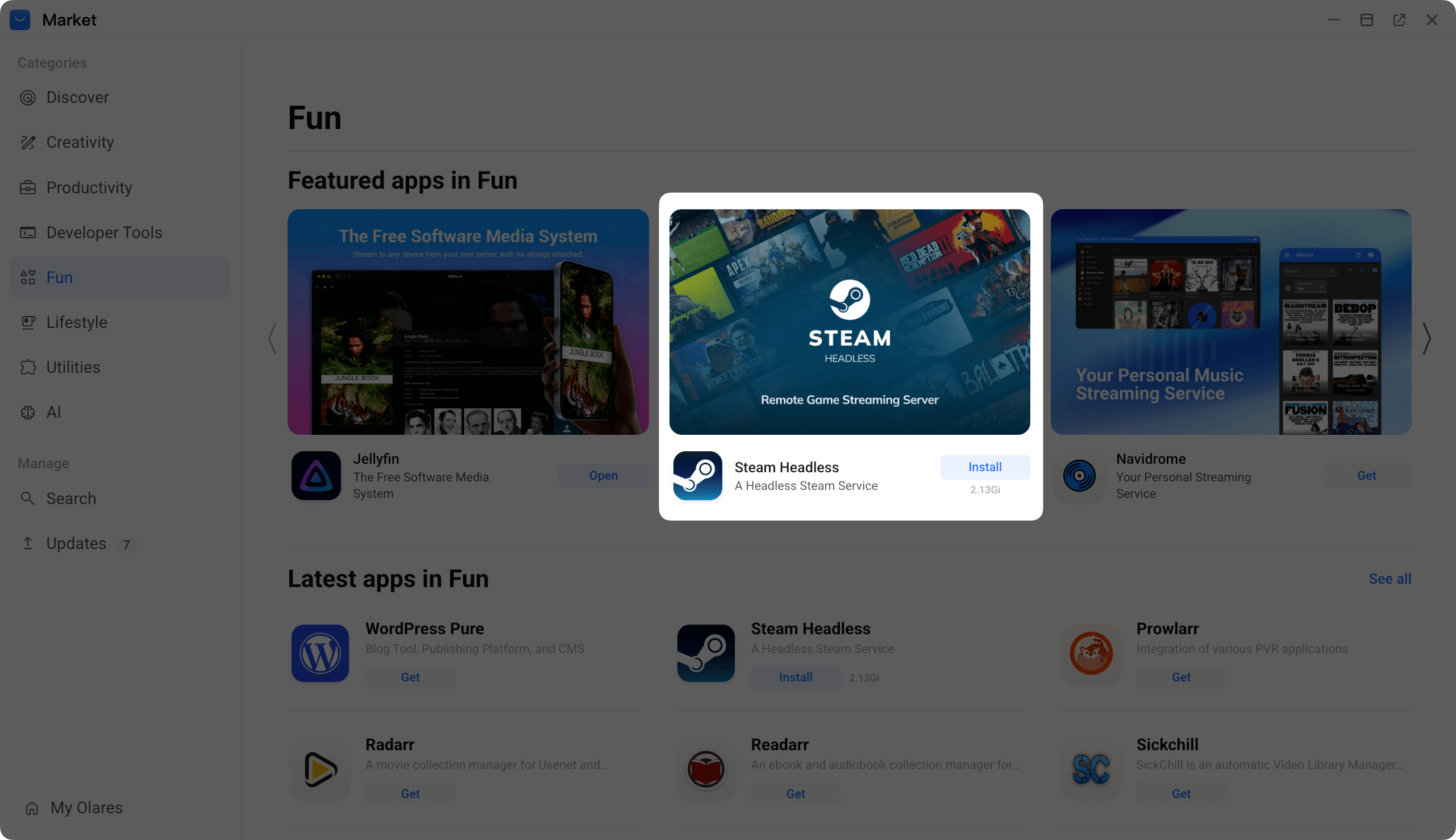

  2. Find Steam Headless in the Fun category or use the search bar.
  3. Click Get, and then click Install. Install Steam Headless

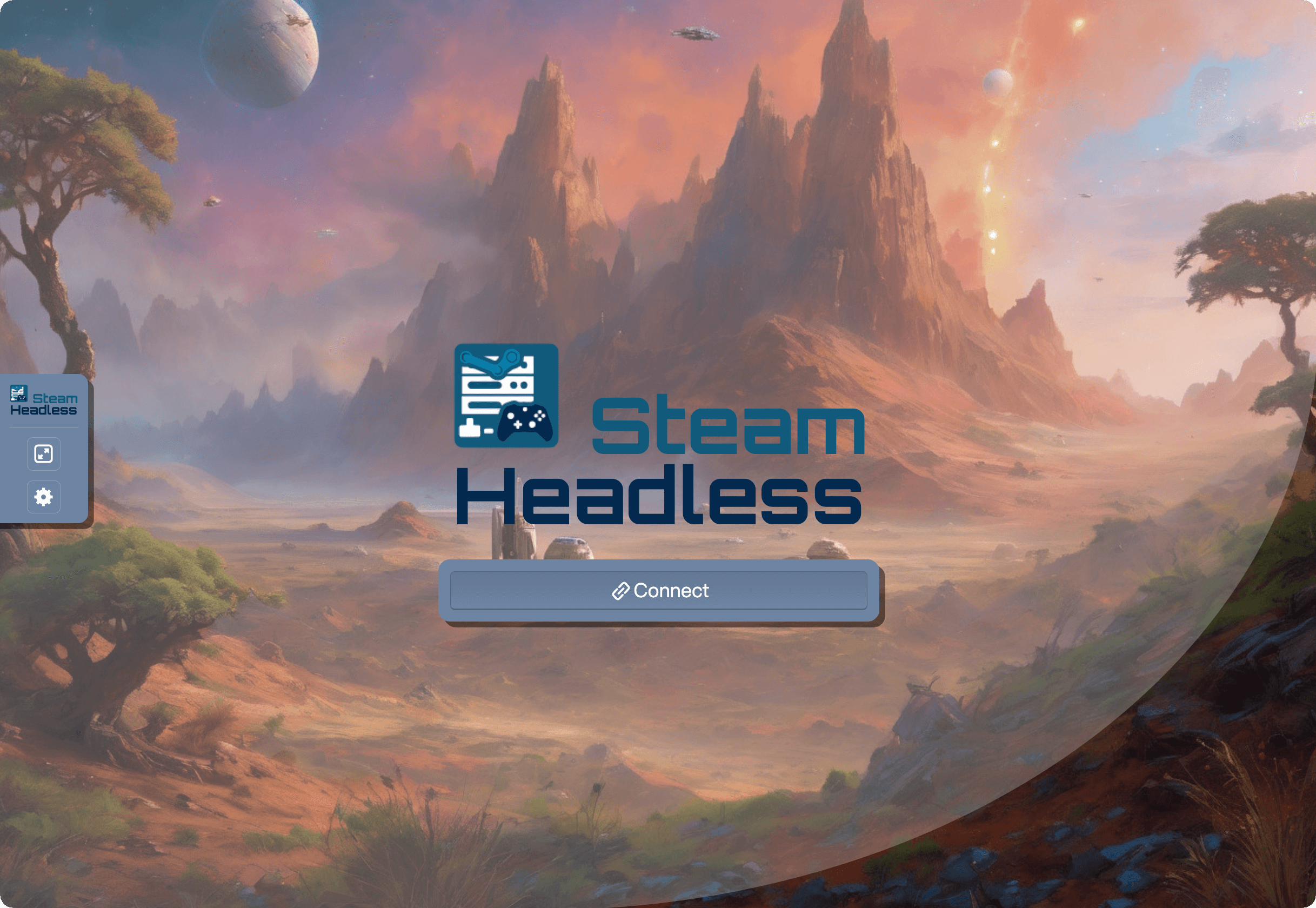

  1. Once installed, open Steam Headless and click Connect. Connect to Steam

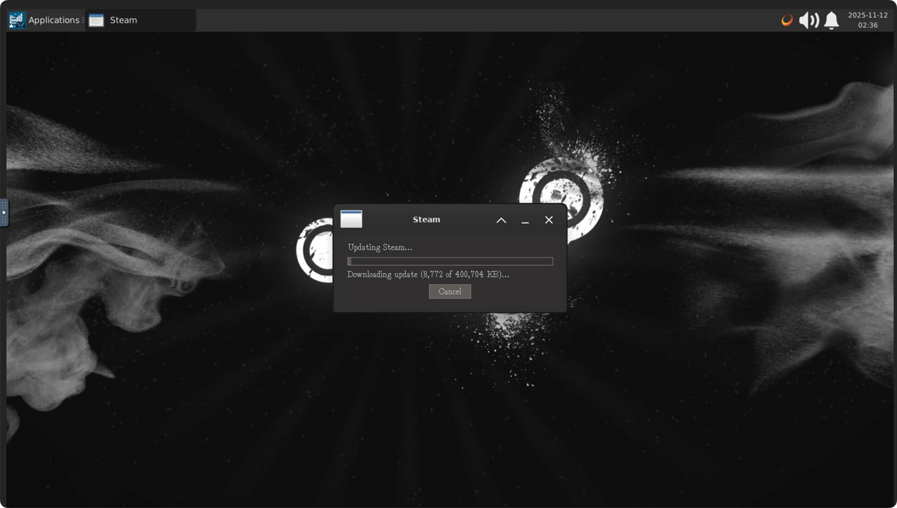

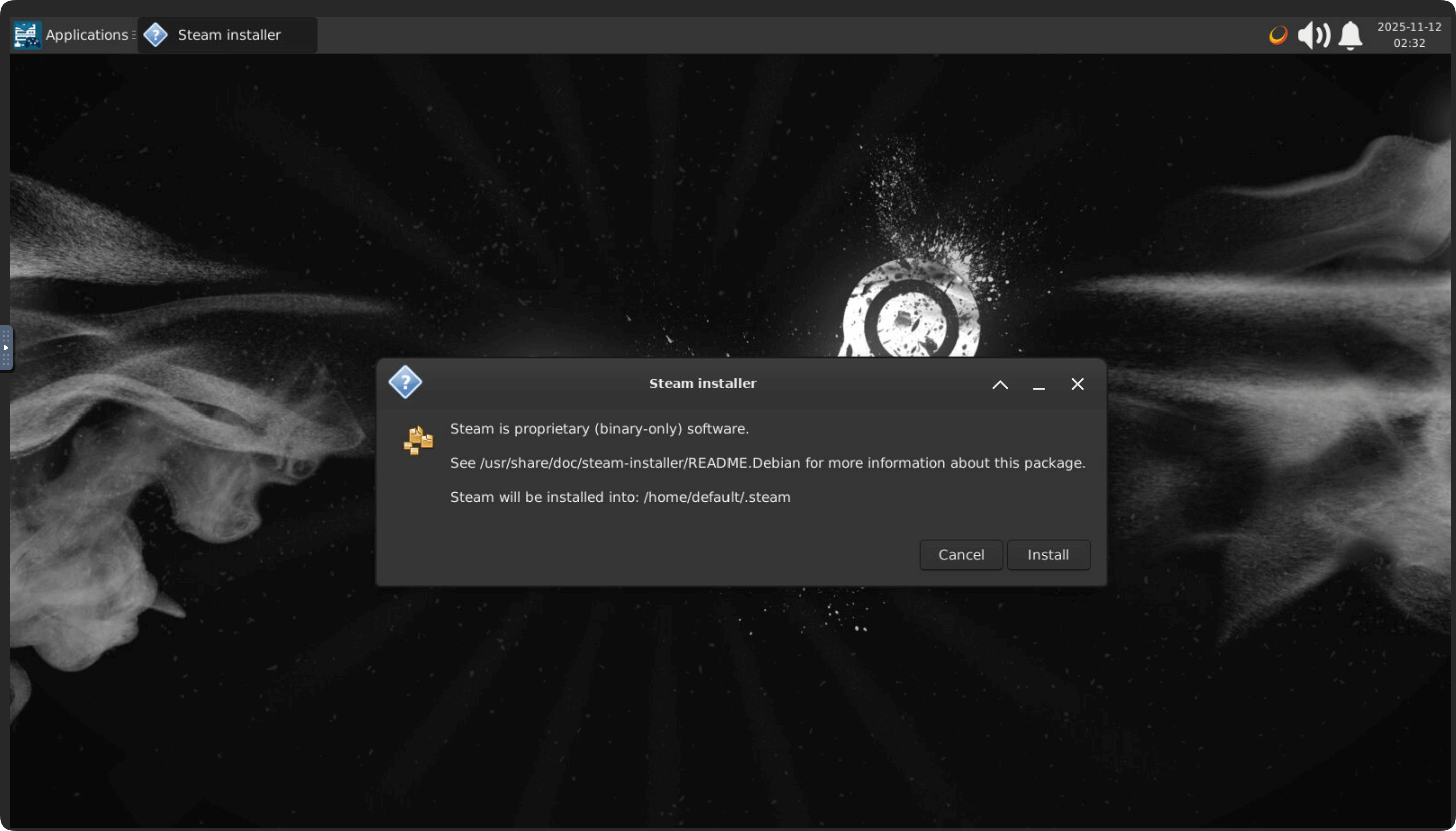

  2. The Steam client will automatically install and update. This process may take several minutes. Install SteamUpdate Steam

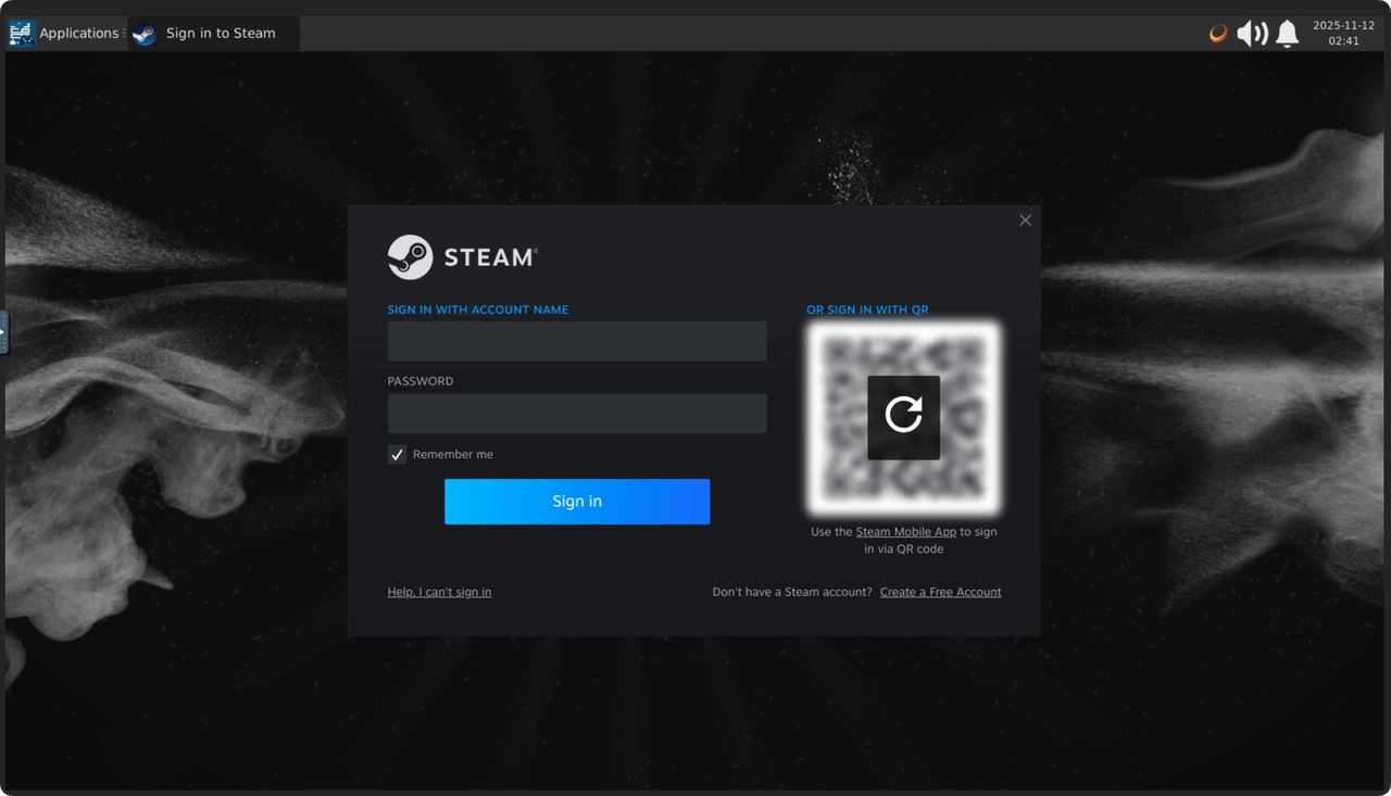

  3. When the installation completes, the Steam login screen appears. Sign in with your Steam account. Sign in to Steam
Retry installation upon failures
If Steam installation or update fails due to network issues, go to the top-left menu in the Steam Headless console and navigate to Applications > Internet > Steam to restart the installation.

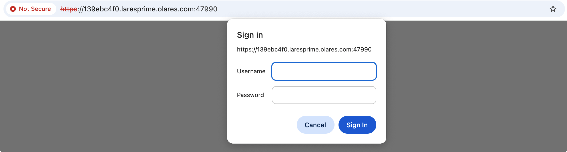

  4. Sign in using the SUNSHINE_USER and SUNSHINE_PASS credentials you created earlier. Sign in to Sunshine

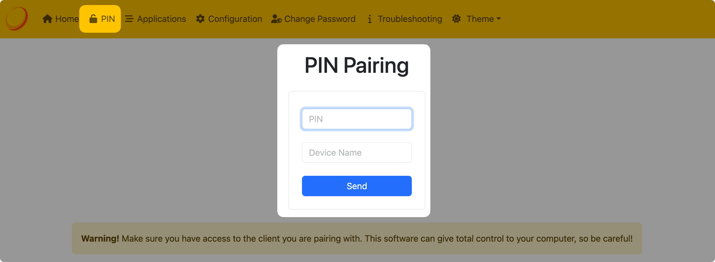

  5. Click the PIN tab. The page will now wait for a pairing PIN. PIN on Sunshine

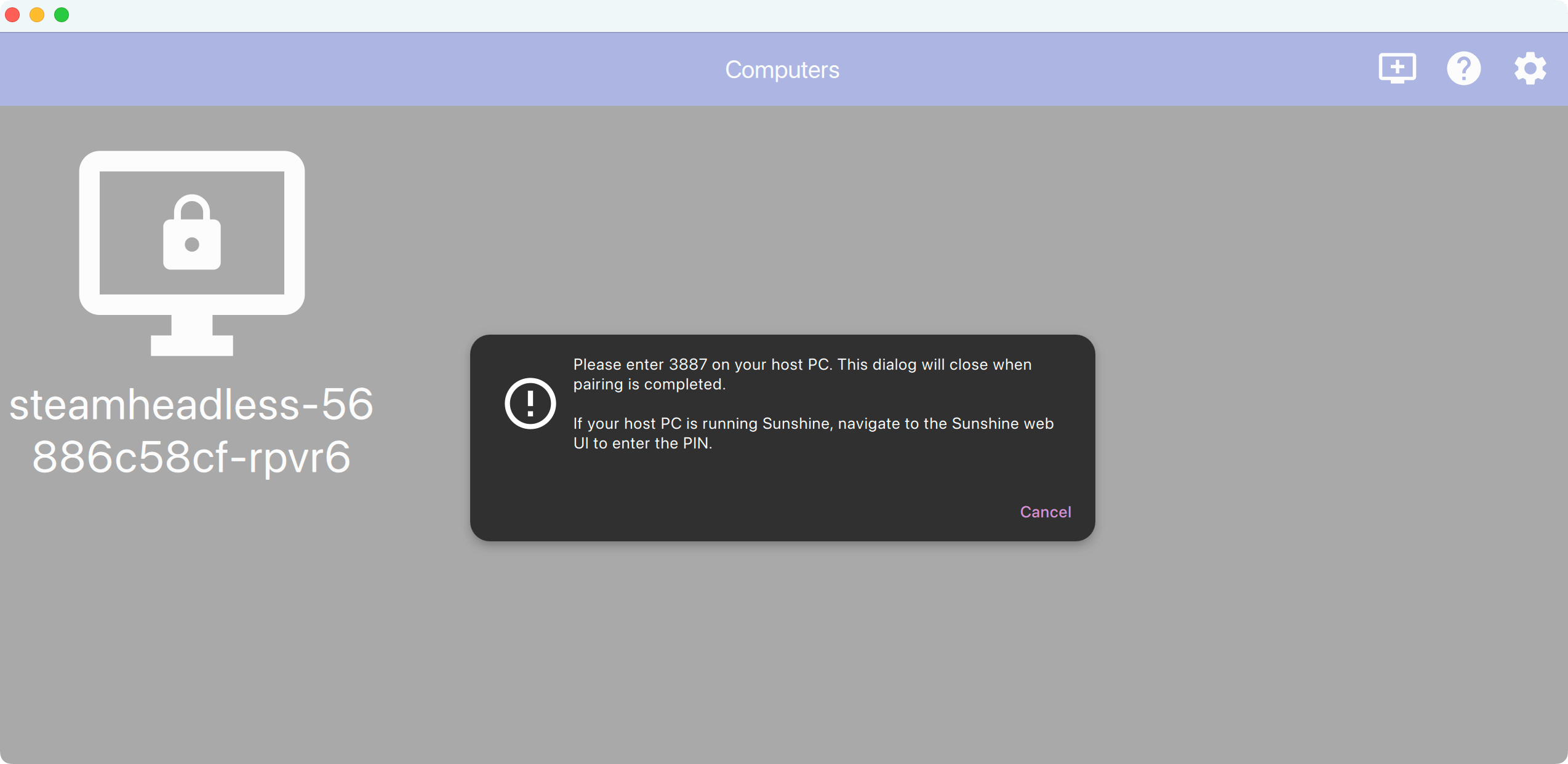

  4. Click OK. A new locked host icon appears.
  5. Click the locked icon. Moonlight will display a 4-digit pairing PIN. Get pairing PIN

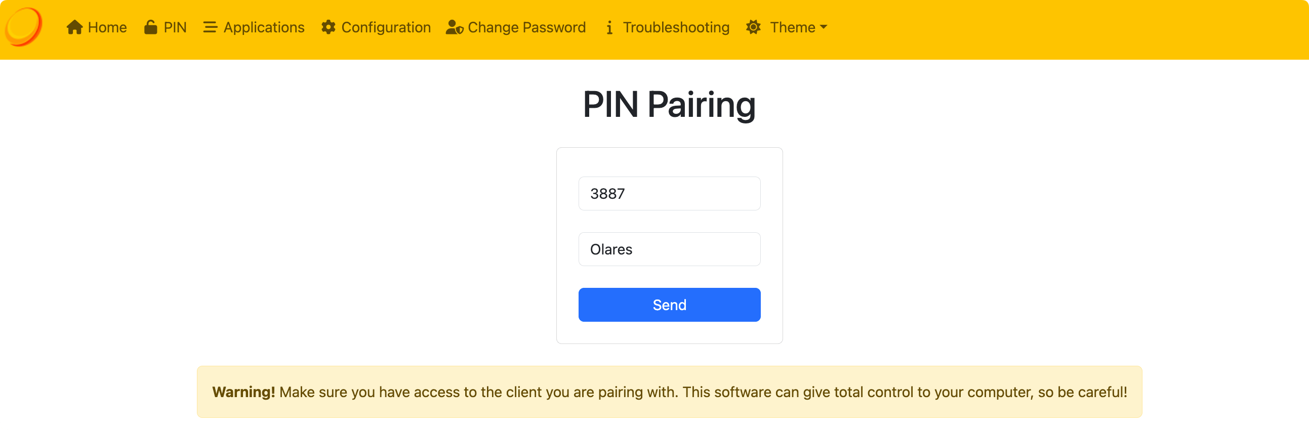

  1. Return to the Sunshine PIN page in your browser.
  2. Enter the PIN displayed in Moonlight and give your device a name. Enter pairing PIN

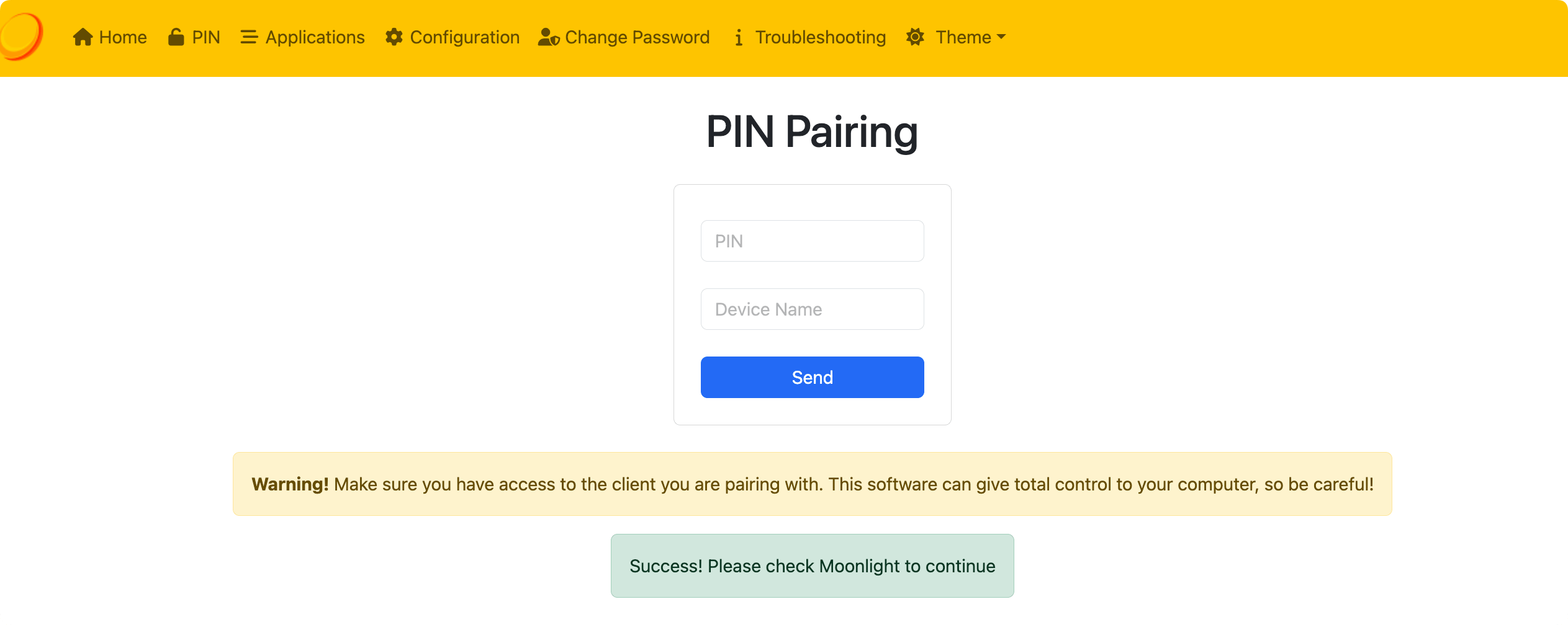

  3. Click Send. When pairing succeeds, you'll see:
    Success! Please check Moonlight to continue
    Pairing succeeds

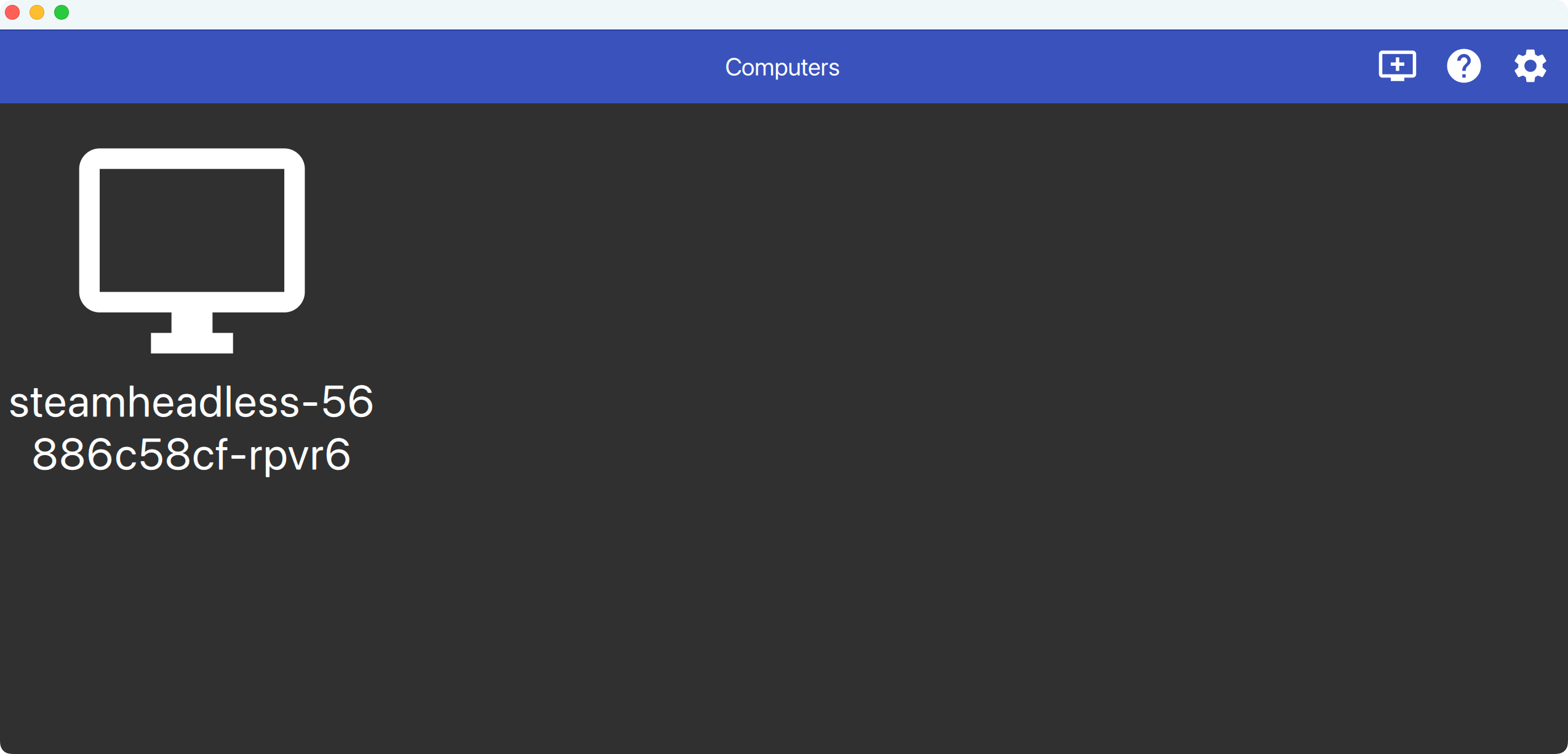

  4. Back in Moonlight, your host icon should now appear unlocked and active. Host in Moonlight

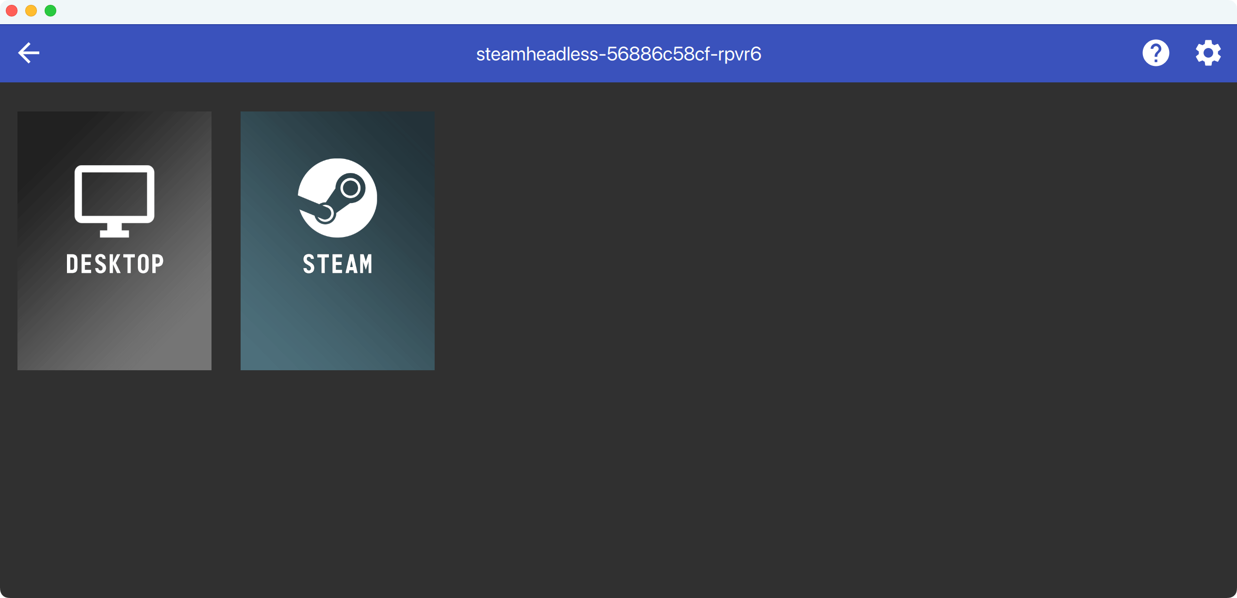

  2. Select your unlocked host and click the Steam icon.
    Steam in Moonlight
Steam now enters Big Picture mode and you can start playing your games.

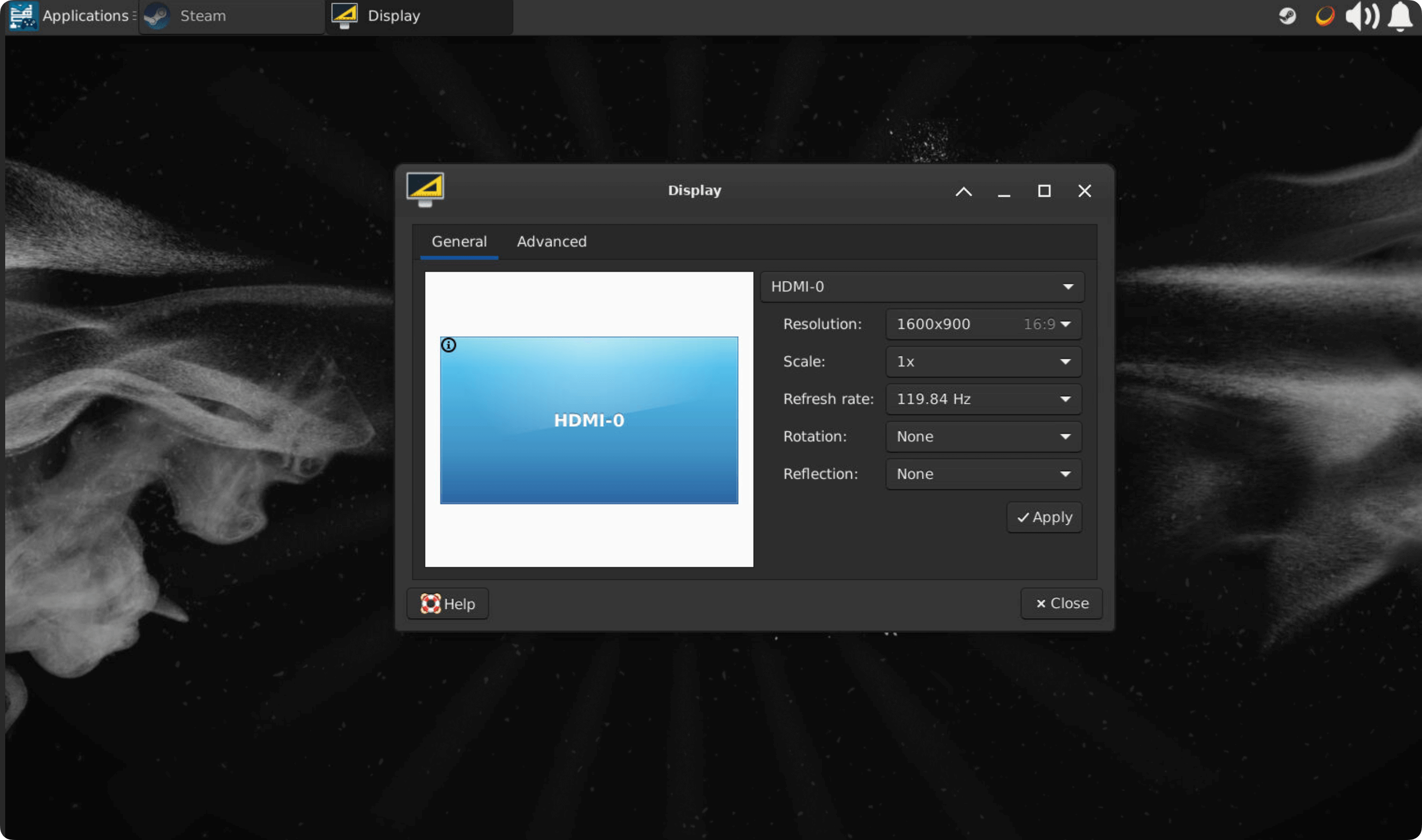

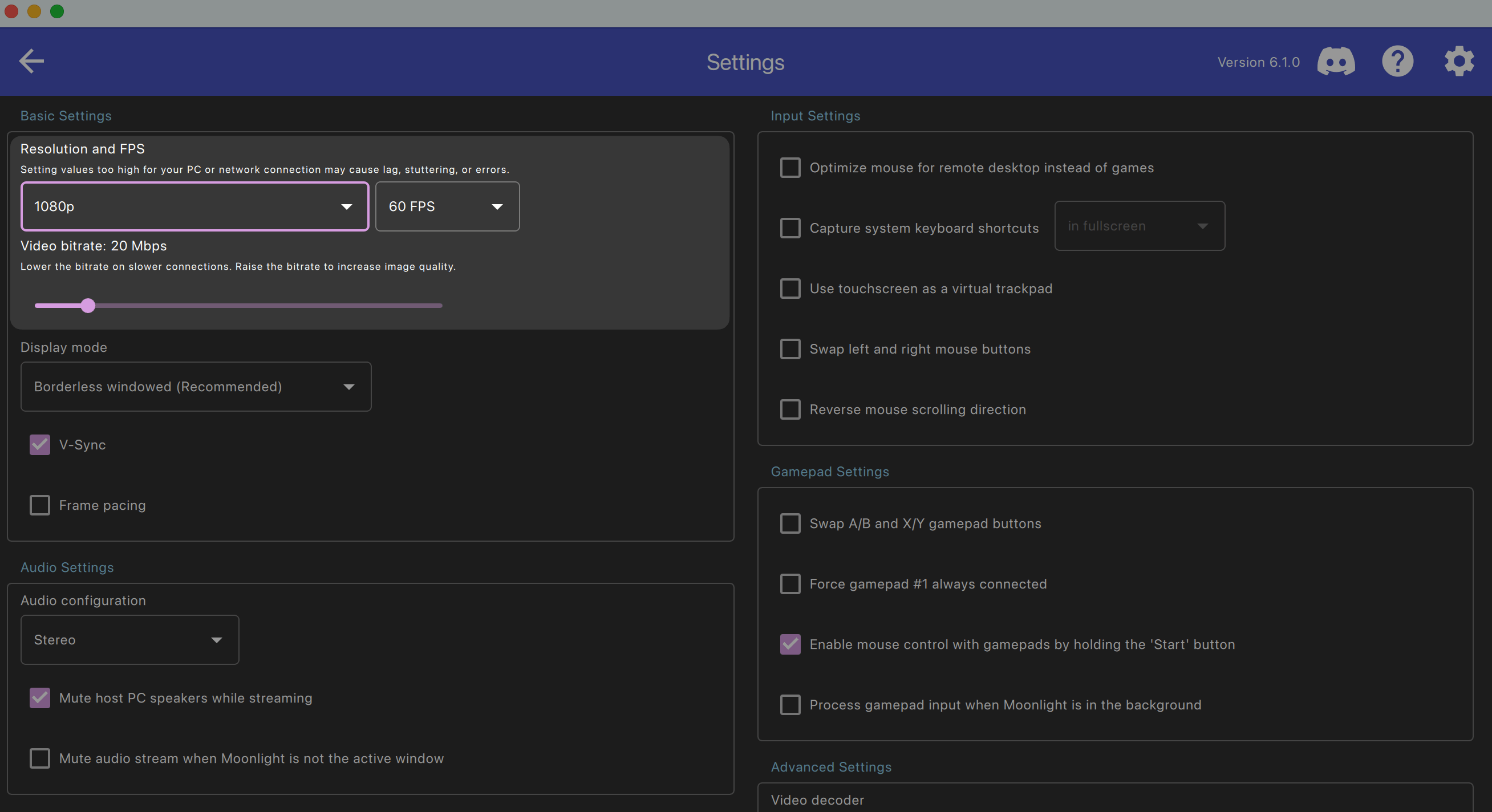

Why isn't the game displaying in full screen?
This may be caused by resolution settings. Try adjusting the resolution:
  • In Moonlight: Go to Settings > Basic Settings > Resolution and FPS. Display in Moonlight
  • On the Steam console page: Go to Applications > Settings > Display.
    Display in Steam Headless

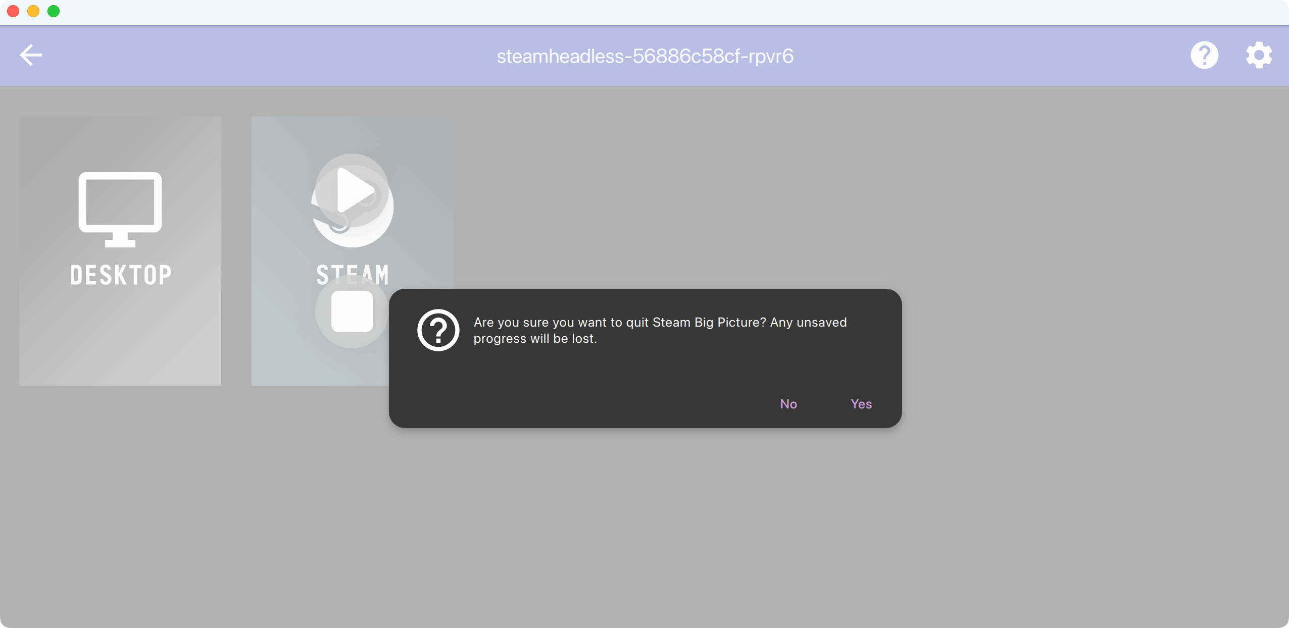

How do I exit full-screen streaming?
Use the following shortcuts:
  • Windows: Ctrl + Alt + Shift + Q
  • Mac: Control (^) + Option (⌥) + Shift + Q
  • Mobile: Start + Select + L1 + R1
After finishing, exit Steam Big Picture mode to release system resources on Olares. Exit Steam Big Picture Mode

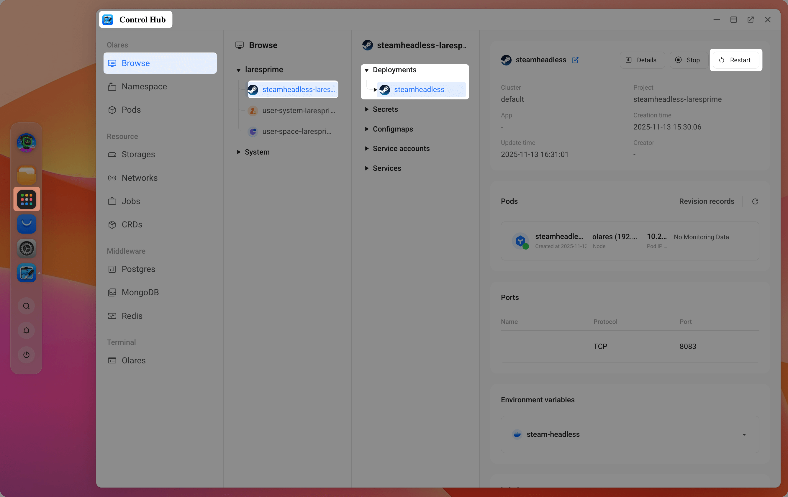

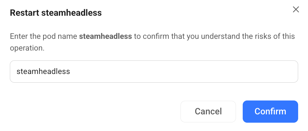

Why do I get an error when re-pairing the host in Moonlight?
If you delete your Olares host in Moonlight and try to pair again, you may encounter the following errors:
  • The PIN from the PC didn't match. Please try again.
  • Request timed out (Error 4)
  • Connection closed (Error 2)
This usually happens when the Sunshine service is not responding. To fix it, simply restart Steam Headless in Olares and try pairing again:
  2. Navigate to Browser > steamheadless > Deployments > steamheadless > Restart. Restart Steam Headless
  3. In the confirmation prompt, enter steamheadless and click Confirm. Confirm restart
  4. Once restarted, pair with Sunshine again in Moonlight.

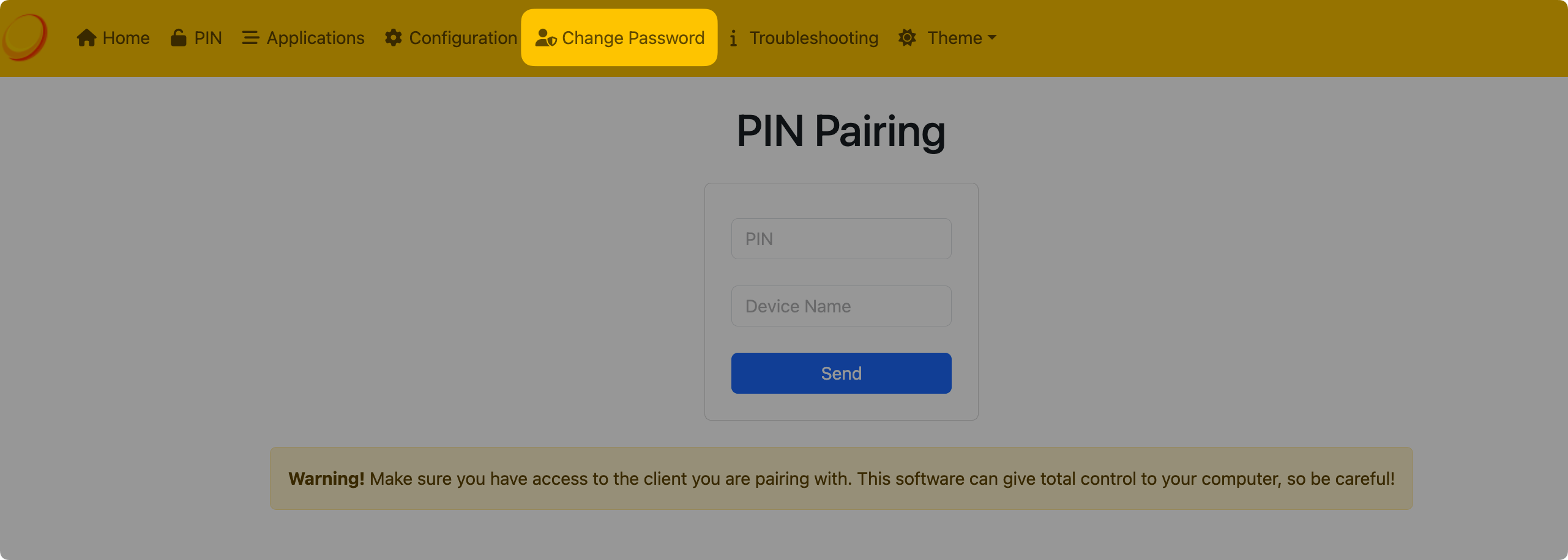

How do I change my Sunshine username or password?
You can change your Sunshine credentials directly from the Sunshine web console.
  1. Open Sunshine in your browser using your local address, for example: http://139ebc4f0.<your Olares ID>.olares.local:47990.
  2. Log in with your current username and password.
  3. Go to the Change Password tab. Change Sunshine password
  4. Enter a new password (and username if desired), then click Save.
