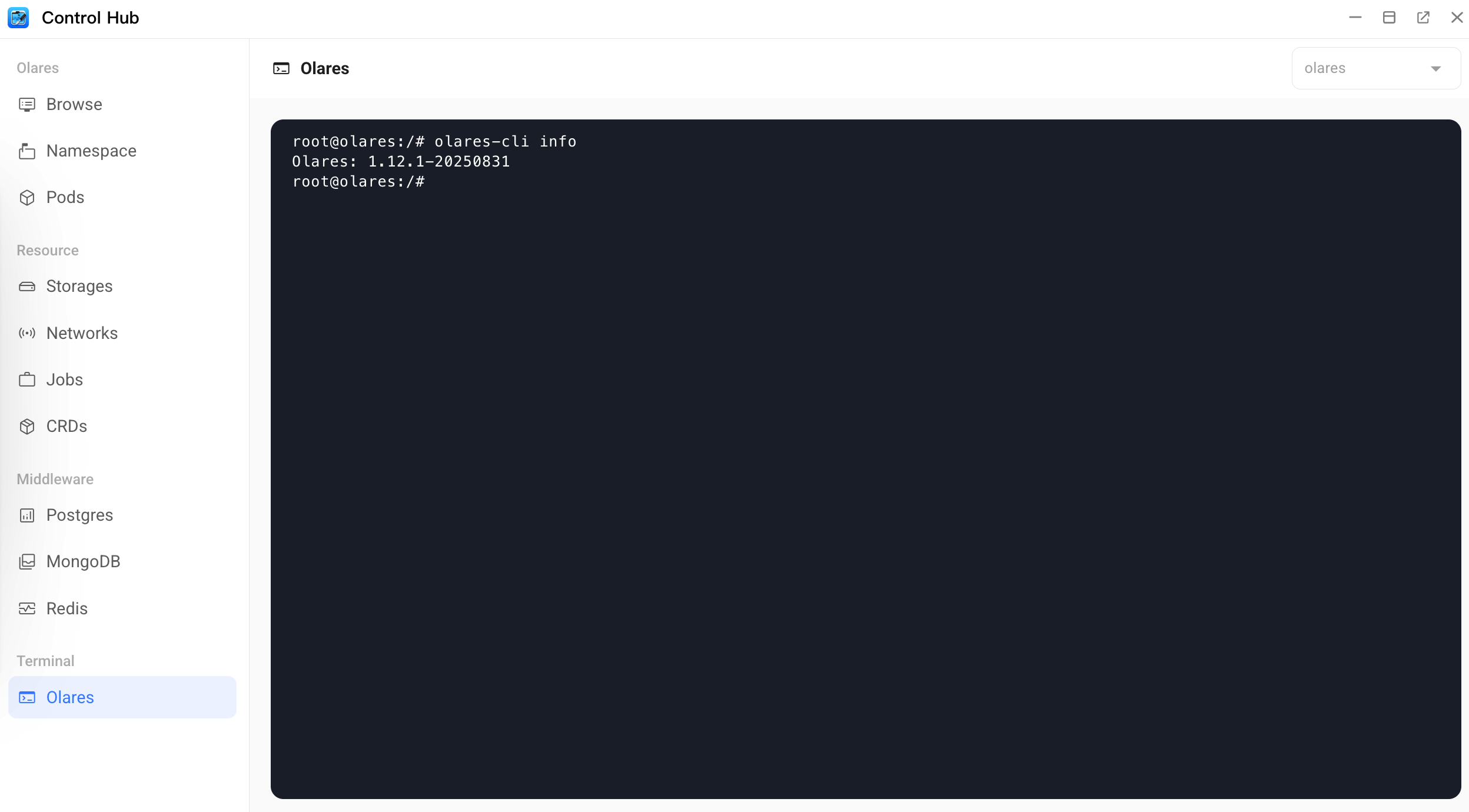

Method 1: Access via Control Hub
For quick access without configuring an SSH client, use the web-based terminal built into Control Hub.
  1. Open the Control Hub app.
  2. In the left sidebar, under the Terminal section, click Olares. Terminal
You can now execute system commands directly in the embedded terminal.
Run as root
The Control Hub terminal runs as root by default. You do not need to prefix commands with sudo.

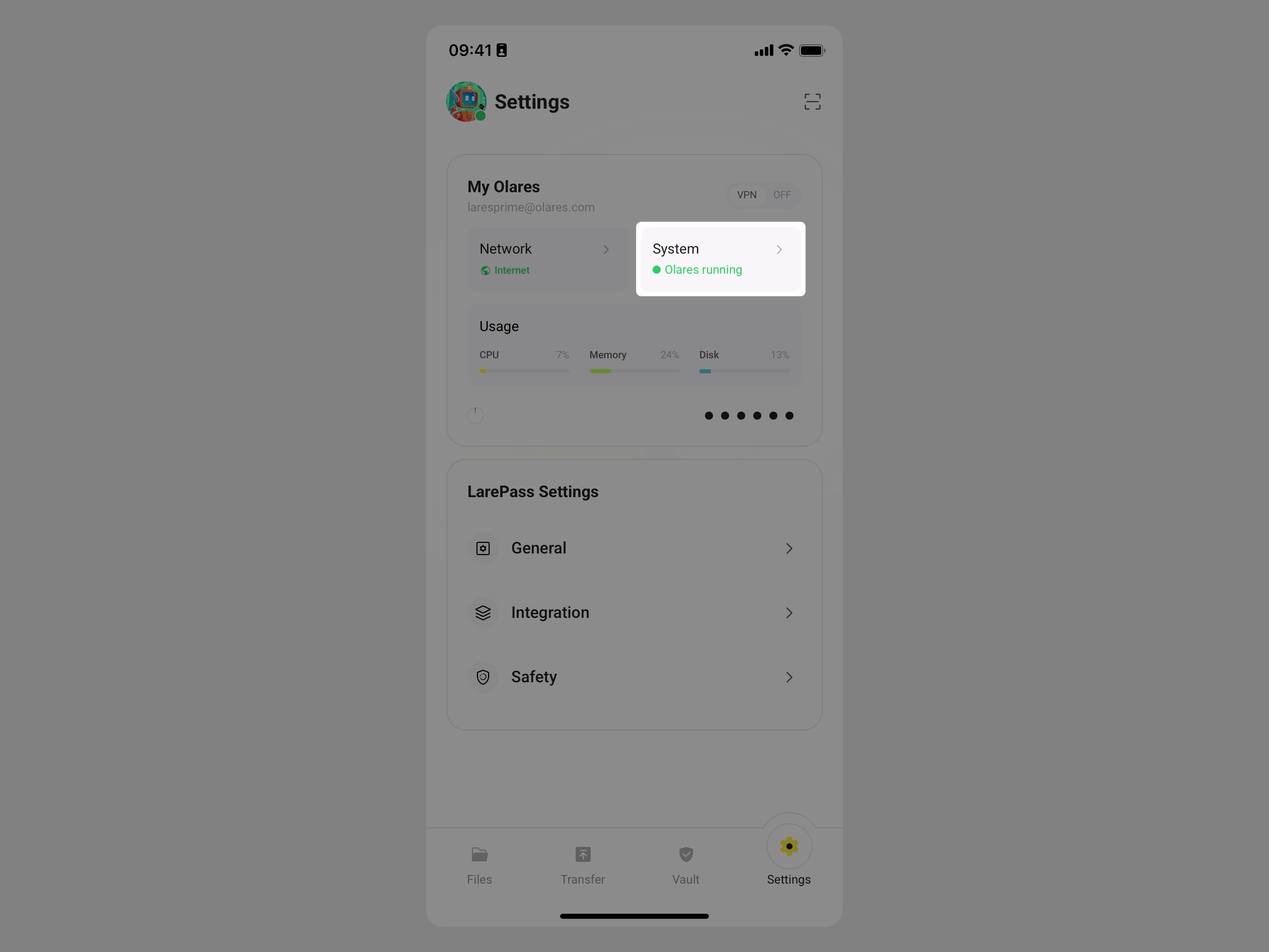

Step 1: Get the local IP address of Olares One
  1. Open the LarePass app, and go to Settings > System to navigate to the Olares management page. Tap the System card
  2. Tap the Olares One device card.
  3. Scroll down to the Network section and note the Intranet IP.

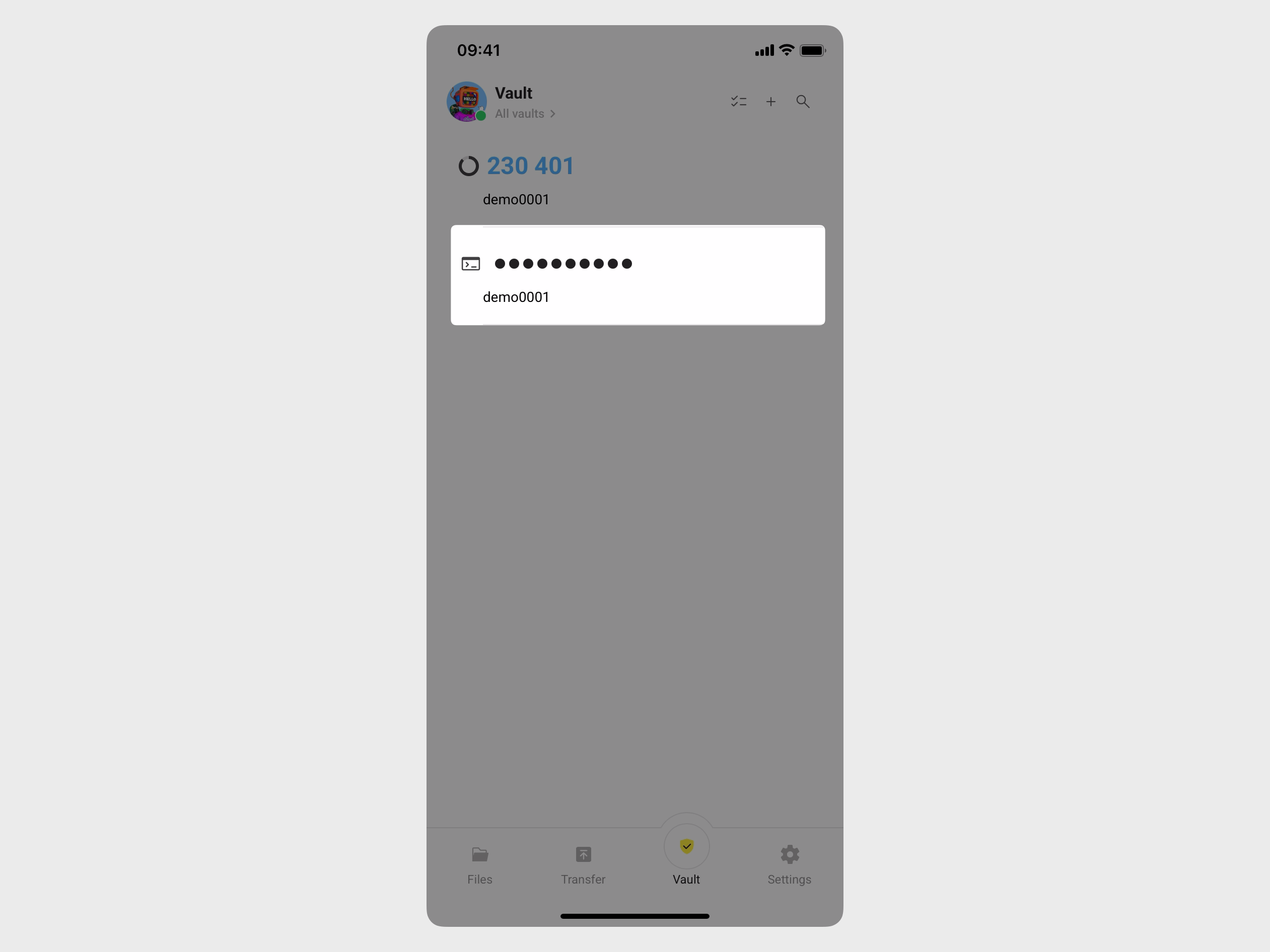

Step 2: Check SSH password in Vault
Right after you activate Olares, you will be prompted to reset the SSH password on the LarePass app. The password is automatically generated and saved to your Vault.
To view the saved password in Vault:
  1. Tap Vault in the LarePass app. When prompted, enter your local password to unlock.
  2. In the top-left corner, tap Authenticator to open the side navigation, then tap All vaults to display all saved items. Switch Vault filter
  3. Find the item with the terminal icon and tap it to reveal the password. Check saved SSH password in Vault

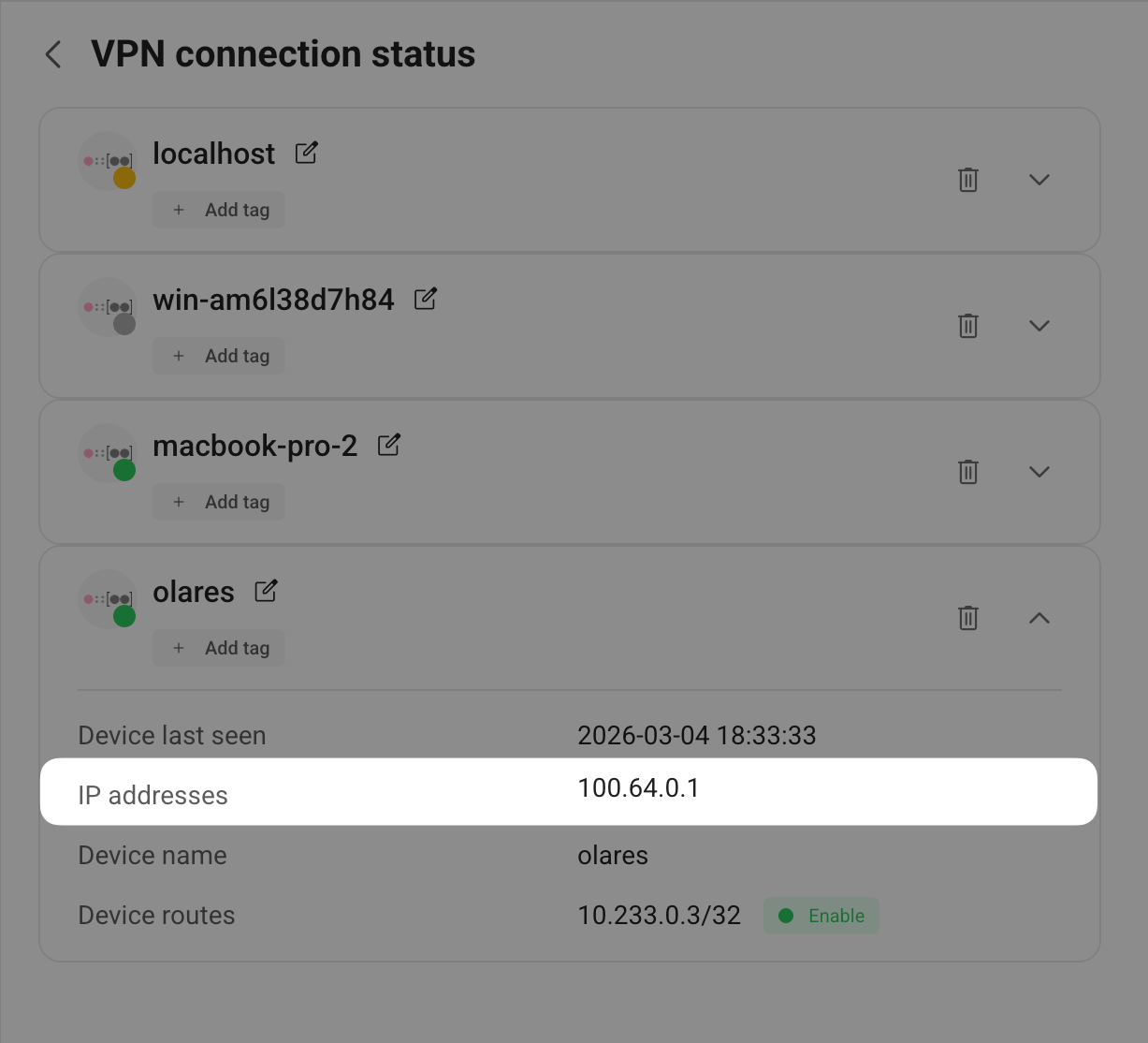

Step 1: Find the Tailscale IP of Olares One
  1. On Olares, go to Settings > VPN > View VPN connection status.
  2. Find olares, and click it to expand the connection details.
  3. Locate the IP address that starts with 100.64, and note it down. Enable LarePass VPN on desktop

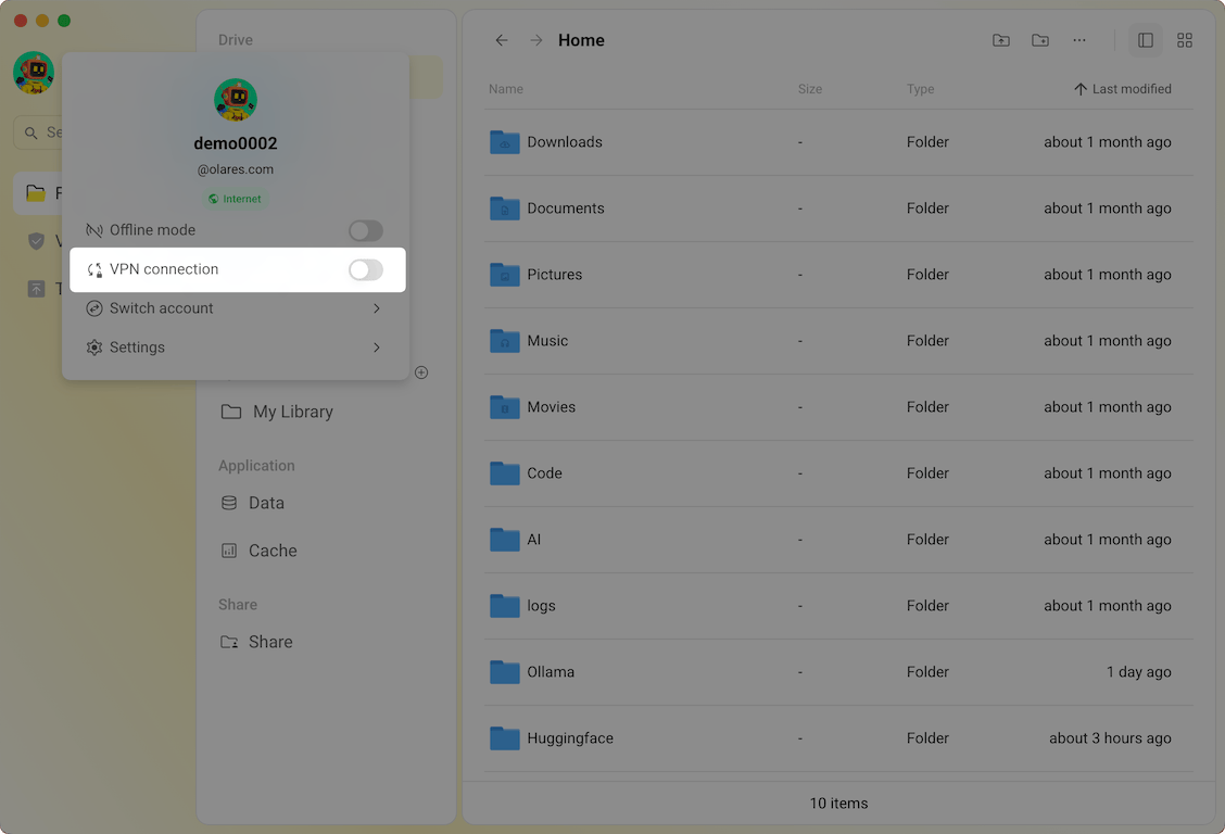

  3. On your computer, open the LarePass desktop client.
  4. Click your avatar in the top-left corner and toggle on VPN connection. Enable LarePass VPN on desktop

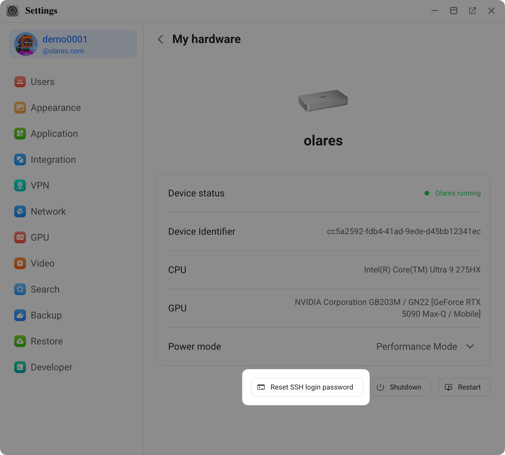

Reset SSH password
If you prefer to use an SSH password instead of the automatically generated one, you can manually reset the password in Settings.
  1. Open Settings. On the My Olares page, select My hardware.
  2. Select Reset SSH login password at the bottom. Reset SSH login password
  3. In the dialog, enter a new SSH password that meets all strength requirements, then click OK.
  4. Open the LarePass app and scan the QR code shown on the screen.
  5. Click Confirm on LarePass to finish. Your reset SSH password will be saved to Vault.
