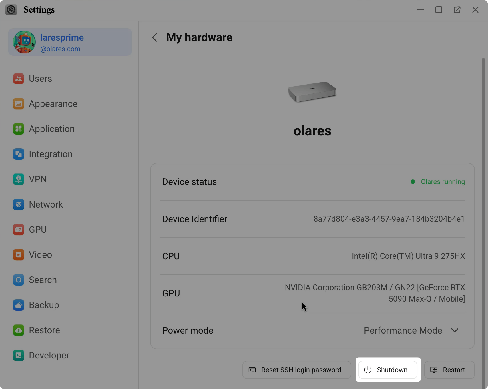

  1. Open Settings, and select My hardware > Shutdown. Shut down Olares One
  2. Scan the displayed QR code using the LarePass app. When the prompt appears in the app, tap Confirm to shut down Olares One.

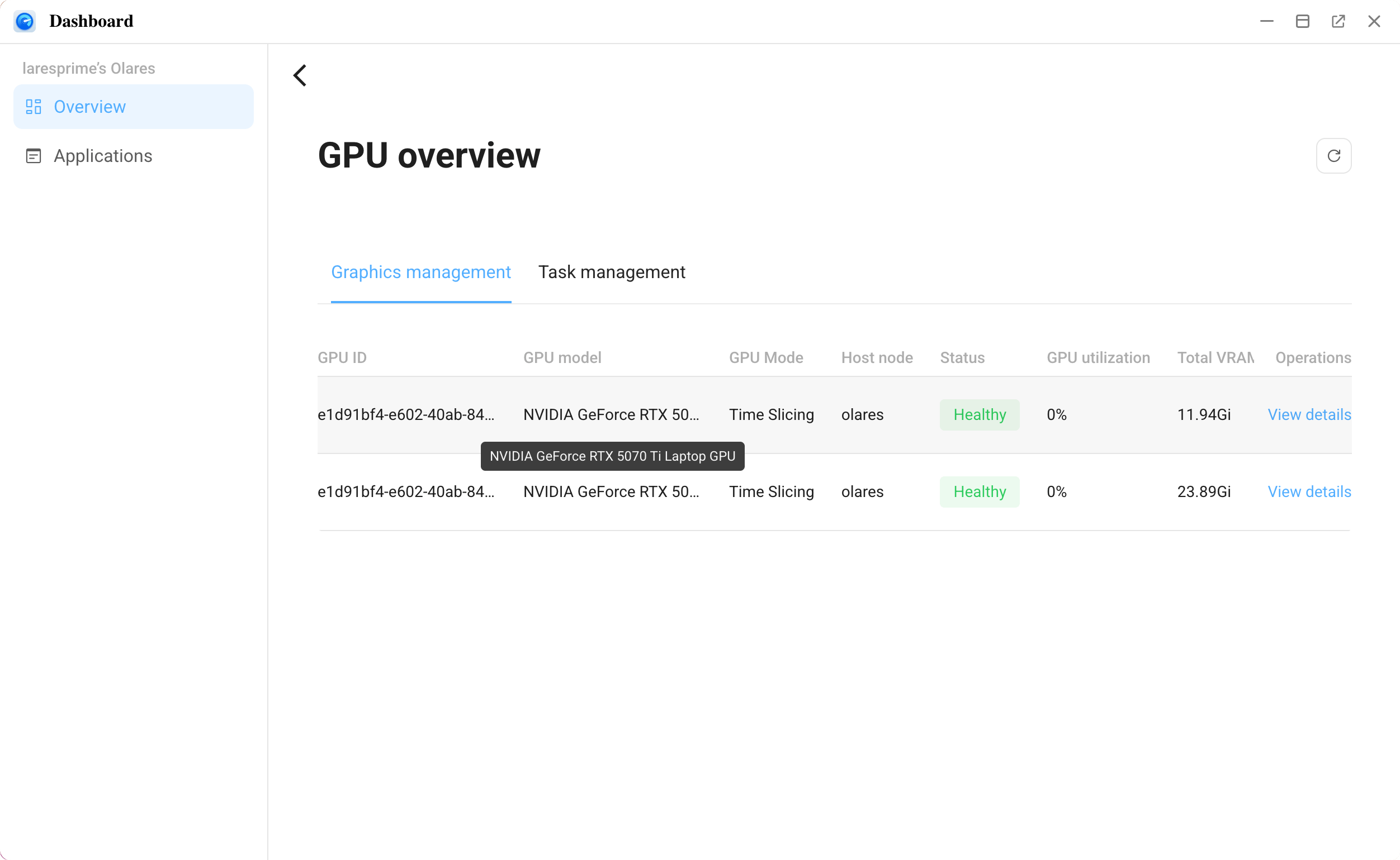

Step 2: Verify connection
To verify that the external graphics card is recognized:
  1. Log in to Olares, and open Dashboard.
  2. Select the GPU card. You should see your external card listed alongside the internal GPU. Verify eGPU connection
