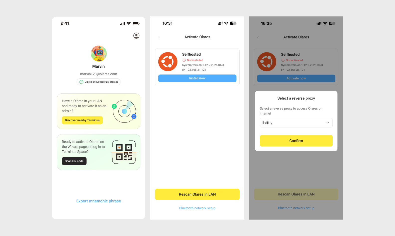

Finish installation and activate Olares
Same network required
  2. On your account activation page, tap Discover nearby Olares. LarePass will list the detected Olares instances in the same network.
  3. Select the target Olares instance from the list and tap Install now.
    ISO Activate
    ISO Activate-2

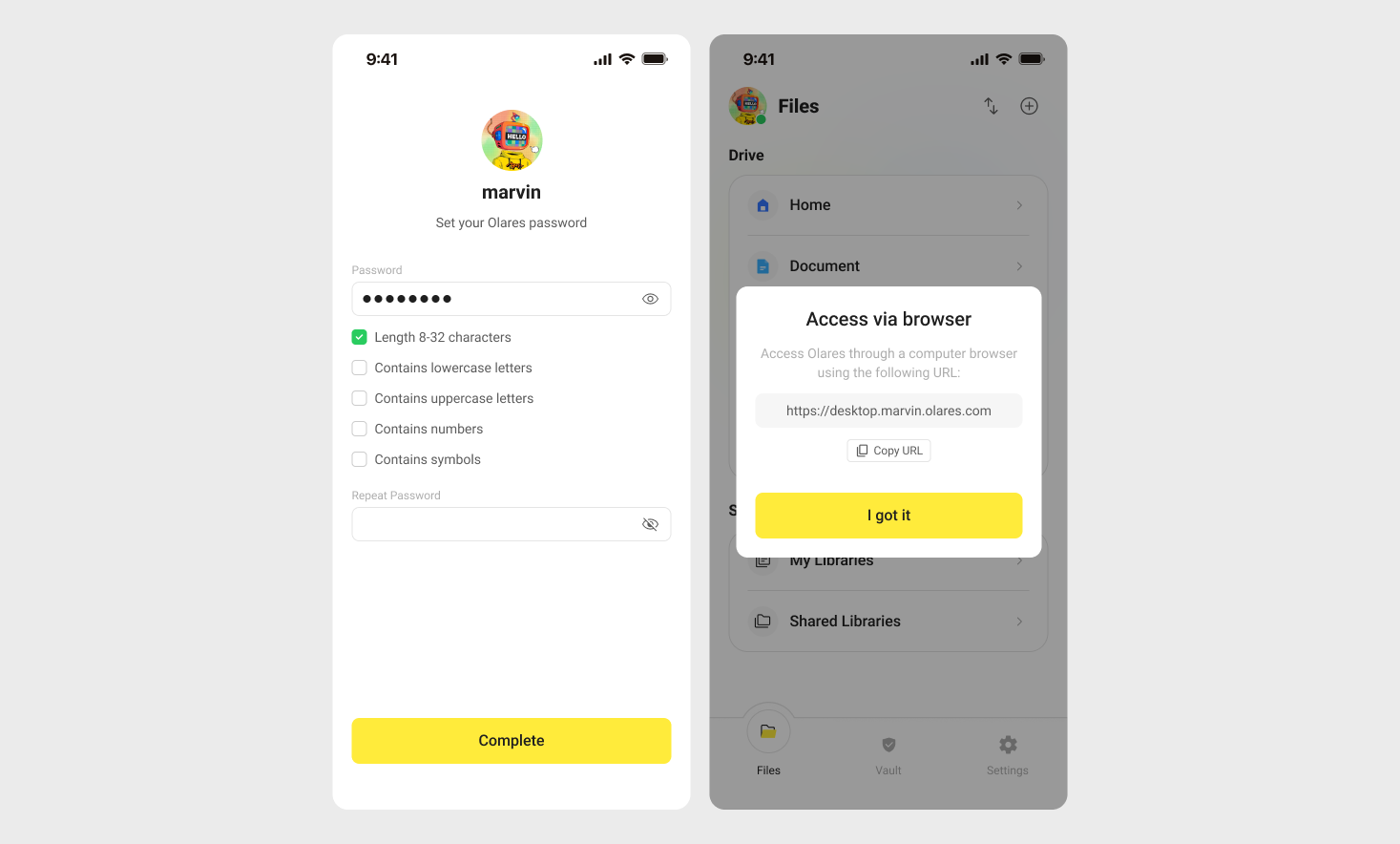

Log in to Olares
    Log in
    Confirm login
