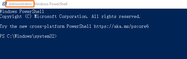

How to make sure I am using PowerShell as administrator?
You can confirm that PowerShell is running as an administrator if you see "Administrator: Windows PowerShell" in the title bar of the PowerShell window.
Confirm run Powershell as administrator

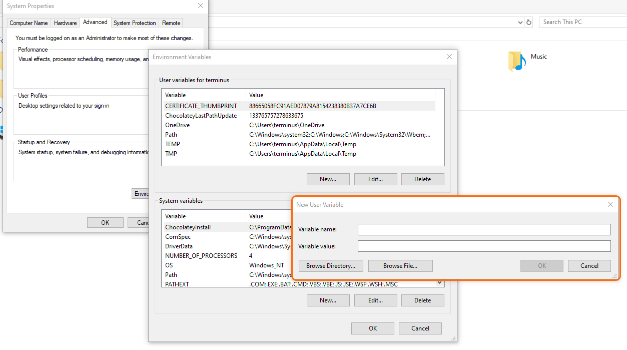

  1. Add a user variable with the following:
    • Variable name: WSL_MEMORY
    • Variable value: 16
    Add user variable

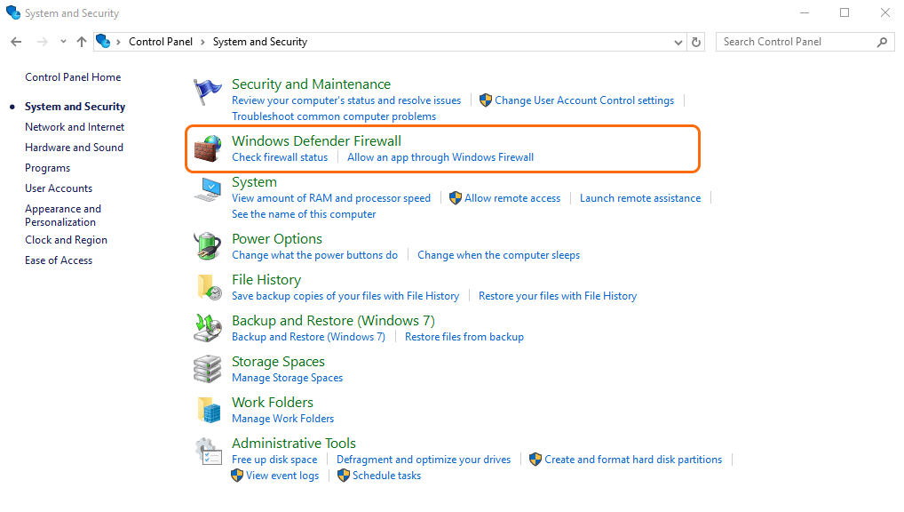

  1. Open Control Panel > System and Security > Windows Defender Firewall.

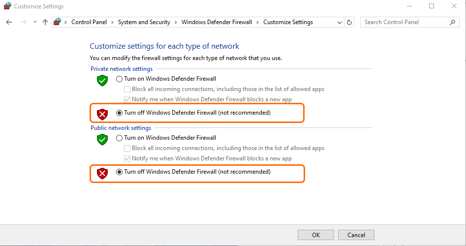

  2. In the navigation pane, click Turn Windows Defender Firewall on or off.
  3. Select Turn off Windows Defender Firewall for both private and public networks, then click OK.

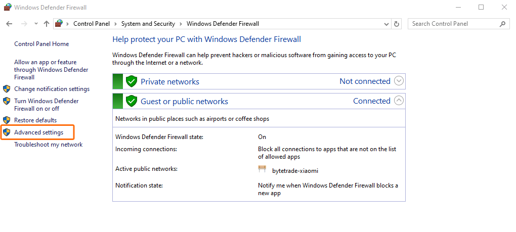

    Navigate to Windows Defender Firewall
  2. In the navigation pane, select Advanced settings.
    Select Advanced settings

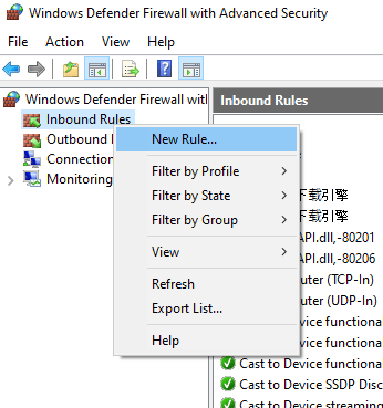

  3. In the navigation pane, right-click Inbound Rules and select New Rule.
    Add new rule

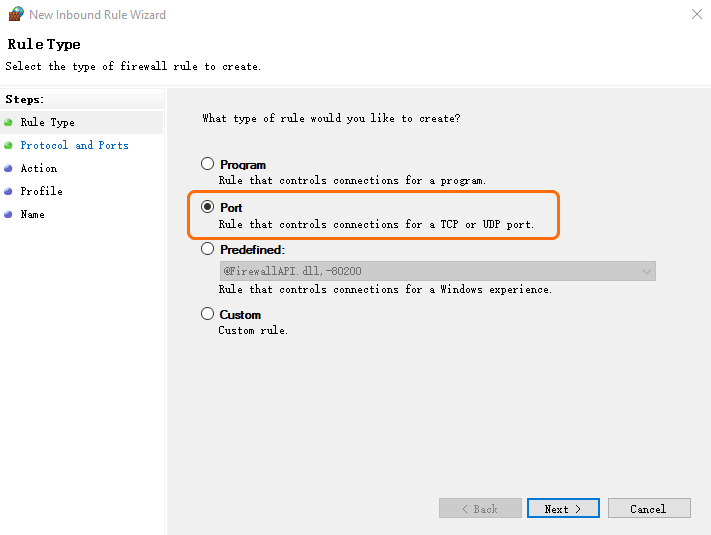

  4. In the New Inbound Rule Wizard, select Port and click Next.
    Select Port

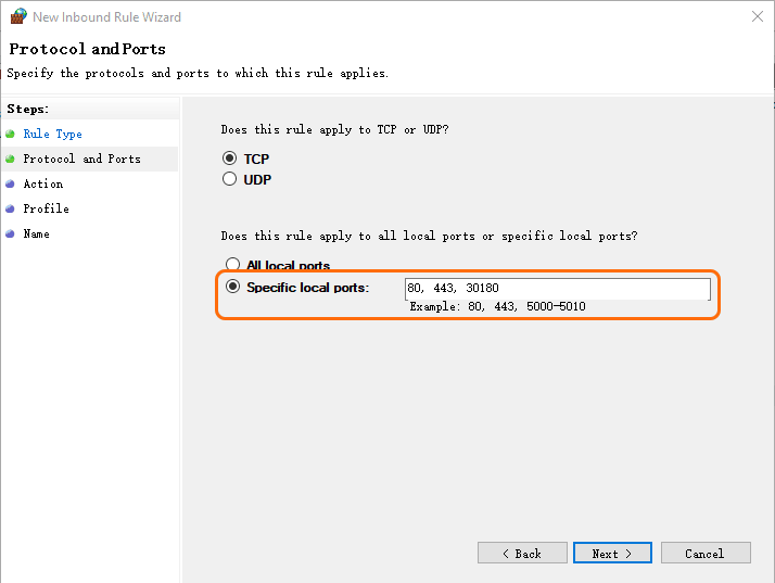

  5. In Specific local ports, enter 80, 443, 30180, and click Next.
    Specify Port

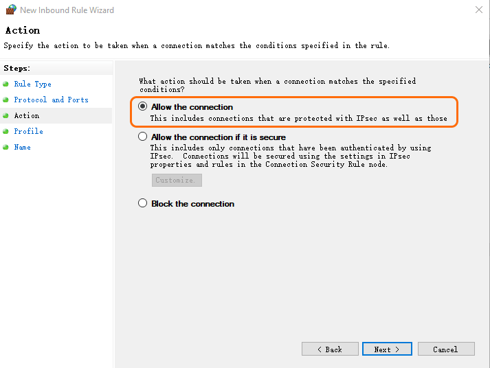

  6. Select Allow the connection and click Next.

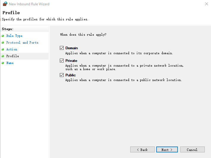

  1. Confirm the rules apply to Domain, Private, and Public, then click Next.
    Confirm rules

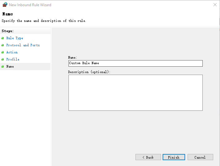

  2. Provide a name for the rule and click Finish.
    Name the rule
