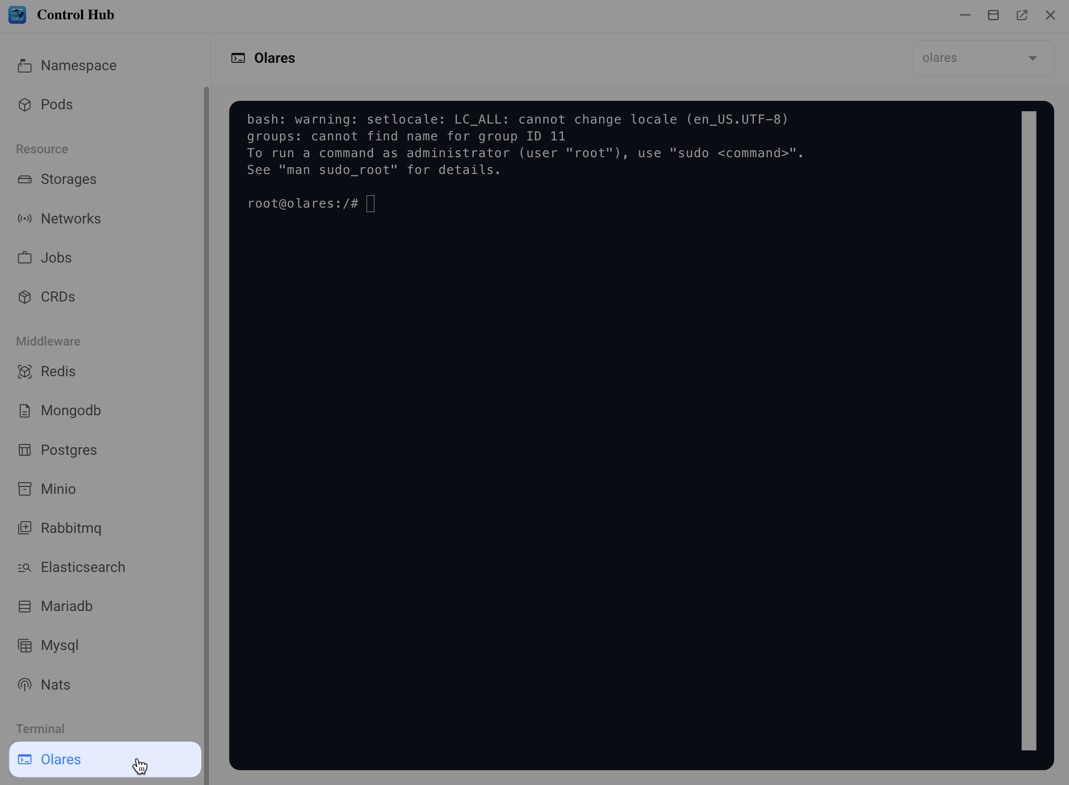

If you can still access the Olares desktop, open Control Hub and use its built-in terminal.
  1. Open a browser and access your Olares Desktop:
    https://desktop.<username>.olares.com
  2. Open Control Hub.
  3. In the left sidebar, under the Terminal section, click Olares. Open terminal
If you can access the terminal successfully, skip to Step 4.

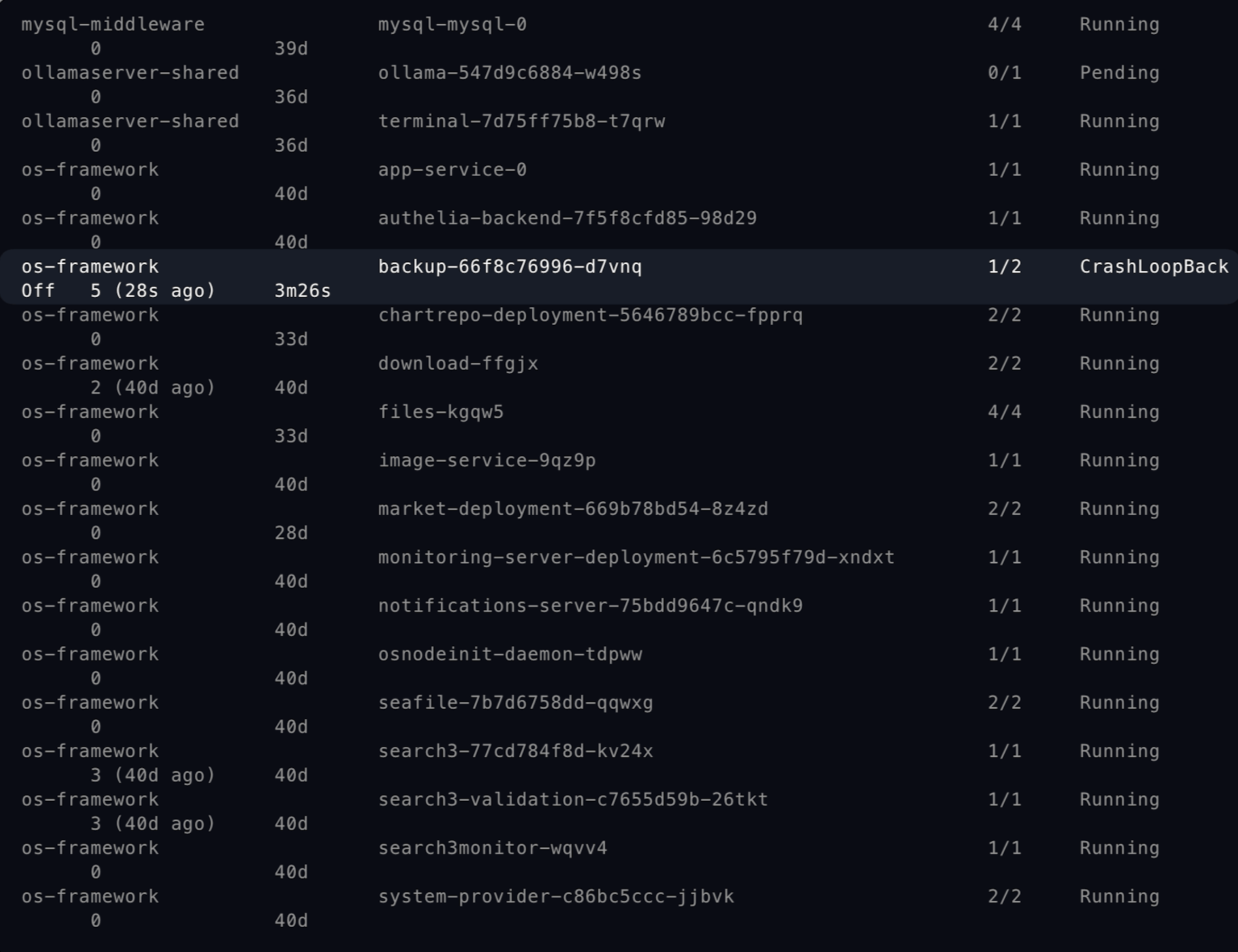

  1. Run the following command to get the status of all pods across all namespaces:
    kubectl get pods -A
  2. Check the STATUS column for any pods that are not in the Running state.
  3. Note the NAMESPACE and NAME of each problematic pod. Locate problematic pod

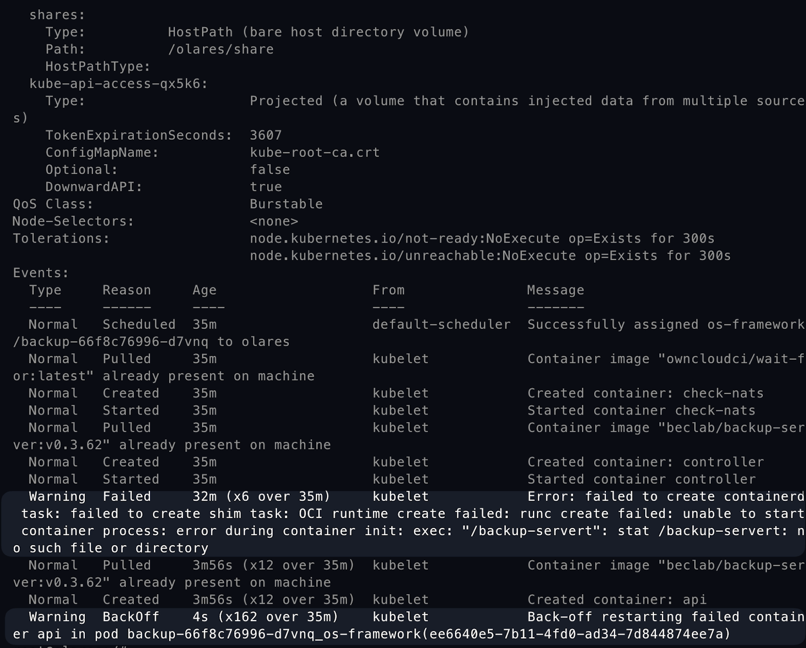

Step 5: Inspect the pod error
  1. Run the following command, replacing <namespace> and <pod-name> with the values you noted in the previous step:
    kubectl describe pod <pod-name> -n <namespace>
    For example:
    kubectl describe pod backup-66f8c76996-d7vnq -n os-framework
  2. Scroll down to the Events section to find the detailed error message. Pod event details
