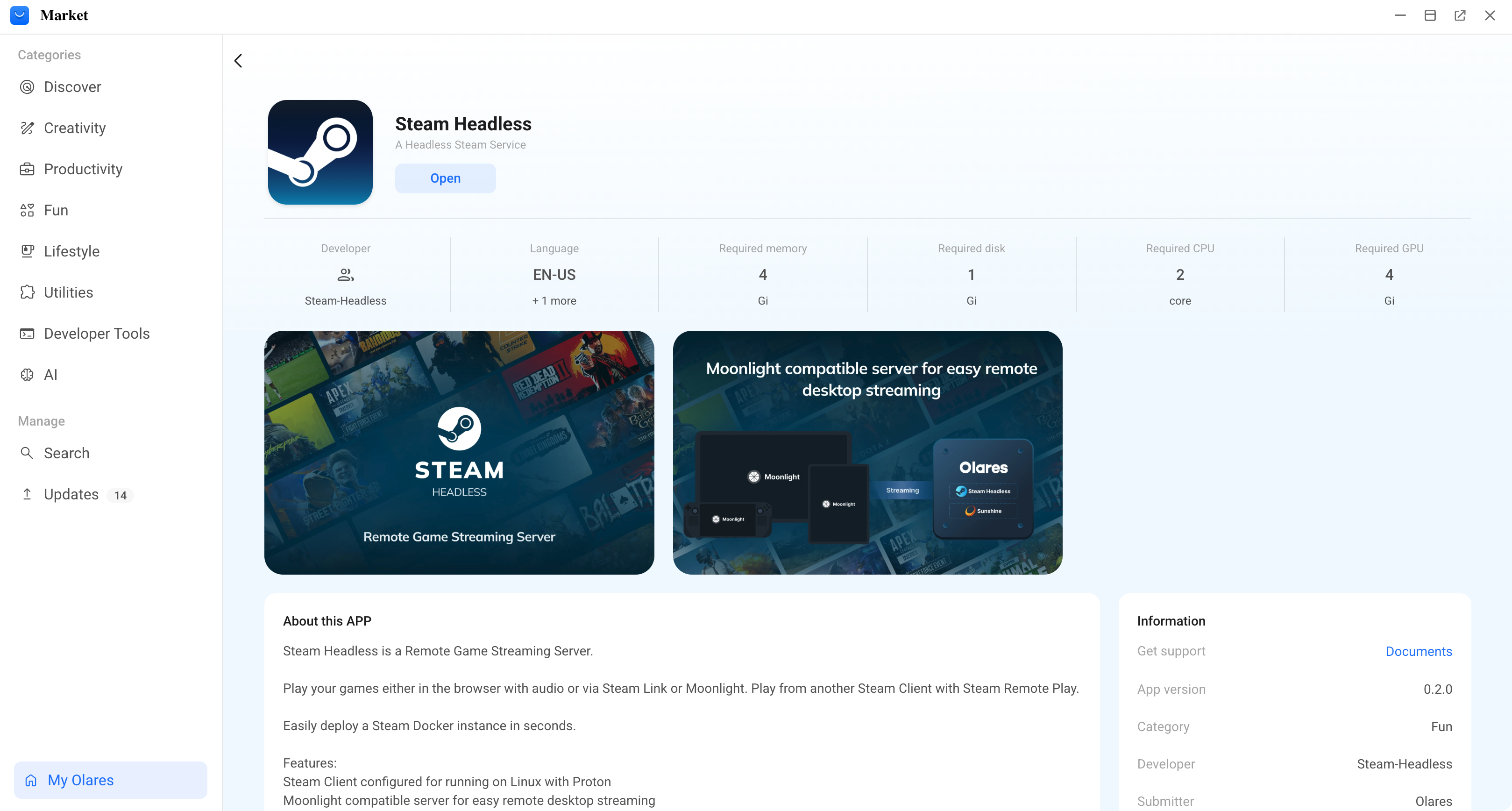

  1. Open the Market, and search for "Steam".
  2. Click Get, then Install. Install Steam Headless

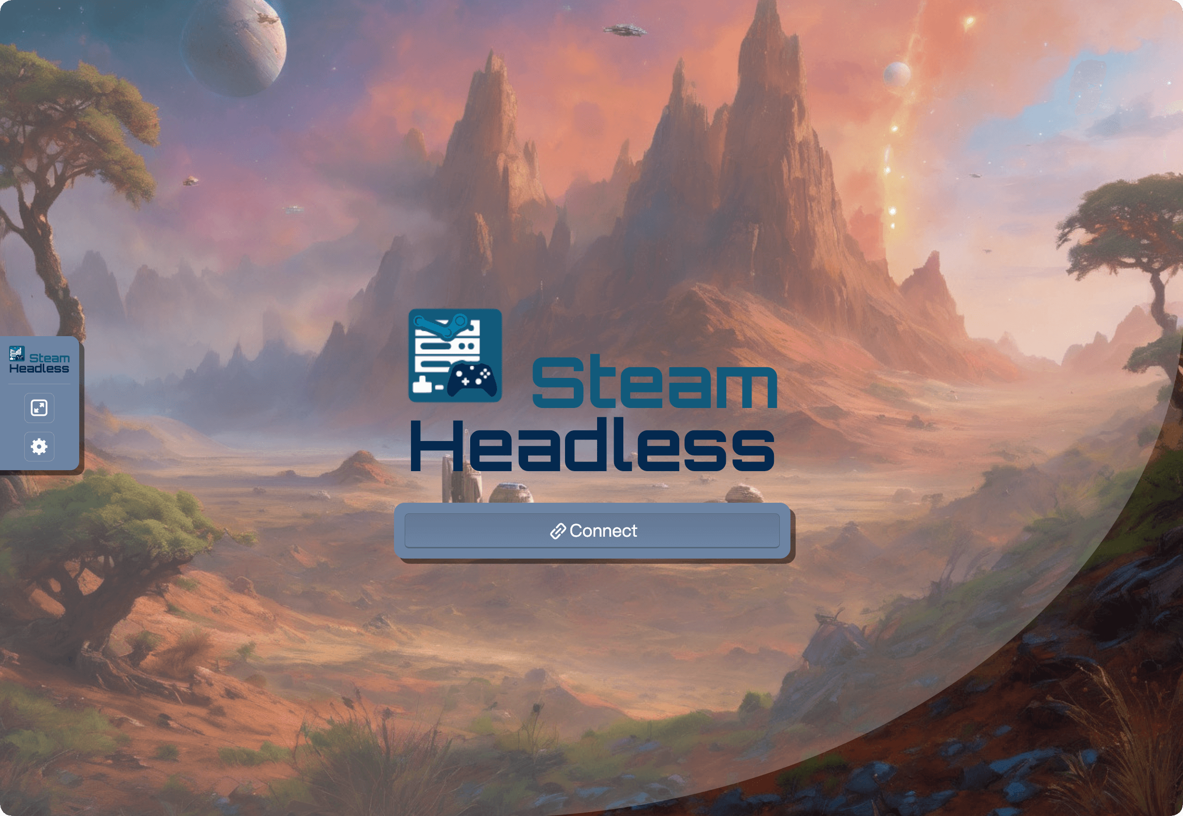

  1. Open Steam Headless and click Connect. Connect to Steam
  2. The Steam client will automatically begin downloading and installing. Install SteamUpdate Steam

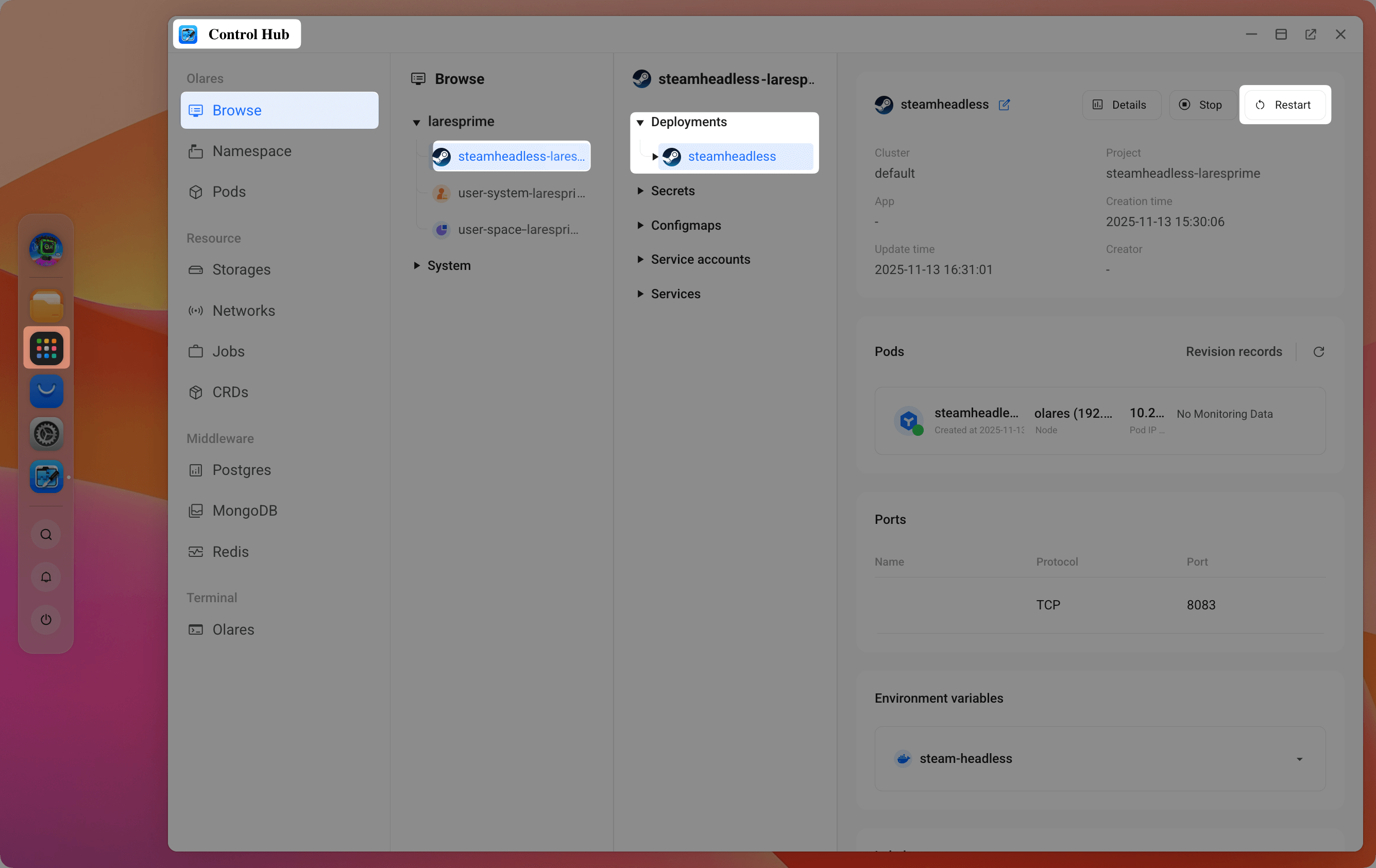

This usually happens when the Sunshine service is not responding. To fix it, simply restart Steam Headless in Olares and try pairing again:
  2. Navigate to Browser > steamheadless > Deployments > steamheadless > Restart. Restart Steam Headless

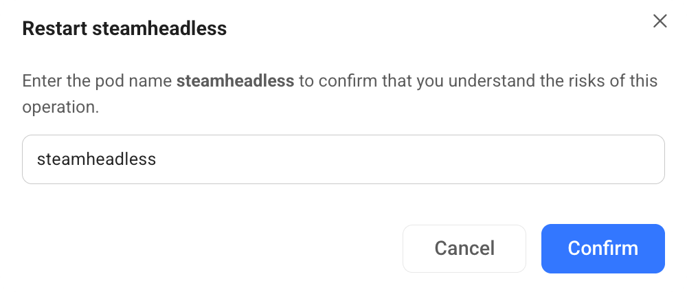

  3. In the confirmation prompt, enter steamheadless and click Confirm. Confirm restart
  4. Once restarted, pair with Sunshine again in Moonlight.
