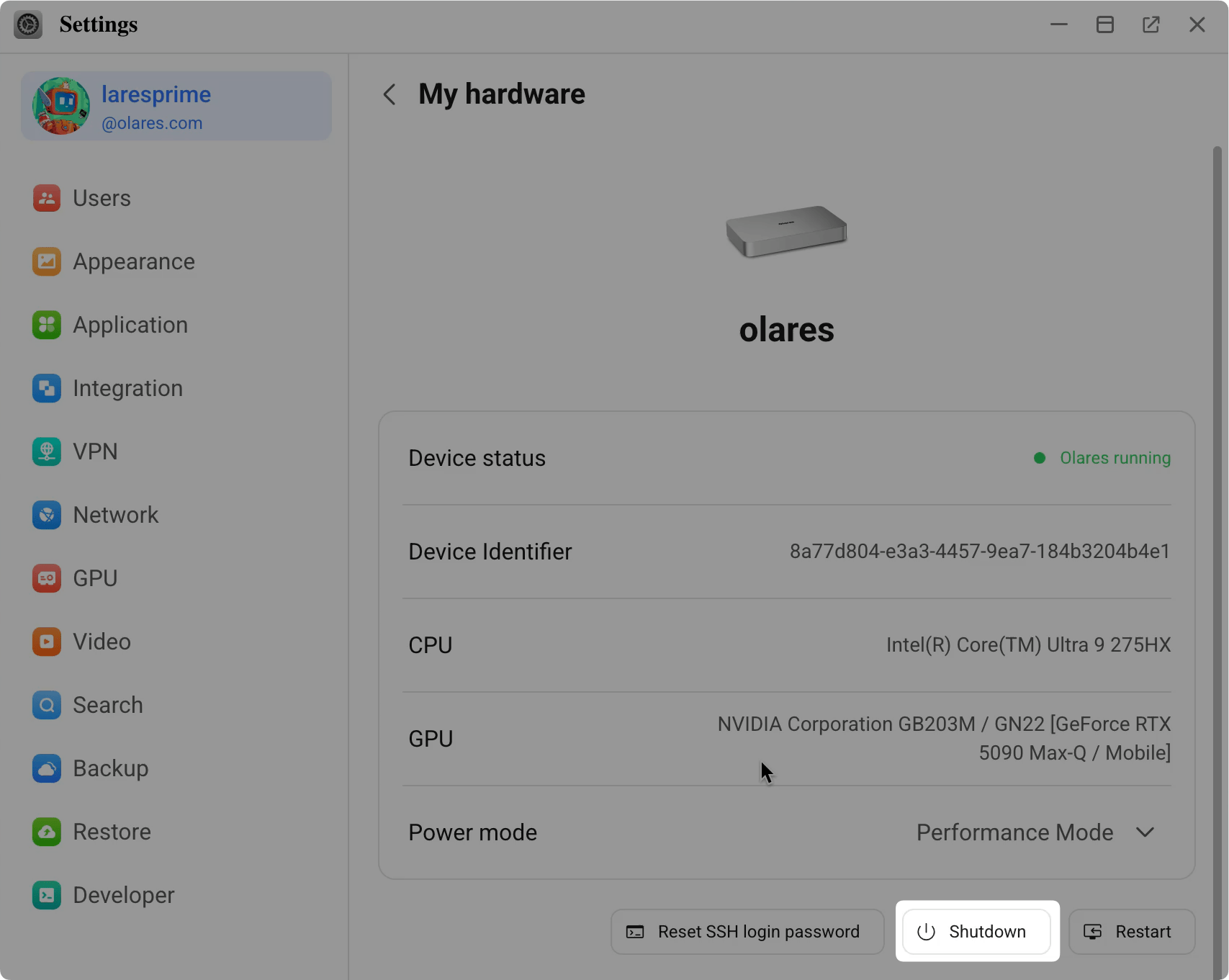

Open Settings, and select My hardware > Shutdown.
Scan the displayed QR code using the LarePass app. When the prompt appears in the app, tap Confirm to shut down Olares One.

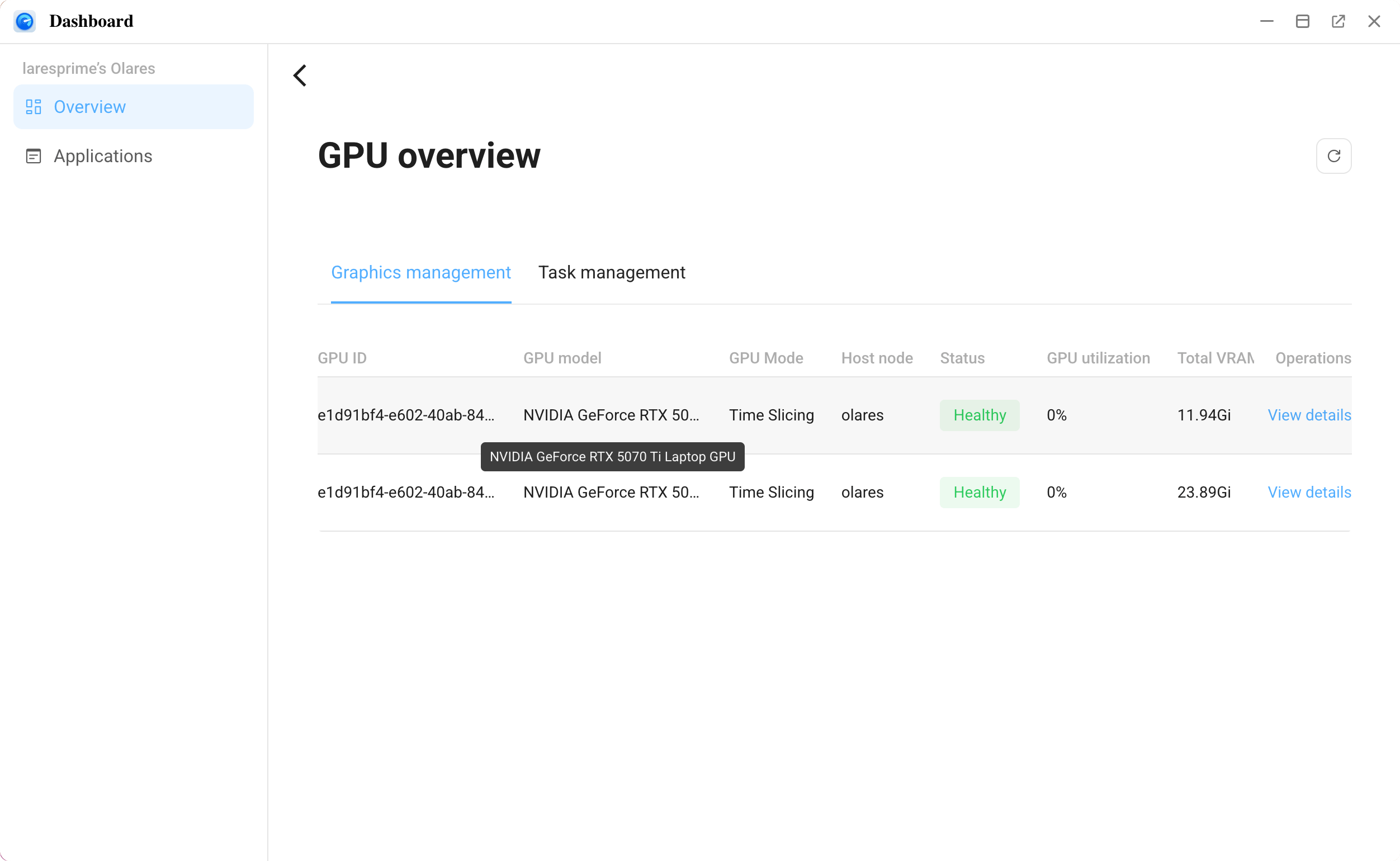

- Log in to Olares, and open Dashboard.
- Select the GPU card. You should see your external card listed alongside the internal GPU.
